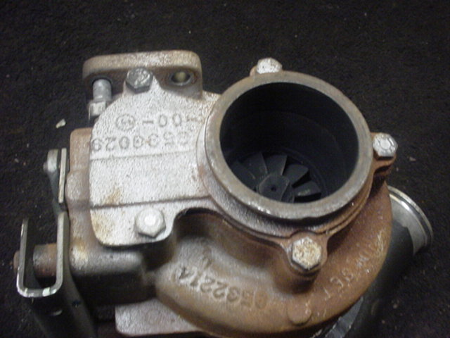

OM605 W202 C-Klasse - MartinB - 01-23-2010 Hi everyone, I have W202 C-klasse´98 250TD with OM605 (150hp), 290 000km, in good condition. I want to increase engine power on about +-250hp, max 300hp with low or no smoke. What I have to do for it (turbo,...)? I like HX35, but I am afraid of spool in 2000-3500rpm. I am daily driver. Thank you for any info and sorry for my english ![]() RE: OM605 W202 C-Klasse - winmutt - 01-26-2010 Search is your friend: http://www.superturbodiesel.com/std/om605-dyno-t-899.html http://www.superturbodiesel.com/std/om606-tuning-t-990.html http://www.superturbodiesel.com/std/compound-om605-and-others-t-889.html http://www.superturbodiesel.com/std/om605-superturbo-t-708.html RE: OM605 W202 C-Klasse - ForcedInduction - 01-26-2010 (01-23-2010, 05:14 PM)MartinB What I have to do for it (turbo,...)? I like HX35, but I am afraid of spool in 2000-3500rpm. I am daily driver. You should look for an HY35 or an HE341 instead. Smaller turbine housing will spool up much quicker. HX35 HY35/HE341/HE351 RE: OM605 W202 C-Klasse - MartinB - 01-27-2010 Thank you very much! How much power (approximately) will have OM605 with HY35?...and will i have to modify my original electrical pump? I don´t want to see lot of smoke from my exhaust.. ![]() RE: OM605 W202 C-Klasse - ForcedInduction - 01-27-2010 250hp shouldn't be difficult with that turbo, plus a bunch of supporting parts (pump, intercooler, manifolds, etc). RE: OM605 W202 C-Klasse - MartinB - 01-27-2010 Will i have to change the elements in pump for bigger? RE: OM605 W202 C-Klasse - ForcedInduction - 01-27-2010 Yes. You won't get more than 175hp worth of fuel without upgrading them. RE: OM605 W202 C-Klasse - MartinB - 01-27-2010 Ok, my pump have 5,5 mm elements or 6,0 mm? I saw on this website, that the original "OM606 turbo" have 6,0 mm. So I need 6,5 mm elements? I really Thank you! RE: OM605 W202 C-Klasse - ForcedInduction - 01-27-2010 Follow the links winmutt gave you yesterday. RE: OM605 W202 C-Klasse - tomnik - 01-28-2010 (01-27-2010, 04:19 PM)MartinB Ok, my pump have 5,5 mm elements or 6,0 mm? I saw on this website, that the original "OM606 turbo" have 6,0 mm. So I need 6,5 mm elements? I really Thank you! Hi Martin, where are you located in CZ? 6.5mm M does not exist. The 605 is a preferred engine in G-Mercedes and (mild) mods have been done by a specialist I know. The Holsets are difficult to find, easier to find is a Garrett 22 or 25 which should be sufficient in combination with pump and intercooler for a daily driver. Does your engine have the 5 cyl turbo inline IP (M)? Tom (Germany) RE: OM605 W202 C-Klasse - jeemu - 01-28-2010 Garrett GT32 works fine at 300hp RE: OM605 W202 C-Klasse - MartinB - 01-28-2010 My Mercedes is completely original. IP is electronical and unfortunately I don´t know more info about it, because on these days is Mercedes in the paintshop. I live nearly by Prague. RE: OM605 W202 C-Klasse - tomnik - 01-28-2010 (01-28-2010, 01:11 PM)MartinB I live nearly by Prague. From time to time I am in Kolin. RE: OM605 W202 C-Klasse - MartinB - 01-28-2010 This is a good joke.. I live in Cesky Brod, it is 25 km from Kolin ![]() RE: OM605 W202 C-Klasse - tomnik - 01-29-2010 (01-28-2010, 06:38 PM)MartinB This is a good joke.. I live in Cesky Brod, it is 25 km from Kolin I can order beer, say Thank You, Hello and Good Bye nearly accent free but that's it. I am responsible for one of our company's customer in Velim. It's funny but I will be in Velim for a meeting next Thursday but together with my boss ;( but usually I travel alone and can have my beer where I want. Is your IP a 5 cyl inline, like the ones of the 201 2.5 turbodiesel? Do you have the IP# or photo? Tom RE: OM605 W202 C-Klasse - MartinB - 01-29-2010 Really funny ![]() I do think..it is the same like this http://www.w124performance.com/images/OM606_injection/606.962_pump01.jpg but only without one cyl. RE: OM605 W202 C-Klasse - MartinB - 02-03-2010 After a few days searching on internet..I found 2 ideal turbocharger for 250-300hp on OM605. 1. T04E Super 50 http://mystik4l.rajce.idnes.cz/OM605/#Graph2.jpg 2. KKK RS2-2672 http://mystik4l.rajce.idnes.cz/OM605/#Graph1.jpg |
