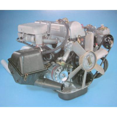

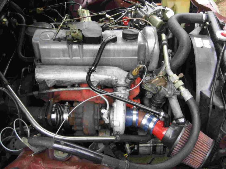

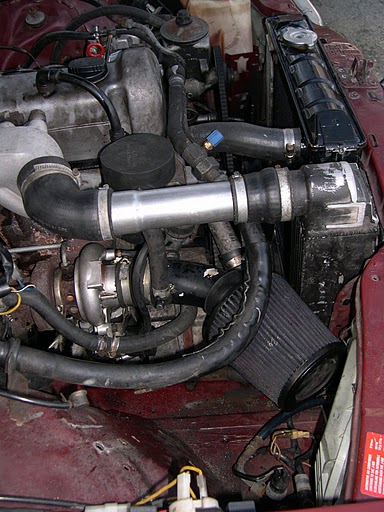

Can anyone help me out with the 2.4l STT turbo set-up from the early 70's? - btrapr - 01-26-2010 I know where one running 240 automatic car is...as well a 3 cylinder 240 manual car are an can probably pick them both up for around $600-700! The 3 cylinder is because one rod is sticking out of the block and it still runs! The old addage about these things are hard to kill ![]() I am really intrigued with the thought of putting together a 90-100hp 4 banger with a manaul transmission! One guy said he has gotten as high as 37MPG_______As I commute around 85 miels a day, and miles add up quickly_________ I found these pics (MIDDLE picture is a different car) on the web of a couple of projects and one mentioned a SST turbo kit that was available in the early 70's for the om616... one ugy is running about 6.5lbs and the other tops out around 9lbs ANY INFORMATION HOW TO PULL THIS OFF WOULD BE GREATLY APPRECIATED. RE: Can anyone help me out with the 2.4l STT turbo set-up from the early 70's? - ForcedInduction - 01-27-2010 All 3 of those use parts modified from a 300D, except the first one uses a turbo from a Volvo. This is what an actual STT conversion looks like. RE: Can anyone help me out with the 2.4l STT turbo set-up from the early 70's? - willbhere4u - 01-27-2010 Here is my car running that 70's turbo set up it will hit 10psi near red line! http://superturbodiesel.com/std/240-turbo-t-1055.html Here's a link to the Callaway 240d turbo article http://www.superturbodiesel.com/std/callaway-240d-turbo-article-with-pics-t-456.html |
