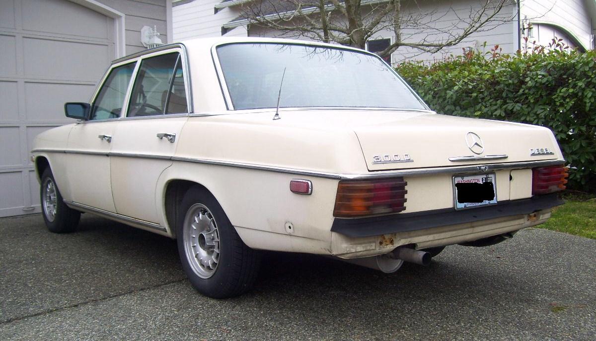

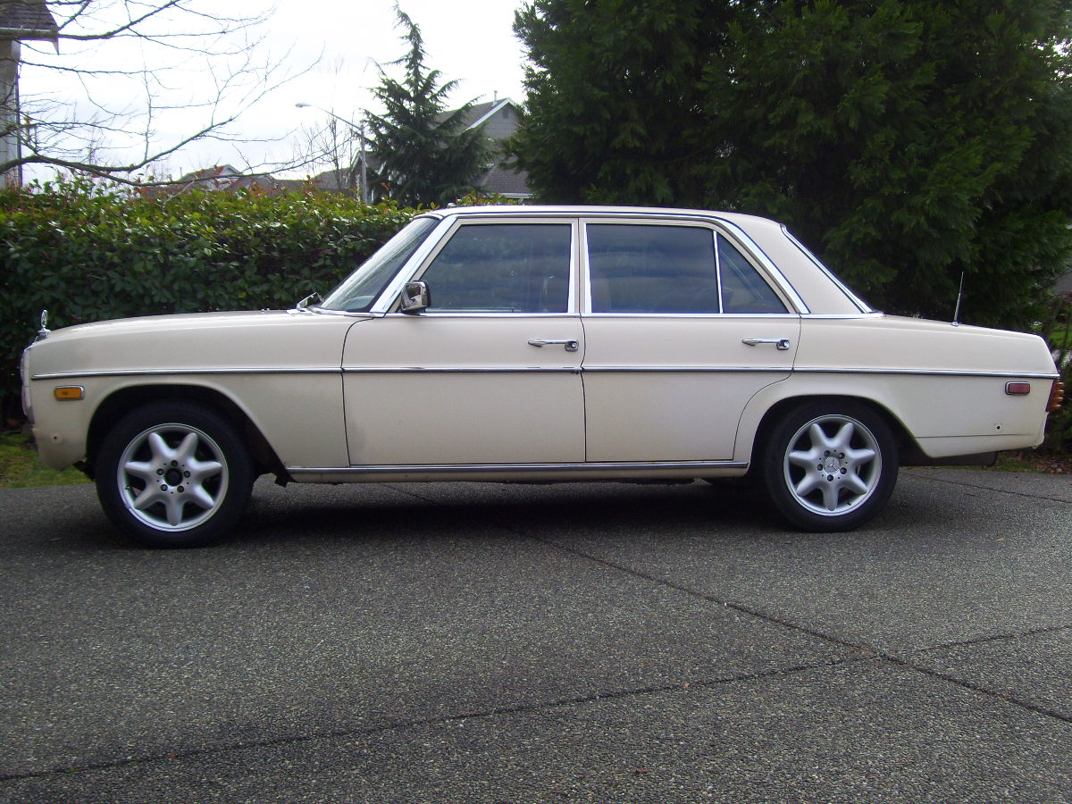

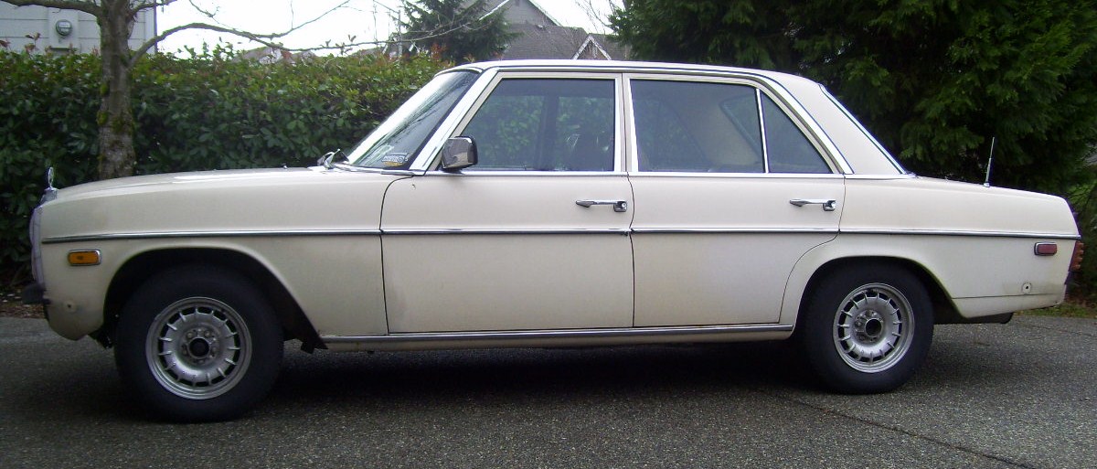

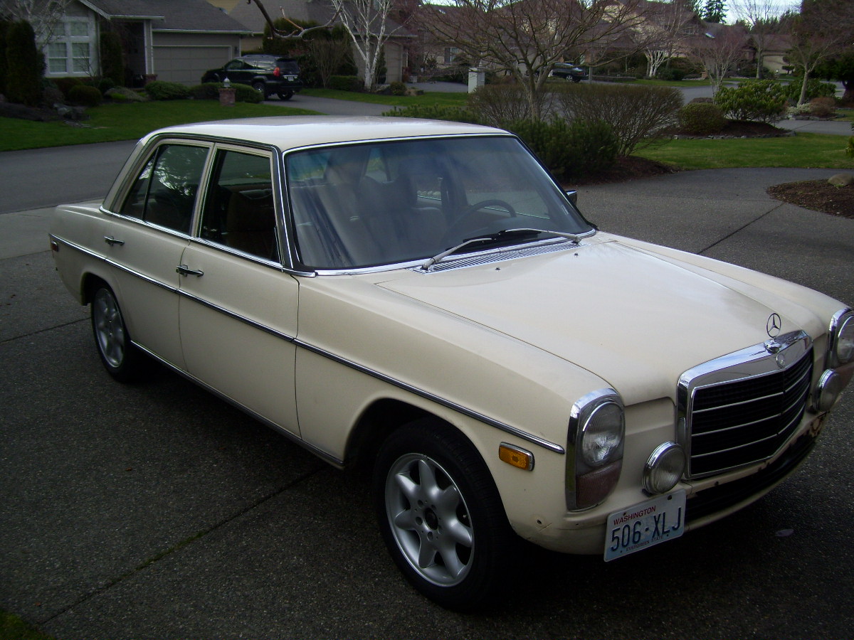

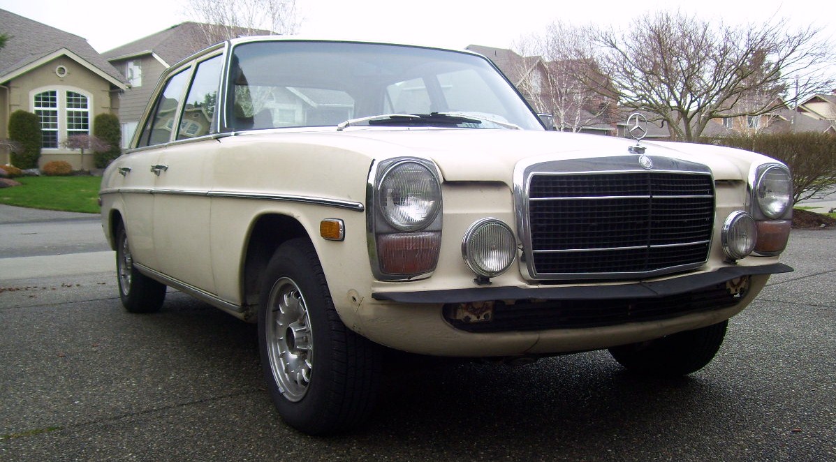

c12h23s' w115 300d - c12h23 - 02-04-2010 This is my new project for the time being. Picked up the car for a measly $250 due to the fact that someone didnt understand the importance of general maintenance of old mercedes diesels. Changed all fluids, valve adjustment performed, new glow plugs, new radiator hoses and cosmetic touches that make it my own. I am installing new monarch nozzels this weekend after a pop test and reshim of the injectors. Great little commuter car! Its a work in progress and for the money I dont think you can beat it!! Here are some new pic's with the new wheels and black rubber things removed. 2/17/10 RE: c12h23s' w115 300d - ForcedInduction - 02-04-2010 Get rid of those rubber shrouds and it will look pretty spiffy without bumpers! ![]() RE: c12h23s' w115 300d - willbhere4u - 02-04-2010 cool car is it a standard? if so a 617 turbo swap would kick ass RE: c12h23s' w115 300d - c12h23 - 02-08-2010 unfortunatly its an automatic, for now!! ![]() RE: c12h23s' w115 300d - winmutt - 02-12-2010 There is a turbo 115 out there with an ugly as hood scoop. Wish I had a link to a pic. RE: c12h23s' w115 300d - DeliveryValve - 02-14-2010 (02-12-2010, 07:47 PM)winmutt There is a turbo 115 out there with an ugly as hood scoop. Wish I had a link to a pic. This is not the ugly hood scoop car, but diametricalbenz's with OM617.910 Fast Glow Conversion Rajay Turbo 76 300D Air Filter OM617.952 Injection Pump 300D Flywheel 4 Speed Manual 3.69 Rear Differential http://www.peachparts.com/shopforum/showthread.php?t=195208 You tube video of it running. http://www.youtube.com/watch?v=uOew1zdeJHg RE: c12h23s' w115 300d - c12h23 - 02-17-2010 here is some updated pictures with new wheels and the black rubber bumper things removed. thanks for the idea by the way to remove those, it does look spiffy! ![]() RE: c12h23s' w115 300d - winmutt - 02-17-2010 This post is worthless without pics ![]() RE: c12h23s' w115 300d - c12h23 - 02-17-2010 (02-17-2010, 09:52 PM)winmutt This post is worthless without pics here are the before pictures... RE: c12h23s' w115 300d - Biohazard - 12-17-2010 So after swapping the cylinder head on the Flyin Pumpkin, I had my spare turbo cam and towers hangin out. The cam and rockers were pretty beat on c12h23's car. After a bit of eye-ball engineering, musing, and checking specs, we decided to see about swapping the 617a turbo cam, towers, and rockers onto his car. Well, the whole thing swapped on really straight forward. Even retorqued all the head bolts. Had to reset the cam opening time using the offset woodruff key, but not too bad of a process. While the top end was apart, he painted the valve cover with hi-temp flat blue to set it apart from the crowd. ![]() [attachment=3945] Happy to say the car has a bit better power. Not a powerhouse, but a slight increase and better throttle response according to him. RE: c12h23s' w115 300d - ForcedInduction - 12-18-2010 (12-17-2010, 07:21 PM)Biohazard Happy to say the car has a bit better power. Not a powerhouse, but a slight increase and better throttle response according to him. It shouldn't since the turbo cam has no valve overlap to scavenge exhaust from the cylinders. More likely the extra power is just from getting the cam timing correct(ed). RE: c12h23s' w115 300d - Diesel-Wiking - 12-21-2010 om617A and 7mm elements, it will make you a the new president! RE: c12h23s' w115 300d - George3soccer - 12-23-2010 He needs a turbo, swap in a turbo motor and you will be perfect. RE: c12h23s' w115 300d - Biohazard - 12-23-2010 (12-23-2010, 08:44 AM)George3soccer He needs a turbo, swap in a turbo motor and you will be perfect. Believe me, we know! ![]() |
