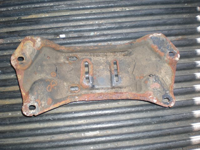

found this in the dirt distant from any cars in a yard. Im pretty sure its a MB cross member, but any idea what type?
RE: what tranny bracket is this? - charmalu - 02-22-2010
That is the transmission X mount. looks like off a 240D automatic.
when you do the 4 spd swap into a 300D, the 240D auto X mount is the one to use.
the auto X mount that the 300D automatic uses will not work, and the 240D manual skinny one will not work. some have cut the end off and drilled a new hole or tried to mount it on an angle.
You will have to move the X mount forward to the next set of holes, and the 240D auto seems to be the one to use. this is the one I used when I did my swap.
Charlie
RE: what tranny bracket is this? - JB3 - 02-22-2010
That is just what I wanted to hear. Big Grin
RE: what tranny bracket is this? - winmutt - 02-22-2010
Yup thats the one. Off center and doesnt have the "donkey ears".

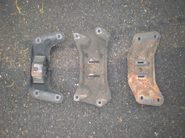

RE: what tranny bracket is this? - JB3 - 04-25-2010
comparison pic, left to right-
300D auto tranny cross member mount
240D auto tranny cross member mount
190E manual tranny cross member mount
RE: what tranny bracket is this? - winmutt - 04-28-2010
I believe you want the 300D auto plate no? The 240D auto is what we use with the 4spd manual.
