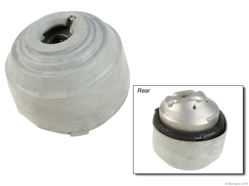

If this mount is not too tall and with some fabrication, you can use a w124 OM603 engine mount that is fluid filled.
Or perhaps a w210 OM606 or w211 OM648 fluid filled engine mount.
RE: Engine mounts - winmutt - 08-21-2010
I just got religious about hosing off the mounts after doing work. I think the heat shields are bad, as they prevent cleaning. The 124/201 mounts are WAY better ( and pricey)
