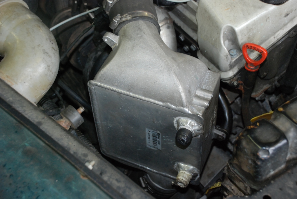

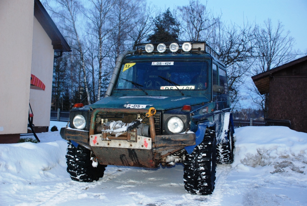

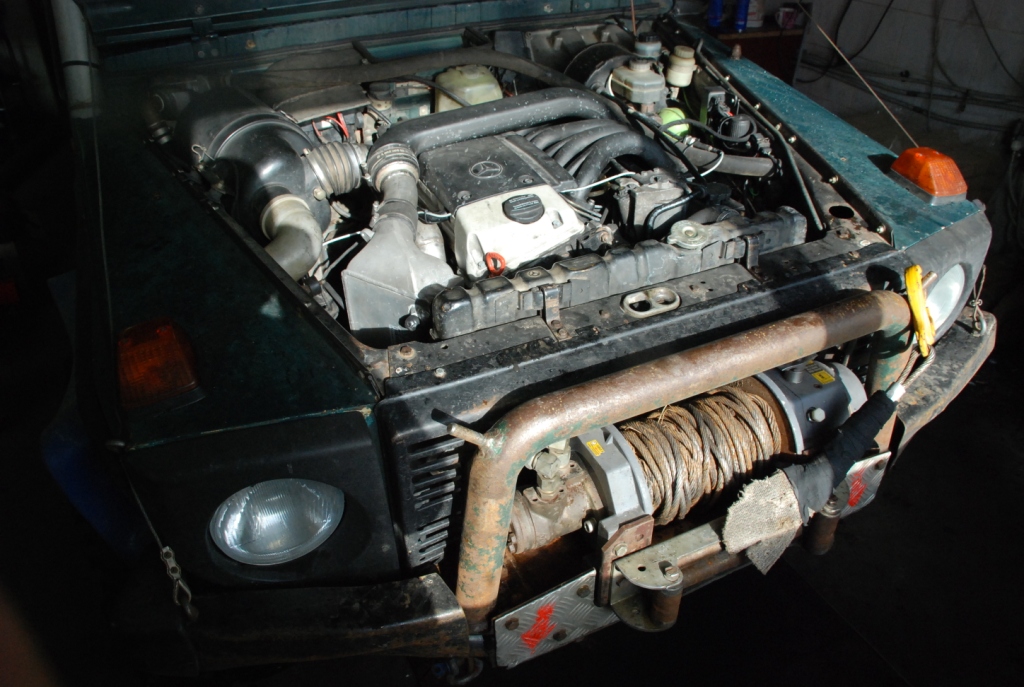

INC G-class - INC - 03-14-2010 Hallo! Some photo from my G-class. It`s heawy used in Latvia Trophy Raid championship TR1 class. 2007 year 1. place. 2008 year 2. place. 2009 year 1. place. News: Engine OM605 with A/W cooler (not finished) and modified ECU. RE: INC G-class - tomnik - 03-14-2010 Great pictures, Thanks. Seems like the intercooler is made for this car. Tom RE: INC G-class - gvp - 03-15-2010 Nice car!!! George RE: INC G-class - Syncro_G - 03-15-2010 Very Nice! I like how the 605 fits -- lots of space between valve cover and cabin vent Where did you put the battery? What is that A/W intercooler from (it looks like it's OEM mercedes)? How is the stock radiator doing to keep it cool? Did you put a big core in it? Regards, Christian RE: INC G-class - INC - 03-16-2010 (03-15-2010, 11:26 PM)Syncro_G Very Nice! I like how the 605 fits -- lots of space between valve cover and cabin vent Battery is optima gel, and its original place, but under rubber cover. A/W i think is from MB S600 AMG, but tomnik knows better ![]() Stock radiator when its clean works ok, but when its full of mud like in this picture....not so great ![]() RE: INC G-class - ForcedInduction - 03-16-2010 Its nice to see a genuine off-roader. Its kind of pathetic that there are so many lifted and "pimped" 4x4 pickups/SUVs in the USA that have never seen so much as wet grass in their lives. I think A/W is a good choice for offroaders, as that picture demonstrates. If you have a few gallons water capacity it will give you a good long time of boost before it gets heat soaked. An A/A would be screwed right away in that mud pit! ![]() |
