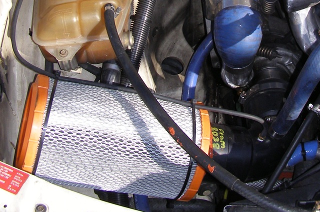

RE: cold air intake debate - CID Vicious - 03-26-2010
Aside from EGR flap removal, best mod I've done so far to Donkey.
[Image: IntakeSystem3.jpg]
13 bucks, not including the tape. Not bad for real results. The stock intake systems are fucking Byzantine, I'm sorry. They probably used them for one more generation because 'that's what the customer expects to see when they pop the hood'.
As for K&N fear, well, all I can say is those style of filter, if not K&N branded itself, is installed on motors across the globe and they're not necessarily lasting any detectable amount less long. If you want optimum wear don't modify the car and drive at grandma speeds, case closed. Next you'll be bitching that cornering hard wears out your tires faster. Duh.
Of course, I'm now ready to replace the intake system...with a modified 617a intake to run a turbo. Probably not for awhile though. Maybe not ever...not that it'll help an automatic 240D, but you're missing out if you haven't driven a slightly dropped 240D manual with an opened up intake system. Totally different car if you know how to drive it. It's intellectually satisfying to me, maybe - being generous - dealing with a whole 80hp in a 3300 lb car with my 200+ ass driving and god knows what in the trunk, passing cars with multiples of my horsepower, not to mention power to weight. When you consider that almost nobody gets to triple digits in any remotely well inhabited section of this country then my maybe 1100 dollar highway screamer makes all the sense in the world. If you have 'real' power you're probably driving at 2/10ths throttle to conserve mileage - I can run wide open as much as I want to and never get below 30mpg. Driving a slow car fast vs. driving a fast car slow.
Do it as cheap as you can - no one cares how much you spent on your slow assed diesel Benz so go for benefit over looks.
Oh, and you want to feed the filter with cold air - once it's in the tube it's traveling at near the speed of sound and there really isn't enough surface area to transfer that much of the heat. If wrapping the tubing makes you feel better...buy plastic in the first place and save a couple of bucks.

I'm looking to do something similar to my now stock '83 300SD. My only concern is what to do with the blowby canister and tube. How did you deal with it? I was thinking of letting it drain on the firewall for rust prevention, but I have no idea how much blowby I'm actually producing. What filter is it that you have on there? It's huge. I'm not afraid to copy cat if it works, if nothing else it looks intimidating Tongue
ETA: Ahh, I'm guessing it's a Fram 8038?

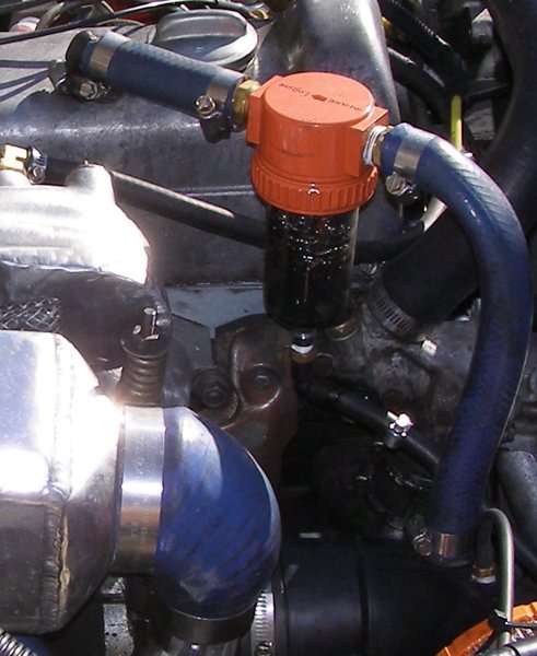

RE: cold air intake debate - forcefed44 - 04-10-2010
Does anyone happen to have a pic of how the oil seperator and catchcan plumbing is sety up when running a CAI?
RE: cold air intake debate - ForcedInduction - 04-10-2010
(04-10-2010, 04:20 PM)forcefed44 Does anyone happen to have a pic of how the oil seperator and catchcan plumbing is sety up when running a CAI?
Thats up to the individual. Something will have to be purchased or made.
All you need is something that will swirl the air to sling the oil to the walls and/or has a large surface area media to grab the oil. It can be attached to the old oil drain tube, the nipple the tube attached to or just run into a drain bottle.
Running without a separator is not recommended. There is quite a bit of oil in the air that even without an EGR to cake the intake can cause oil to pool and make the engine spit blue smoke.
