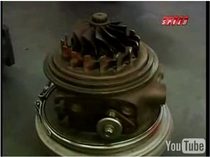

I was on the Banks site last night and was studying the buildup of that truck and there were a few shots of the exhaust turbine and it looked like a variable unit to me. Check it out you may know better than me. I tried to find the exact picture but couldn't quickly, I think there is a shot of it in the video of Banks on Muscle Car TV.

Telecommbrkr *snip*...there were a few shots of the exhaust turbine and it looked like a variable unit to me...
Based on the still photos I saw, those hairdryers do look interesting (small compressor inducer, but 'normal' to large compressor housing?), but not VNT/VGT... I'm not saying that they're definitely not - but I just can't tell from the few pics I've seen. A friend of mine from KY saw it in person - but he didn't comment if they were VNT/VGT or not - but he did see the 3 carbon fiber nitrous oxide bottles.

Re: Banks 'smokeless' 1000hp Duramax - Telecommbrkr - 05-13-2008
I ended up reading everything about the S-10, and they explain that they have that much NOS volume so that they have consistent pressure all the way through the run, not cause they actually use it all. Also, the primary use of the nitrous is to cool the charge down to 120deg. F (if I remember right) to achieve the smokless power. From what I read they had the HP without the NOS using twin cummins marine A/W IC's.
When you watch one of the first videos in the first couple of pages, after the video is done you get the chioce to watch some more. Along the bottom is another one of about 10 minutes where Gale Banks is on Muscle Car TV and he talks at length about the engine, there is also a few shots of the innards of one of the exhaust turbines sitting on a bench. Wish I knew how to take a screen-shot off youtube.

Re: Banks 'smokeless' 1000hp Duramax - Telecommbrkr - 05-14-2008
Ok, here's a shot of it:

Re: Banks 'smokeless' 1000hp Duramax - bgkast - 05-15-2008
That's a VGT alright.
Re: Banks 'smokeless' 1000hp Duramax - HoleshotHolset - 05-19-2008
bgkast That's a VGT alright.
Sure is. Good to know...
