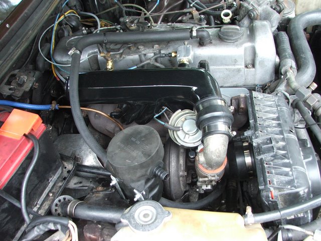

cold air 115 intake q?'s help cold air on 300SD - btrapr - 03-20-2010 I bought a couple of the earlier 5 cylinder intake 115's that have the long runners and the snout pointing at a forward angle... Looking to add a different filter intake tube, eliminate the airbox & EGR, then put this intake on my 84' 300SD Are there any prior posts that would help me figure out my tubing needs...I scrounged up a few pieces of 3"...with bends and I am hoping I can cut them here/there and get it to adapt...with connectors... I am interested in looking at piping options____I am new to this kind of mods *please post any posts that have pics to add me with this project thanks in advance I am not adding a vnt at this itme! here is a pic form another thread whee a guy add a vnt...BUT this is the intake I bought RE: cold air 115 intake q?'s help cold air on 300SD - DrewGerhan - 03-20-2010 a couple implies more than one. want to sell one? RE: cold air 115 intake q?'s help cold air on 300SD - ForcedInduction - 03-21-2010 The mouth is the metric equivalent of 2.5". RE: cold air 115 intake q?'s help cold air on 300SD - Syncro_G - 03-21-2010 (03-21-2010, 05:39 AM)ForcedInduction The mouth is the metric equivalent of 2.5". I found http://www.siliconeintakes.com/ to be a decent place to go to get silicone hose, couplers and clamps. prices are great and quality seems decent. I don't know where to go to get off the shelf metal pipe sections though. I'll be doing this shortly too (have the intake but am waiting to get the VNT and some time to fab parts) RE: cold air 115 intake q?'s help cold air on 300SD - Rudolf_Diesel - 03-21-2010 www.siliconeintakes.com is where I have buying my silcone hoses from, quality and price are right on the mark. As far as sections of pipe, you could try this co: http://stores.ebay.com/mandrel-bends - I have purcahsed from them as well. Prcie and availability of size, style and material are good. You could always buy a universal IC pipe kit on ebay and get just about everything you need, that is what I did and have a few leftovers for another project. RE: cold air 115 intake q?'s help cold air on 300SD - Nick - 03-22-2010 man with that kind of intake you are pretty much required to install an intercooler! ![]() RE: cold air 115 intake q?'s help cold air on 300SD - btrapr - 05-01-2010 I have decided to part with one of these intakes any takers? just send me an e-mail and be patient as I am working doubles off/on...Will respond ASAP thanks RE: cold air 115 intake q?'s help cold air on 300SD - capflya - 05-02-2010 How much do you want for it? |
