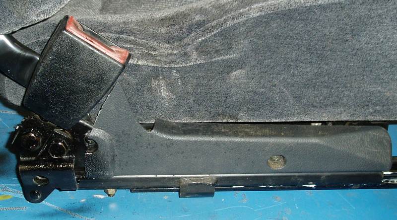

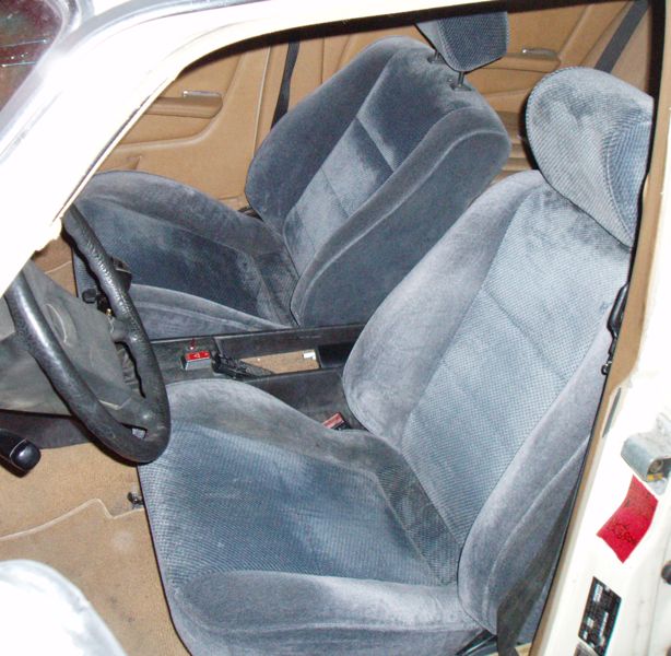

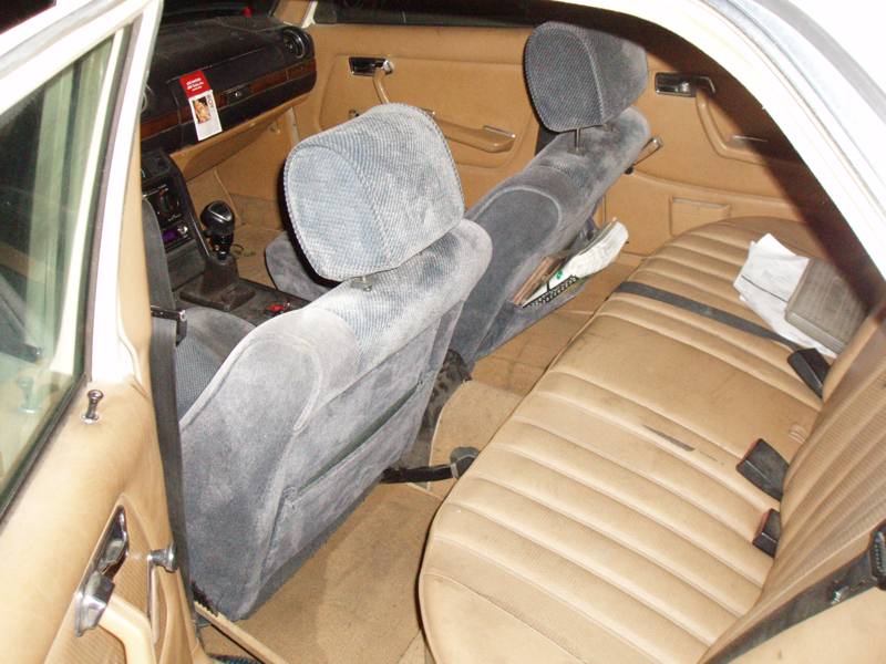

I chose to use bucket seats from a 6th generation (1992) Mitsubishi Galant. It was a close call between the Galant, an Eclipse GS and Honda Prelude also in the yard. The Galant won because the Honda and Eclipse both would have required brackets to mate with the rear mount holes and the Prelude seats are too small (tight) for my body frame. The Galant fits perfectly with the stock Mercedes seat mounts with 2 minor modifications and no brackets!
The only modifications done were welding the travel stop blocks to the seat frame (due to the bolts hitting the rear bolt mount), fitting the Mercedes seat belt buckle and removing the unneeded Mitsu lap belt guides.
Pros:
The installation was easy, the seat is comfortable (it has lumbar support and height adjustments), it increases head room by 2", side supports, all mechanical adjustments, no more recline knob Big Grin and combined they weigh about 40lbs less than the MB seats.
Cons:
No more armrest, harder to get out of the car (I feel my leg will eventually rub the seat material through), color does not match, the belt buckle is a little recessed (easily changed later) and its Japanese parts in a Mercedes.
Overall, first impressions are very good and I feel this is a worthwhile change.
