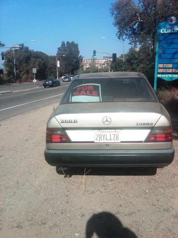

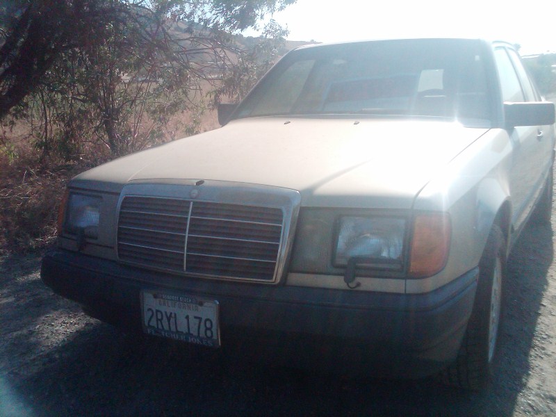

RE: Best MB Diesel - Captain America - 08-24-2010
Is this the one!?!
Just turned 143K?
RE: Best MB Diesel - meareweird - 08-24-2010
Looks kinda sketchy to me why are the trim badges on the back at different heights?
I dunno, spent all of about 3 seconds looking at it...
RE: Best MB Diesel - ForcedInduction - 08-25-2010
I'd skip that one. It reeks of odometer rollback.
RE: Best MB Diesel - Captain America - 08-25-2010
Awe man, I was afraid of that.... I might call anyway just to see what kind of idiot is on the other end of the phone Wink

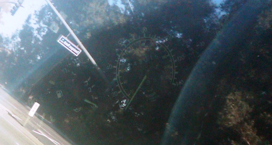

RE: Best MB Diesel - meareweird - 08-29-2010
Does it say 043015 I thought it said 143015 or 243015 would make more sense cant really make out the first digit.
RE: Best MB Diesel - Captain America - 08-29-2010
it said 143015
