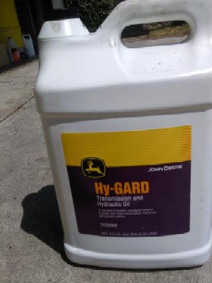

As you know I have been having some trans issues since the S/C and the Über pump - mainly flaring and some high speed slippage. The high speed slippage occurs when I am cruising on the freeway and I floor it and the RPMs and boost rise, but the MPH stays the same.
I did some research and found that many of the guys running autos and drag race use something called "tractor fluid". Upon further research I found that specifically use John Deere "Hy-Gard" transmission and hydraulic fluid for heavy equipment and tractors. I use Sweepco 714 in my truck, which is basically the same type of fluid, but supposedly the best out there. Sweepco is used in throphy truck auto transmissions and they sometimes run up to 400*F and the oil does not break down. Sweepco is supposed to have an additional additive that the Hy-Gard does not, but the Hy-Gard is only $14.00+ / gallon vs. the Sweepco at $32.00 / gallon.
I purchased 2-1/2 gallons of Hy-Gard on Friday from a John Deere dealer in a nearby town (home of West Coast Choppers). I also purchased 2 gallons of Wal-mart brand Dex III to aid in flushing the trans. Other supplies needed were a 5 gallon bucket and 3/4" I.D. clear vinyl hose.
I removed the trans cooler line from the passenger side of the radiator and installed the vinyl hose on the rubber hose coming from the radiator and ran the vinyl hose into the 5 gallon bucket. I started the car and as the fluid was coming out of the hose and into the bucket I was adding the fresh Dex III into the dipstick tube. I poured 8 qts. into the trans and ran the motor with my assistant putting the trans through the gears and leaving it in drive until the fluid onl started to trickle out of the vinyl hose. At this point I stopped the engine and I drained the balance of the fluid from the pan and also drained the torque converter. I let it drain for about 45 minutes until it looked like it was only a few drops.
Most of the guys that are running the Hy-Gard use at least one quart of tranny fluid for coloring the base fluid and for some of the additvies, but mainly for color. I added 6 qts. to start and took it for a test drive, really quick to see if all was well. I also needed to adjust my my linkage since the motor was lowered and the linkage was off a bit.
I took it for a test drive and I CAN feel a difference, the shifting is a little firmer, yet not harsh. Those that have used it described it as "grippy". On hard accelleration, there is a slight flare between 2-3, but not as bad as before. When I am on the freeway it still slips a bit, but if I back off on the trottle a bit the speed catches up to the RPMs.
I will report more as I drive it some more and allow the fluid to do its' magic....The other thing I need to do is use a smaller orifice and see if that helps 2-3 shifting.
