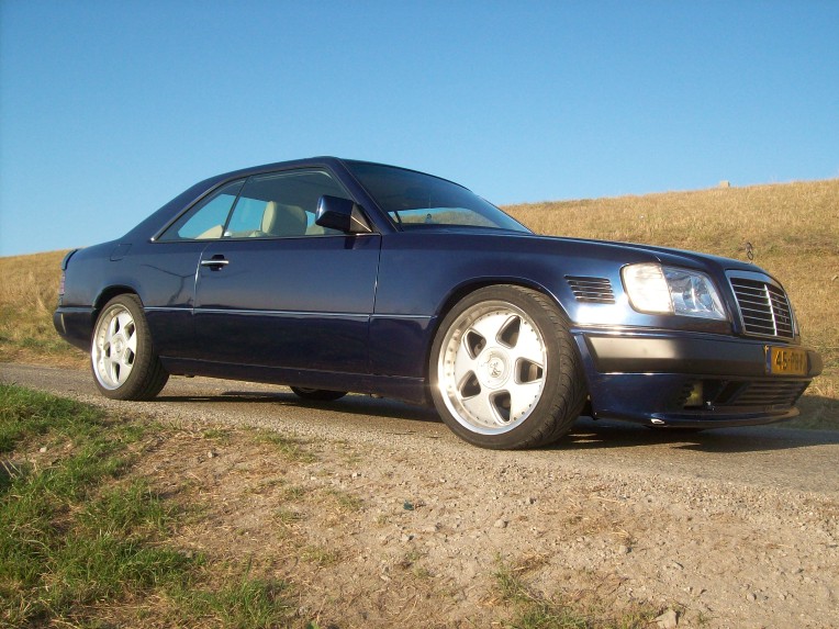

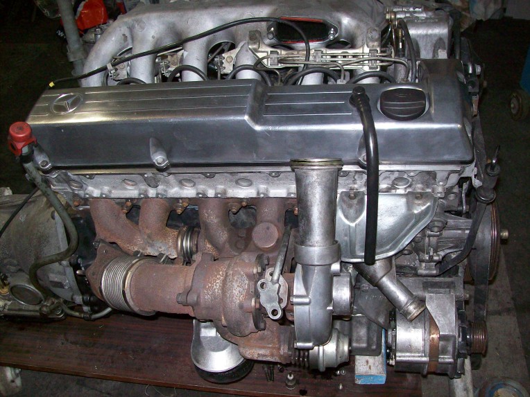

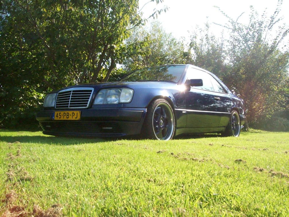

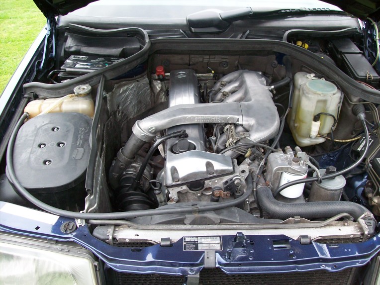

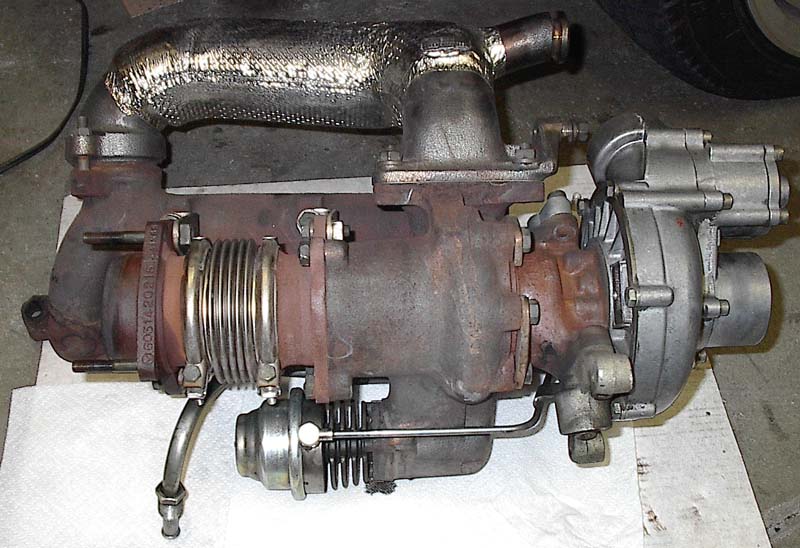

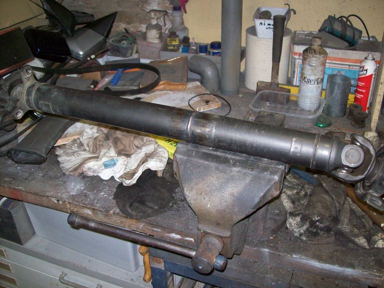

C124 300 turbodiesel - mb-rene - 10-17-2010 Hello, this coupe started as a 230ce when i bought it two yars ago,i did a complete conversion to a 300 turbodiesel since then a daily driver gr rene RE: C124 300 turbodiesel - ForcedInduction - 10-17-2010 Thats a very clean conversion. Was the right fender a straight swap from the sedan? RE: C124 300 turbodiesel - mb-rene - 10-17-2010 (10-17-2010, 07:59 AM)ForcedInduction Thats a very clean conversion. thanks, yes the right fender is the same, gr rene RE: C124 300 turbodiesel - willbhere4u - 10-17-2010 Very nice you must have a euro exhaust manifold? The w124 coups are a very n ice looking car RE: C124 300 turbodiesel - ForcedInduction - 10-17-2010 (10-17-2010, 11:30 AM)willbhere4u Very nice you must have a euro exhaust manifold? Thats all he has since hes in the netherlands. ![]() RE: C124 300 turbodiesel - mb-rene - 10-17-2010 (10-17-2010, 11:30 AM)willbhere4u Very nice you must have a euro exhaust manifold? The w124 coups are a very n ice looking car thanks,yes i think so,i know of two exhaust manifolds,with or without egr gr rene RE: C124 300 turbodiesel - garage - 10-17-2010 VERY NICE! That is one sweet ride. RE: C124 300 turbodiesel - winmutt - 10-18-2010 Nice wheels! What are those? Is that a WALD I replica kit or? RE: C124 300 turbodiesel - willbhere4u - 10-18-2010 I wish I could get my hands on one of those manifolds over here in the US lol! RE: C124 300 turbodiesel - mb-rene - 10-19-2010 (10-18-2010, 04:37 PM)winmutt Nice wheels! What are those? Is that a WALD I replica kit or? wheels are keskin kt5 18" 8,5J ET 35 225/40 tyres frontbumper and rear spoiler AMG original ![]() sadly no rearbumper and sideskirt...yet (10-18-2010, 10:10 PM)willbhere4u I wish I could get my hands on one of those manifolds over here in the US lol! is there a big difference with the us manifold? RE: C124 300 turbodiesel - willbhere4u - 10-19-2010 yea the US version sucks! Here is a picture I stole off of this sight from a different forum it's like a log manifold that has a trap oxidizer delete installed between the turbo and the manifold Mercedes recalled the trap oxidizer for creating excessive heat and damaging the cylinder heads note the manifold is behind the turbo it goes through a lot of stupid bends to get to the turbo! RE: C124 300 turbodiesel - mb-rene - 10-20-2010 oke thanks,that is really a strange contraption,also the turbohousing is different RE: C124 300 turbodiesel - Anis - 12-16-2013 (10-17-2010, 02:44 AM)mb-rene Hello, Hi MB Rene, I'm writing to you from Tunisia, I'm planning to do the same modification on a coupé c124, could you please explain the different steps of the operation ? Photos, what are the different things not to forget ? Thanks ! RE: C124 300 turbodiesel - maxypriest - 12-17-2013 What a fantastic conversion. How did you wire in the vacuum stop, glow plug unit and the rev counter? I have yet to find a rot free w124 saloon for my 606 project, so may start looking at coupes, as have seen loads of clean ones. Cheers, Max RE: C124 300 turbodiesel - mb-rene - 12-17-2013 Thanks.... i replaced compleet wire loom and ignition RE: C124 300 turbodiesel - maxypriest - 12-17-2013 (12-17-2013, 11:34 AM)mb-rene Thanks....Was it a lot of work to swap over? RE: C124 300 turbodiesel - Tito - 12-17-2013 Nice ride! Where are you from Rene? RE: C124 300 turbodiesel - mb-rene - 12-17-2013 for wire loom , you have to take out the dash , then it's easy access compleet swap cost me two weeks @ Tito Colijnsplaat Zeeland RE: C124 300 turbodiesel - DiseaselWeasel - 12-20-2013 How did you sort he prop shaft? I had mine shortened as I wanted to keep the 110m flex discs ![]() ![]() RE: C124 300 turbodiesel - mb-rene - 12-20-2013 Yes i did too RE: C124 300 turbodiesel - mario - 12-20-2013 Looking very well as I love the wheels RE: C124 300 turbodiesel - mb-rene - 12-21-2013 RE: C124 300 turbodiesel - mario - 12-21-2013 Looking very well there man |
