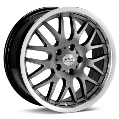

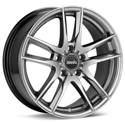

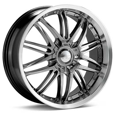

I looked on TireRack.com for wheels I would like either a 16" or 17" for a little nicer look and performance. I used a 1998 CLK350 for the vehicle was this the correct vehicle I have a 1980 300 CD and they dont have many choices here is what I found the first pic is the one they say will fit the car but it is a 15" the second is for the 88 CLK 16". The third is a 17". What do you think of the look for the car also?
Here is there info I know the 15 will fit dont know if it would look good considering it is only a 15" The car is sock but would like to lower 1" also.
Thoughts
Offset: mm
Backspacing: "
Bolt Pattern: 5-112
Rec. Tire Size: 205/60-15
Weight: Not Available
Finish: Hyper Black w/Machined Lip
16" Info for CLK car
Offset: 35mm
Backspacing: 5.62"
Bolt Pattern: 5-112
Rec. Tire Size: 205/55-16
Weight: 20.2lbs.
Finish: Bright Satin w/Machined Lip
17" Info for CLK again
Offset: 35mm
Backspacing: 5.66"
Bolt Pattern: 5-112
Rec. Tire Size: 225/45-17
Weight: 20.4lbs.
Finish: Bright Satin Sil Paint
RE: Will these fit - winmutt - 10-27-2010
No offset is too high. 7.5" You are going to have to go with 25 or less and them maybe still need a spacer/shim. I *think* you need 18 atleast to clear the tie rods if you use a higher offset but your stance will be narrower.
RE: Will these fit - Oil Burner - 10-27-2010
(10-27-2010, 08:57 AM)winmutt 7.5" You are going to have to go with 25 or less and them maybe still need a spacer/shim.
What do you mean by 25 or less?
Quote:I *think* you need 18 atleast to clear the tie rods if you use a higher offset but your stance will be narrower.
Why will these hit the tie rods if they are bigger than the original...width
RE: Will these fit - willbhere4u - 10-27-2010
If they are any wider than 6in they will hit the tie rod unless the diameter of the wheel is 18 or larger
Personally I moved the tie rods in on my car about a 1/2 inch and shorted the tie rods to gain room for my 16x8 SL wheels!
RE: Will these fit - mike-81-240d - 10-28-2010
Oh my those second wheels are mighty sweet looking... Just run some fatty H&R hub centric spacers if need be.
