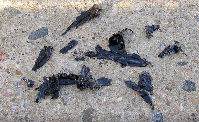

This was half clogging my oil pump's intake screen.
RE: Do not use silicone on your gaskets - ben2go - 10-30-2010
Someone went a little to heavy on it.I usually use gasgacinch.Spelling may not be right.It's kind of like a glue for gaskets.Mainly used to hold them in place during assembly.
RE: Do not use silicone on your gaskets - willbhere4u - 10-30-2010
Did you notice any difference in your oil pressure now that it has a clear pick up?
RE: Do not use silicone on your gaskets - ForcedInduction - 10-30-2010
It took a little while to prime the air out but the needle does pop up a spit second quicker now. Could just be the new oil though.
