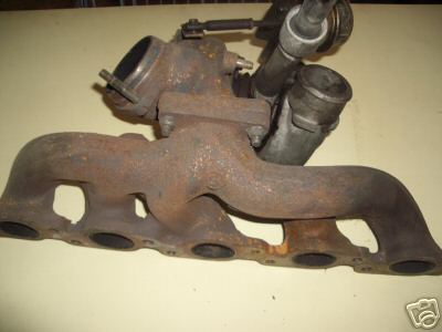

Sprinter Exhaust Manifold - amcya - 11-01-2010 Does anyone know if the ex. manifold from a sprinter will fit on an OM602? RE: Sprinter Exhaust Manifold - willbhere4u - 11-01-2010 I'm not sure! But if I where a betting man I would bet not! RE: Sprinter Exhaust Manifold - ForcedInduction - 11-01-2010 Nope. Similar but the angle of the bolt pattern is more vertical on the CDI. RE: Sprinter Exhaust Manifold - Schno009 - 11-01-2010 If i'm not mistaken, the Euro-sprinter came with an 602.982, whose manifold would fit any other 602... I'm not sure if this is what the OP means. RE: Sprinter Exhaust Manifold - George3soccer - 11-02-2010 Yes the older euro vans did come with a 602 euro diesel if I'm not lieing. RE: Sprinter Exhaust Manifold - amcya - 11-02-2010 Thanks for all the responses. Does anyone know what year the 602 appeared in the sprinter? what turbos did they use on them? I am lookin for an easy way to go VNT on my car. RE: Sprinter Exhaust Manifold - ForcedInduction - 11-02-2010 There is no easy way. You'll either have to make an adapter plate to use the common GT20 or GT22 turbos in the USA or import a VW turbo from Europe that has a T25 flange such as this: http://cgi.ebay.co.uk/Audi-A4-A6-A8-All-Road-2-5-TDI-TURBO-CHARGER-454135-/270642464190 RE: Sprinter Exhaust Manifold - amcya - 11-05-2010 Has anyone documented the installation of one of these turbos from a 2.5 TDI? I searched and couldn't find anything. RE: Sprinter Exhaust Manifold - Einar - 11-05-2010 The 2.9 DI engine also came in W/S210(E290) too, 129 HP / 300 NM, But did hey com with VNT? I believe they only have wastegated turbo`s RE: Sprinter Exhaust Manifold - ForcedInduction - 11-05-2010 Only CDIs used VNT turbos. RE: Sprinter Exhaust Manifold - devton - 11-08-2010 (11-02-2010, 06:15 PM)amcya Thanks for all the responses. Garrett GT25c used .It is WG not VNT |
