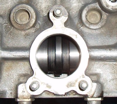

OM617 Lift pump removal - stomis - 11-01-2010 I need to remove my lift pump. I cant for the life of me figure what exactly it is thats keeping it in there. Any general directions? Its the last piece holding me up on the final tear down of my short block... RE: OM617 Lift pump removal - MB TECH - 11-01-2010 what have you all removed so far? RE: OM617 Lift pump removal - ForcedInduction - 11-01-2010 Lift pump is held on by 2 fuel lines and 3 10mm bolts. RE: OM617 Lift pump removal - stomis - 11-03-2010 (11-01-2010, 10:16 PM)ForcedInduction Lift pump is held on by 2 fuel lines and 3 10mm bolts. K I'm on crack. Meant to say the part of the injection pump that ties into the timing chain. Everything else is off the motor minus the chain and the rotating assembly. RE: OM617 Lift pump removal - ForcedInduction - 11-03-2010 The timer? Remove the vacuum pump, remove the chain retaining pin on block, lift the chain off of the timer's sprocket and it should slide right out. RE: OM617 Lift pump removal - stomis - 11-04-2010 (11-03-2010, 10:27 AM)ForcedInduction The timer? Remove the vacuum pump, remove the chain retaining pin on block, lift the chain off of the timer's sprocket and it should slide right out. If I did one of those "over look the easiest possible answers" moments I'm gonna be pissed at myself lol. Thanks. RE: OM617 Lift pump removal - stomis - 11-06-2010 So yes I overlooked this... It came out with a little fanageling. So I lied theres still some of the pins from the chain guides in there. They've got this SBC boy a little stumped lol. They appear the only way to take them out would be to screw a bolt into them and use a slide hammer? RE: OM617 Lift pump removal - MB TECH - 11-06-2010 that method or use a long bolt, a socket and a nut (making a small puller) will work. |
