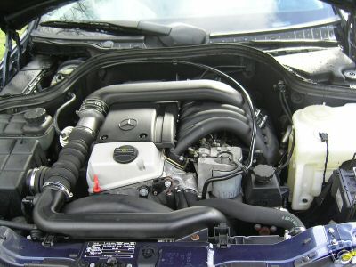

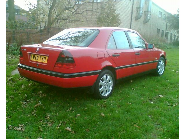

Hello, my name is Ricardo from Portugal and I am lover of mercedes benz, w201 as I have a 2.5 turbo diesel (122hp) turbo KKK, 5-speed manual, but unfortunately my engine is coming to an end, now I'm confused and I liked to know your opinion ... I was thinking about buying a w202 c250 turbo diesel bumpy and you get this engine to work without ECU with my injector pump and I get to 200hp is possible? And that will give more material in my w201? Differences? Has anyone done this? All ideas welcome ... Excuse my English but use a translation program ... Greetings
[Image: 03122008047vl2.th.jpg][Image: 03122008046gk0.th.jpg]
[Image: 03122008045so7.th.jpg][Image: 03122008044lp7.th.jpg]
[Image: 03122008042ha0.th.jpg]

The C250 he is talking about would be the OM605, a car we can only dream of getting in the states.
RE: my benz - rikardo_td190 - 01-07-2009
That engine (605) but to work with my injector pump (602 ).... more material that would give a car (w202) to another (w201)? Someone already did? Thank you for everything Smile
RE: my benz - rikardo_td190 - 01-14-2009
So what is the best engine for my car? om 602 vs 605
RE: my benz - ForcedInduction - 01-15-2009
Both are great engines but the 605 has far more potential.
Converting the W202 to mechanical linkage for the pump would be difficult but doable. The hard part would be how the transmission would be controlled since its electronic too.
Swapping your 602 for the 605 would be somewhat more difficult since it requires an intercooler.
In either case, you would have to change the wastegate control to a normal actuator instead of vacuum control.
