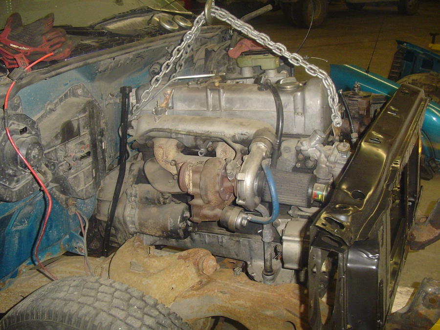

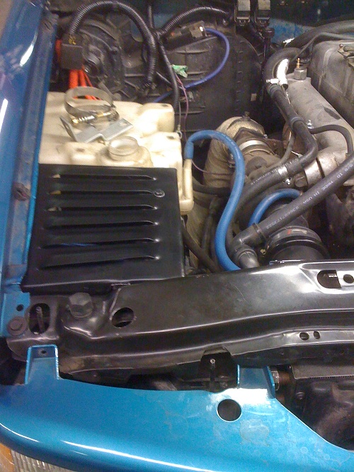

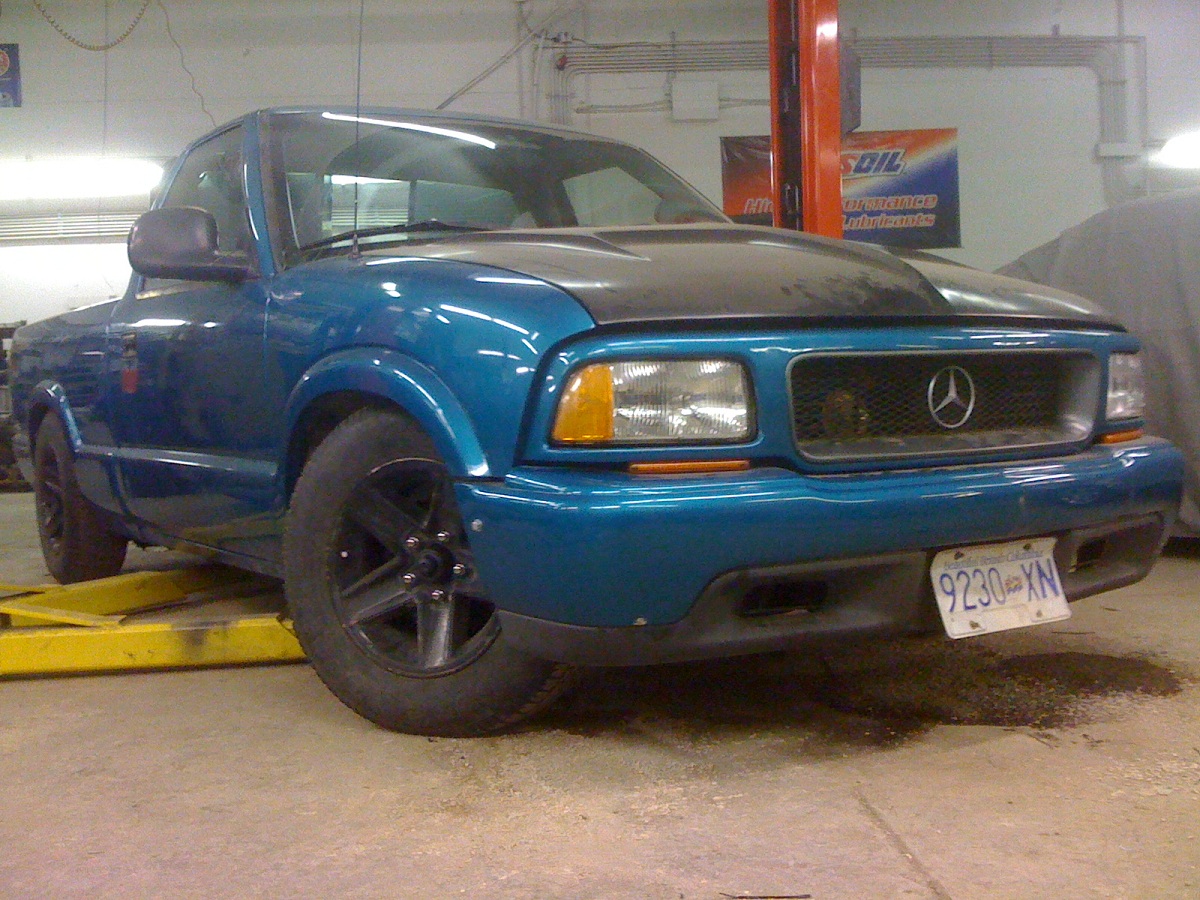

1981 300D / 94 S-10 - MB-S-10-300D - 12-22-2010 Hi This is my 94 Chev S-10 with engine and trans from an 81 300D, 4" turbo back exhaust, Cold air intake RE: 1981 300D / 94 S-10 - Captain America - 12-23-2010 Dope! We need more info and Pics! RE: 1981 300D / 94 S-10 - MB-S-10-300D - 12-23-2010 Installing Engine Cold Air Intake This is my first Benz..... Engine. One of my mechanics had this engine sitting around. Thought it might be neat to build a diesel S-10. Lots of custom work but it fit very well and everything worked just right. (except overdrive and a missing vacume switch off the valve cover) Also no tach signal.... drives amaizing and incredible on fuel. More to come as I tune and upgrade it. Running a Ford 8.8 with 3.55 gears limited slip, rear sway bar and disc brakes lowered 5"front 3" rear. Dual batteries in the box. RE: 1981 300D / 94 S-10 - Diesel-Wiking - 12-23-2010 cool ride! RE: 1981 300D / 94 S-10 - Captain America - 12-23-2010 Awesome. Whats the black hose that runs parallel to the intake manifold? RE: 1981 300D / 94 S-10 - Syncro_G - 12-23-2010 (12-23-2010, 05:21 PM)Captain America Awesome. oil supply to turbo oops. wrong pic. heater core send/return? RE: 1981 300D / 94 S-10 - willbhere4u - 12-23-2010 Is that a built in battery charger on the LH front corner? over all looks good I like it! RE: 1981 300D / 94 S-10 - MB-S-10-300D - 12-25-2010 Yea thats the heater core return pipe. For a diesel it really cranks out some good heat in the cab. Was kinda wondering how the winter would be here ! (12-23-2010, 09:33 PM)Syncro_G(12-23-2010, 05:21 PM)Captain America Awesome. Thats my positive junction terminal (out of a Chrysler Intrepid) . I put the batteries in the box to try and move some weight to the back. (12-23-2010, 09:42 PM)willbhere4u Is that a built in battery charger on the LH front corner? over all looks good I like it! RE: 1981 300D / 94 S-10 - Jtn190D - 12-25-2010 Like the Mercedes sign in the grill! RE: 1981 300D / 94 S-10 - MB-S-10-300D - 12-26-2010 Just a little hint of whats hiding inside ! RE: 1981 300D / 94 S-10 - 300D50 - 12-26-2010 I was going to do that with my truck as well, makes people freak when they can't figure out what it is! :p Looks awesome, any issues with the added weight up front? RE: 1981 300D / 94 S-10 - MB-S-10-300D - 01-01-2011 Can definatly feel the weight up front but drives very nice. Il be upgradeing to front slotted rotors and ceramic pads next to handle the extra weight during hard breaking. I added rear disc brakes witch makes a big differance. |
