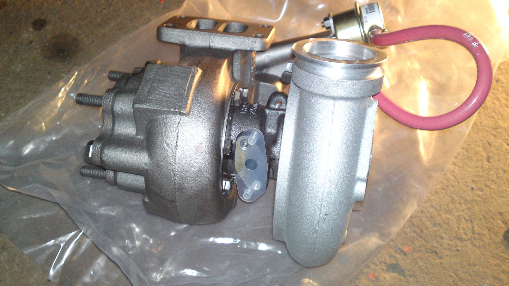

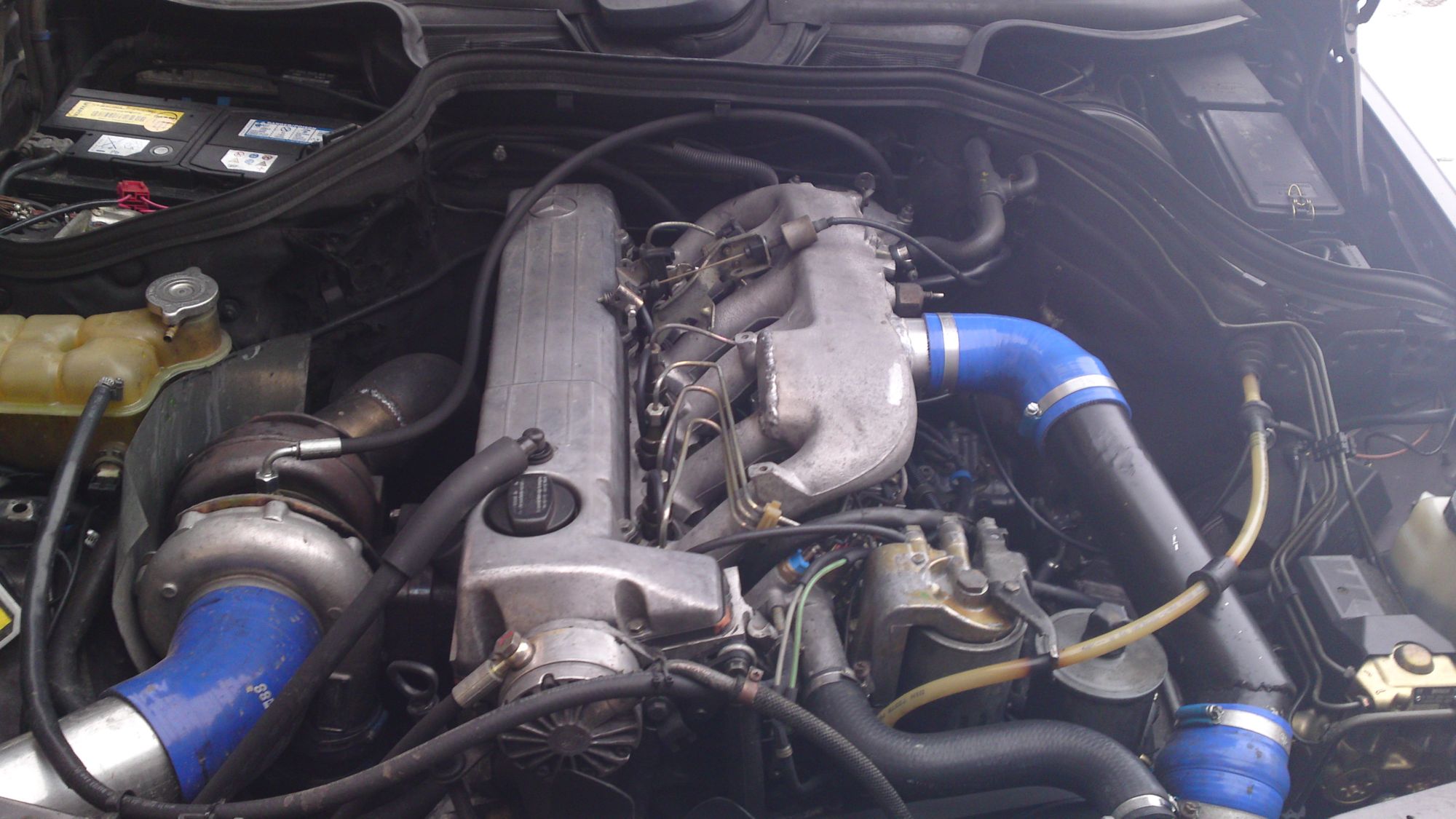

Find an optimal turbo - hansebanger77 - 02-09-2011 hello guys I'm looking for a suitable turbo for my 603 I currently have a "HX50""where I realized too late that it is not original. This should be the data Compressor: 86.1mm Inducer Exducer 77mm Turbine: 99mm inducer Exducer 63mm comes at 4000 rpm... that's funny that power. but too late now I'm looking for a suitable turbo starts the past but still making performance and durability. cheap would be great ![]() http://cgi.ebay.de/Holset-HX50-Turbolader-Neu-G60-16V-VR6-R32-LET-LEH-/220733863211?pt=Autoteile_Zubeh% C3% B6r & hash = item3364c3752b what could be a HX35? ist it to small? he should make 400HP thx! RE: Find an optimal turbo - George3soccer - 02-09-2011 oh i see a sls pump, what chassis is this 603 in. 400hp might be to small for a hx35, try looking for the hx40 8 blade. Should be able to reach your goal with that turbo. RE: Find an optimal turbo - tomnik - 02-09-2011 where did you take the turbo oil supply from?? What did you modify on your IP? Did you use the original exhaust manifold? Depending on what you did on the pump, I'd first try this turbo with larger element pump. Spools faster and you will need it anyway. Tom RE: Find an optimal turbo - hansebanger77 - 02-09-2011 (02-09-2011, 11:42 AM)George3soccer oh i see a sls pump, what chassis is this 603 in. w124 300d It is a pump with a 7 mm elements of PP diesel from finland. yes I think also a hx40 would be optimal. but a turbo-specialists in my region, believes that the hx40 would fit, but the "wave"? "shank"? (sorry dont know the right word) is too weak. its breaking to fast at 2 bar boost pressure. now I'm not sure ... hans (02-09-2011, 01:47 PM)tomnik where did you take the turbo oil supply from?? Directly from the oil filter housing. with a T piece to the oil pressure switch * 7mm elements * Yes, unfortunately. I am not able to build myself a self. u buy? where? ![]() * The pump is enough to make diesel 400hp. the turbo spools at 4000 rpm. thus have a very narrow rpm band. ![]() btw the turbo has a T6 Flange and has 18kg ist verry big thx Hans ![]() RE: Find an optimal turbo - dieselboy - 02-09-2011 Hx40 would be a good turbo to try. RE: Find an optimal turbo - hansebanger77 - 02-10-2011 ok. there is a hx40 with t3 connection? or only t4 RE: Find an optimal turbo - hansebanger77 - 02-10-2011 What about cheap turbos? has anyone already installed? eg: http://cgi.ebay.com/ebaymotors/HX40-SUPER-DRAG-DIESEL-TURBO-CHARGER-HOLSET-Adapter-_W0QQcmdZViewItemQQhashZitem1e616b51eaQQitemZ130483442154QQptZMotorsQ5fCarQ5fTruckQ5fPartsQ5fAccessories RE: Find an optimal turbo - dieselboy - 02-10-2011 There is a hx40 with a t3 flange available. I wouldn't trust those cheap china knock offs. RE: Find an optimal turbo - Captain America - 02-10-2011 I like the adapter though... RE: Find an optimal turbo - majesty78 - 02-10-2011 Hallo Hans, liebe grüße aus der Nähe von Wien; -) lg alex RE: Find an optimal turbo - hansebanger77 - 02-11-2011 hallo alex ![]() ![]() who knows someone selling one hx40 flange with T3? the Holset seller in Austria will assemble with a 16cm housing (too large?) and a compressor side with a large bandwidth and a wastgate. but can cost up to 850 €. is this normal? He says there are 100 varieties of hx40. ebay is an original (no china crap) for € 477.? but I think the shipping is expensive. and slow.? omg are these procedures. I will only buy a single turbo, which should fit ... RE: Find an optimal turbo - hansebanger77 - 02-24-2011 (02-10-2011, 12:18 PM)dieselboy There is a hx40 with a t3 flange available. I wouldn't trust those cheap china knock offs. thx this is my new one ![]() RE: Find an optimal turbo - majesty78 - 02-24-2011 TurboTwins made you happy? As this Turbo is a twin scroll, you might be interessted in a performance manifold for twin scroll design turbine housings like made from kkd performance. ... Regards, Alex RE: Find an optimal turbo - ForcedInduction - 02-24-2011 (02-09-2011, 06:29 AM)hansebanger77 This should be the dataNot quite. Compressor 63mm Inducer 99mm Exducer Turbine 86.1mm Inducer 77mm Exducer Quote:what could be a HX35? ist it to small?HX35 would be fine for that. HX40 would work but still be very slow to spool. RE: Find an optimal turbo - hansebanger77 - 02-25-2011 turbo is fit good with the t3. the turbine housing is the smalest he coud get for the hx40. testdrive: spool at 3000rpm verry fast. its nice to drive. if someone could tell me now, what can I take for single mass flywheel'?? ...in another thread of me... that I can customize a proper clutch. to get the power on the weels I can finally be upload a video where the rear axle begging for help RE: Find an optimal turbo - dieselboy - 02-25-2011 You got it installed?! Video please!! I have no knowledge on the flywheels sorry. RE: Find an optimal turbo - Bangaway - 01-15-2013 Hansebanger--I need to get a turbo. Your turbo works great so...I'll copy you if you don't mind! and get something similar. As you know, the Holset HX40W comes in many variations. Do you know the exact specifications of you turbo setup? -how many blades? -60mm or 56mm? -16cm? -T3? Do you have the exact Holset part number? How about your KKD manifold...did they do anything special with it? Thanks...More videos please haha |
