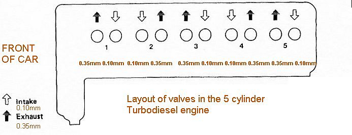

Here is a handy graphic to print and use while adjusting.

Do not rush. Rushing leads to things like forgetting to tighten a valve nut or using the wrong lash clearance. The first time will probably take 2-3 hours and USE the printout to mark off when you finish a valve.

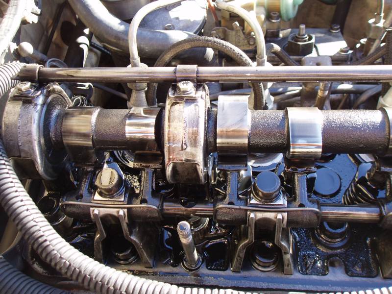

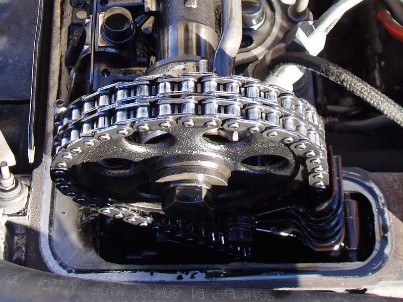

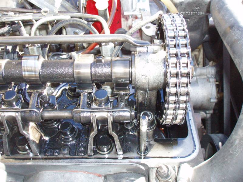

This is what my engine looks like inside with 2,811 miles on 9qts of Mobil Delvac1 (~20,000miles total on full synthetic). I didn't clean or wipe off anything before taking these pictures (except the smudge on the 8th lobe).
