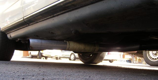

RE: Sound deadening. - ForcedInduction - 03-28-2011
I installed 2 layers of the Frost King insulation to the passenger doors and it made a huge difference in resonation with the shorty exhaust.
(Sorry, no pictures of the insulation itself.)
RE: Sound deadening. - Captain America - 03-28-2011
Oh man, I would flatten that exhaust on something in about three seconds...
RE: Sound deadening. - garage - 03-28-2011
I thought the same thing hahaha
Nah. Its scraped a few high driveway entrances but it doesn't rattle on the body or catch speedbumps. I did weld the coupler rings to the pipe to keep everything in line.
RE: Sound deadening. - Captain America - 03-29-2011
Cool Cool. I'm just saying that since I romp the car off road, I'd probly rip it off haha
