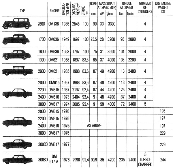

Engine Specifications - AzTraveller - 02-11-2009 This would be a good reference place to put the MFR specifications for the various engines used in this forum. To include MFR measurements such as Physical Length, Width, Height, Weight, HP, BHP, Idle RPM, Max RPM. Supported turbos (stock and alternatives). Supported trannys (manual and automatics). This knowledge would be extremely helpful for ALL swaps. RE: Engine Specifications - 1981300SD - 02-14-2009 Dose anyone know what the stock turbos are? RE: Engine Specifications - ForcedInduction - 02-14-2009 Garrett T3 from 78-85 and KKK K26 from 83-85. There is more information here: http://www.superturbodiesel.com/std/vnt-vgt-and-wg-turbo-information-thread-t-235.html RE: Engine Specifications - ForcedInduction - 02-11-2010 Specs from Mercedes. 244kg= 538lbs |
