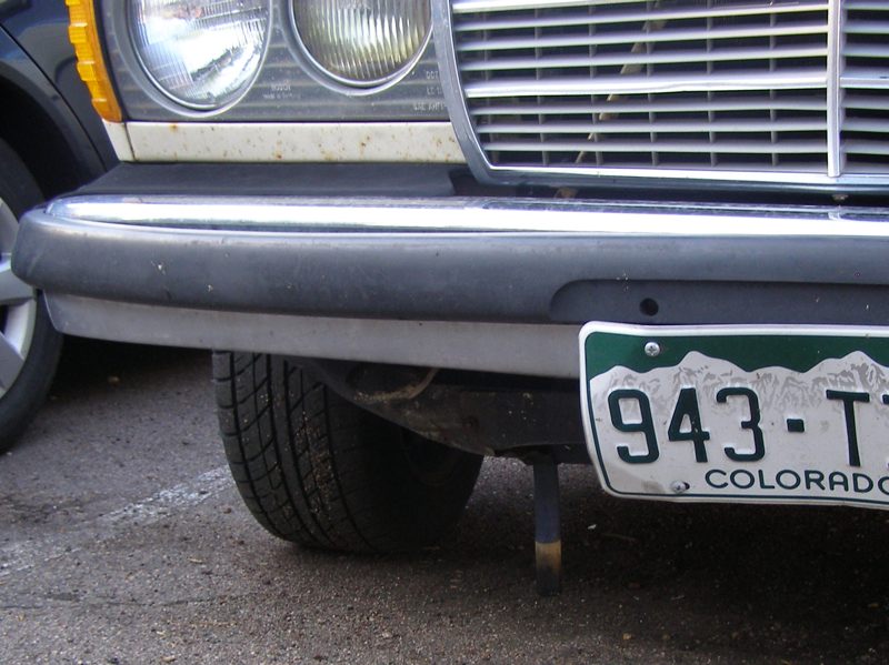

decision time - oil coolers necessary? - mr_manny - 03-23-2011 currently working on oil-lines, and have started wondering if the stock oil-cooler is really necessary? Other then reduced oil capacity...are there any other issues I may encounter in a non-autobahn continent? thanks, manny ![]() ![]() RE: decision time - oil coolers necessary? - aaa - 03-23-2011 There were factory euro 240d's that didn't come with it. RE: decision time - oil coolers necessary? - yankneck696 - 03-23-2011 With the turbo, I would keep it. Cheap insurance for a pricey project you have there. Ed RE: decision time - oil coolers necessary? - ForcedInduction - 03-23-2011 (03-23-2011, 05:41 PM)mr_manny currently working on oil-lines, and have started wondering if the stock oil-cooler is really necessary? Absolutely. Oil is the primary cooling medium of the engine's pistons and lower half. RE: decision time - oil coolers necessary? - JTY - 03-26-2011 No doubt you need oil cooler, the bigger the better and please use cooler with thermostat RE: decision time - oil coolers necessary? - 300D50 - 03-26-2011 Cool oil keeps your pistons happy. ![]() RE: decision time - oil coolers necessary? - willbhere4u - 03-26-2011 and turbo happy! RE: decision time - oil coolers necessary? - ForcedInduction - 03-28-2011 The oil needs to be over 100*c to boil out moisture. RE: decision time - oil coolers necessary? - Captain America - 03-28-2011 (03-28-2011, 02:35 AM)ForcedInduction The oil needs to be over 100*c to boil out moisture. I can attribute to that! On that note... My 300 with the toasted head gasket (and hydro-locking #2 cylinder) One time after I cranked the water out of the glowplug hole and got her started, I went to get some lunch with a buddy. Pulled up to Jack in your ass and left the car running right in front of the door. CCV hose went straight to the ground and had a jet of steam (5/8" hose) coming out of it.... Some black lady said something like "Why is that car steaming so much?" My buddy replied with "Oh, that car is hydrogen powered..." She believed him! RE: decision time - oil coolers necessary? - ForcedInduction - 03-28-2011 Yeah, I get "whats that hose" quite a bit. I think the looks are worth it to keep oil out of the intake. RE: decision time - oil coolers necessary? - Captain America - 03-29-2011 Ahhh yes. With mine, I routed it to the drivers side between the lines right at the PS box and loosely secured it to the brake rod. It doesn't hang quite as low as yours RE: decision time - oil coolers necessary? - dieselboy - 03-29-2011 Mines on the drivers side down low too but I hardly ever get anything out of it. RE: decision time - oil coolers necessary? - mr_manny - 03-29-2011 Deleting the oil-cooler to provide for a Cleaner Install and eliminate potential oil leaks associated with lines/oil-cooler in the future. vs Benefits with turbo/motor longevity gained from the oil-cooler. keeping the cooler ![]() thanks for the replies... RE: decision time - oil coolers necessary? - mr_manny - 04-03-2011 oil cooler is back ![]() ![]() ![]() decided to run one of these from Earl's: http://www.summitracing.com/parts/EAR-81610ERL Oil Thermostat and some line routing/cleaning are all that remain for this issue ![]() RE: decision time - oil coolers necessary? - 4rnnr33 - 04-04-2011 (04-03-2011, 05:40 PM)mr_manny oil cooler is back where did you get the remote filter bracket (engine side) or is that a custom part? Im looking into doing the remote mount setup yours looks super clean RE: decision time - oil coolers necessary? - larsalan - 04-04-2011 you mean this part? http://www.superturbodiesel.com/std/thread-fs-custom-billet-oil-filter-relocation-plates RE: decision time - oil coolers necessary? - mr_manny - 04-04-2011 made the adapter out of 1/2 aluminum: http://www.superturbodiesel.com/std/thread-what-are-the-pros-and-cons-of-moving-altering-the-oil-thermostat-filter-housing?pid=22268#pid22268 @$25 I would have purchased one from 300D50...if they were available :p RE: decision time - oil coolers necessary? - 4rnnr33 - 04-04-2011 Yep thats exactly what I needed thanks What are you guys running for a thermostat just trying to decide which one to get RE: decision time - oil coolers necessary? - mr_manny - 04-05-2011 (04-04-2011, 03:10 PM)4rnnr33 Yep thats exactly what I needed thanks I'm going to be running this one: ![]() This Billet Style Cast Aluminum Fluid Control Thermostat with 1/2” NPT ports allows the oil to bypass the cooler until it reaches 180°F at which point the internal thermostatic valve closes allowing 95% of the oil through the cooler. This process allows the engine/transmission to achieve the ideal operating temperature quicker before passing the oil through the cooler. At temps below 180°F the valve is open, with 90% of the oil bypassing the cooler. The remaining 10% of the oil flows through the cooler, maintaining constant system pressure, preventing air pockets and eliminating cold oil shock. The unit can be rotated 180° to change flow direction. Perfrect for all-season climates Flow: 20 gpm Rated to 200 psi RE: decision time - oil coolers necessary? - 300D50 - 04-05-2011 I'd get a ~210 deg version, so the water can cook out. RE: decision time - oil coolers necessary? - 4rnnr33 - 04-05-2011 (04-05-2011, 01:14 PM)300D50 I'd get a ~210 deg version, so the water can cook out. Is there one available for a decent price? The only one Ive seen so far is the canton racing which is about $170 on summit and looks pretty overkill for what Im doing. RE: decision time - oil coolers necessary? - 300D50 - 04-05-2011 Haven't looked, I'll try and find the spec for the stock one. RE: decision time - oil coolers necessary? - Captain America - 04-05-2011 Cooking water is a must! RE: decision time - oil coolers necessary? - 4rnnr33 - 04-06-2011 The stock one must be around 180 because my oil temp gauge will barely hit 180 even after its plenty warmed up. Unless my stock thermostat isnt working properly? (04-05-2011, 03:08 PM)300D50 Haven't looked, I'll try and find the spec for the stock one. RE: decision time - oil coolers necessary? - 300D50 - 04-06-2011 Then I'd say go for it! ![]() |
