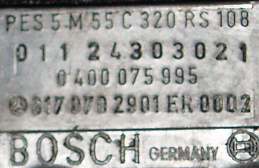

Does anyone know the Bosch part number for an M pump that will fit the 617? I searched but didn't find anything. (Yes I know that's no excuse, sorry!)

Here is the one on my m-pump, manual transmission.
