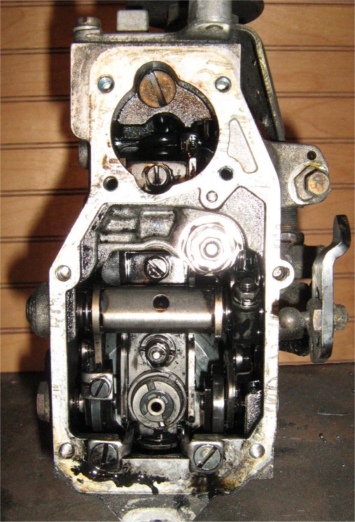

You need to take the back cover off the IP and rotate the top cover (or remove) so you can get into the top of it also. Then you just loosen the the nuts (9mm, 13mm, 19mm?) and push the limiter inside of the pump and dig out with a pen magnet.
From FI's post
Full Load Limiter Removal Procedure
An exhaust temperature gauge (pyrometer) is necessary for reliable long-term operation of the engine after this modification. Do not exceed 1250°F in continuous operation or 1400°F in short bursts (under 5 seconds). Do not use any kind of sealer on any of the gaskets.
1: Remove the oil-filter housing. This is optional, with a long screwdriver its very possible to adjust everything with the housing in place.
2: Remove the pump back plate including shut off actuator and rack damper.
3: Disconnect the vacuum device linkage and tubes. Remove the top lid screws, turn the top lid (or remove both the ALDA and top plate for best access).
4: Remove the limiter's screws and nuts.
[Image: aIPlimiternuts.jpg]
5: Push the limiter from the adjusting screw into the inside of the pump.
6: The hardest part is "digging" the limiter out of the bottom of the pump. A pen magnet is strongly suggested for this step. It can only exit through the thin slot on the top of the pump. You have two options- You can turn (rotate) the parts around inside the pump or you can punch out the guide pin the limiter used to slide on. The pin is no longer needed.
7: Once the limiter is out replace everything back in reverse order minus the limiter. Remember to use a new oil filter housing gasket and get the filter housing and block mating surfaces surgically clean. Be careful not to drop any gasket leftovers into an oil channel. If you get an oscillating idle this is a good place to replace the Rack Damper bolt with upgrade unit (upgraded one is gold anodized, the old silver in color) in the back plate of IP.
When you are done, you should have 5 or 6 parts left over (depending on the removal method you chose). DO NOT DISCARD THESE PARTS in case you decide to revert the operation at a later date.

Here is the picture of the rear of the pump with cover off.
Ok it worked picture is there. I do better with engines then computers. If someone can add the arrows to the right screws. I can write a discription of which ones are what, but arrows with labels would be better.
RE: Rack Limiter instructions - Captain America - 07-08-2011
I can do it later tonight or tomorrow. Or you could look at FI's pic and do your own Wink
