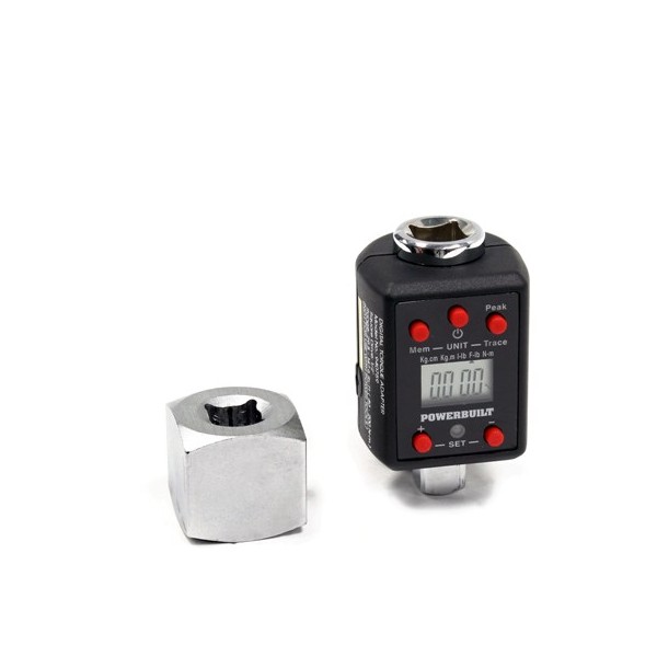

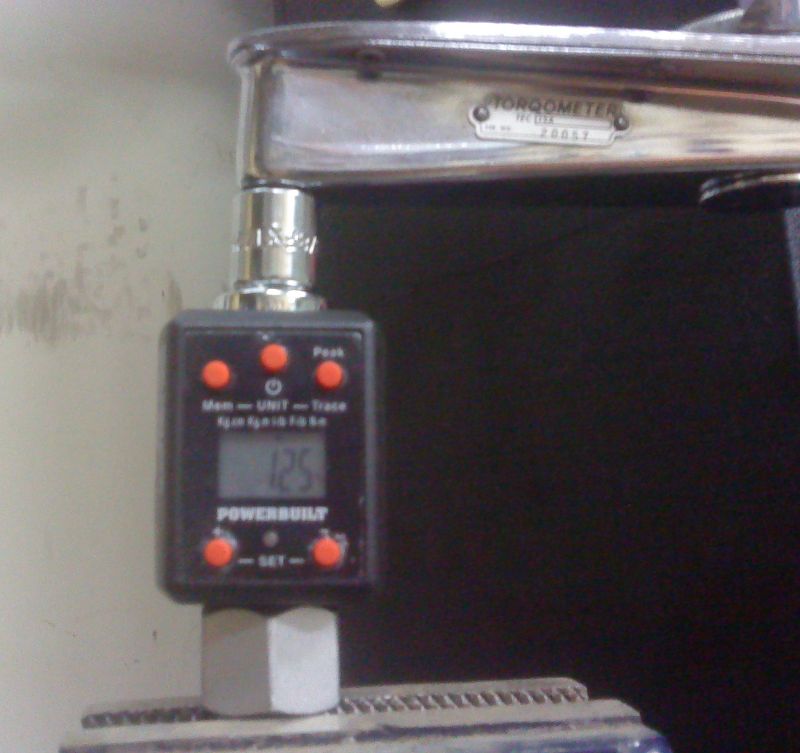

I had this Digital Torque Adapter for a while and yesterday it proved it's worth when I tested my buddy's cheap Harbor Freight Clicker torque wrench. At the setting of 50 ft-lbs, the torque adapter noted 53.4 for an error of 6.8% . At the setting of 80 ft-lbs the torque adapter noted 71.3 ft-lbs for an error of -10.88%. This wrench is going to the garbage.
My digital torque adapter is a Powerbuilt ½ drive unit from ALLTRADE tools based in Long Beach, CA. The calibration inspection paper of my unit states in March 2009 it had at the most a .3% error. I probably took this tool out three times to check the wrenches, so I'm pretty sure it still is calibrated correctly.
In comparison I decided to do some testing on one of my Snap On torque wrenches to see if it's true. Based on the past test using the torque adapter, my Snap On is off by less then 4%, which was acceptable to me.
Yesterday the Snap On at 50 ft-lbs it registered 52 ft-lbs, at 80 it registered 83 ft-lbs and at 120 it registered at 125 ft-lbs. That 125 is bit on the high side, I might need to send it in for calibration. Anybody know of a reputable cheap shop? If not, then I'll probably send it to Micro Precision Calibration in Garden Grove, CA.
I also checked my my Snap On Inch Pound dial wrench. It basically showed the same values in the past as it is off by 4 inch pound through the dial range. Luckly I can adjust the dial to make up for the deficit.
I don't own any stock on this company or sell this product, I just thought it is a useful tool to have.

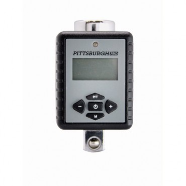

(09-17-2011, 09:36 AM)DeliveryValve I had this Digital Torque Adapter for a while and yesterday it proved it's worth when I tested my buddy's cheap Harbor Freight Clicker torque wrench. At the setting of 50 ft-lbs, the torque adapter noted 53.4 for an error of 6.8% . At the setting of 80 ft-lbs the torque adapter noted 71.3 ft-lbs for an error of -10.88%. This wrench is going to the garbage.
I bought the HF version of this for $29 last night. Its minimum is 40NM but I was able to verify that my HF click torque wrench is under 4% of error at 40NM. I was VERY surprised Big Grin. Need to test my 3/8" but couldnt find the adapter.
Very similar to the Powerbuilt unit I posted.
http://www.harborfreight.com/digital-torue-adapter-68283.html
4% error on your clicker is good in my book. You'll need to test the HF wrench out in the higher range which I bet you'll find a bigger error like I found. After testing my buddy's wrench, I did some research and found most people are saying the HF clicker wrenches last only for a few uses and the calibration goes off. The calibration companies don't want to calibrate them because they are not worth it. So they are consider a couple time use throw away wrench.
