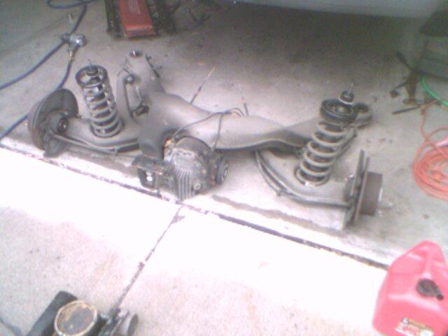

w126 rear diff options - willbhere4u - 10-06-2011 The rear diff in my1987 300sdl is going out I think? It's make bad clunking noises while turning I'm also converting it to a 6spd manual I will have 5 normal range gears and one over drive gears so I would like a taller rear end ratio to use the extra gears and increase my top speed Currently it has a 2.88 rear end I would like a 2.47-260ish rear end and I would also like to find out what the ASD is or if there are any LSD options and what they came in so I can keep my eye out for one at the pick and pull yards RE: w126 rear diff options - DeliveryValve - 10-06-2011 w126 2nd Generation Years, Model, Engine, Differential Ratio, Differential Case Size, Ring Gear Size 1989-1991, 300 SE, M103.981 3.0L I6, 3.46, 1 Liter, 185mm 1988-1991, 300 SEL, M103.981 3.0L I6, 3.46, 1 Lite, 185mm 1986-1987, 300 SDL, OM603.961 3.0L I6, 2.88, 1.1 Liter, 185mm 1991, 350 SD, OM603.97 3.5L I6, 2.82, 1.3 Liter, 210mm 1990-1991, 350 SDL, OM603.97 3.5L I6, 2.82, 1.3 Liter, 210mm 1986-1991, 420 SEL, M116.965 4.2L V8, 2.47, 1.3 Liter, 210mm 1986-1991, 560 SEL, M117.968 5.6L V8, 2.47 ASR/2.47 LSD/2.47, 1.3 Liter, 210mm 1986-1991, 560 SEC, M117.968 5.6L V8, 2.47 ASR/2.47 LSD/2.47, 1.3 Liter, 210mm . RE: w126 rear diff options - willbhere4u - 10-06-2011 Is the ASR a full time LSD or is it electronically locking? I read somewhere there was some wiring involved is converting this over? What has to be changed to swap the 210mm diff in to an older w126? is it as easy as swamping the whole rear sub frame/axles? RE: w126 rear diff options - DeliveryValve - 10-06-2011 (10-06-2011, 11:29 AM)willbhere4u Is the ASR a full time LSD or is it electronically locking? I read somewhere there was some wiring involved is converting this over? ASR is an OPEN differential. ARS only applies the brakes individually for traction control and applies the Anti-lock-Brake sequence in the ABS-system. See picture of how to identify a ASR diff. It has two wires coming out from the top of the diff case. I have not done this subframe swap, but I would assume it will bolt on. The only issue would be to install new anchor bolt holes for the relocation of the rear mount which now moves from the center mounting position to a an off center mounting position. See picture above. BTW - I have a 2nd Gen 2.47 LSD, you can have it for crazy dollars. ![]() . |
