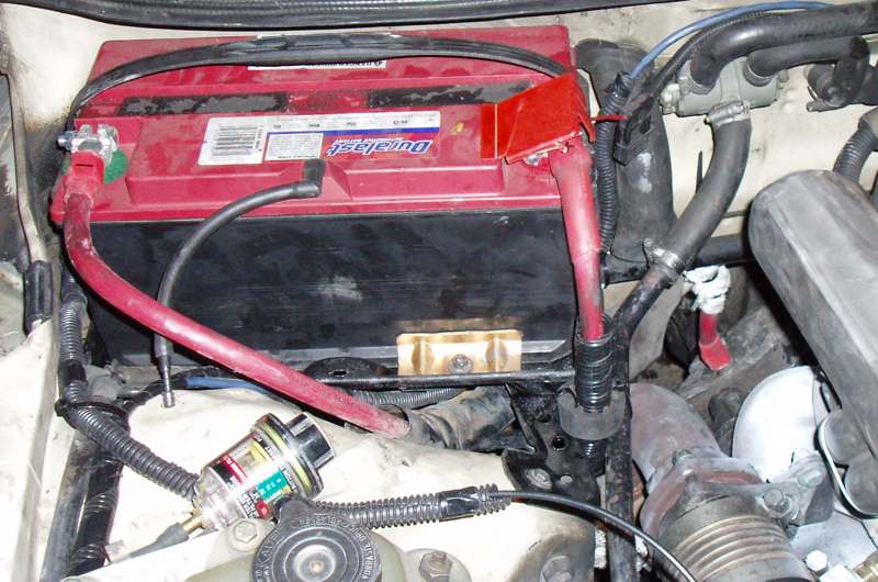

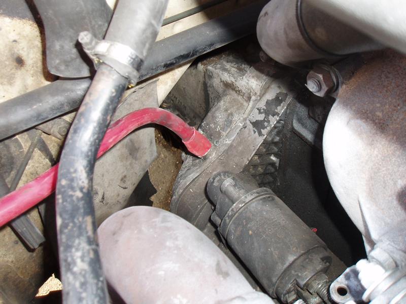

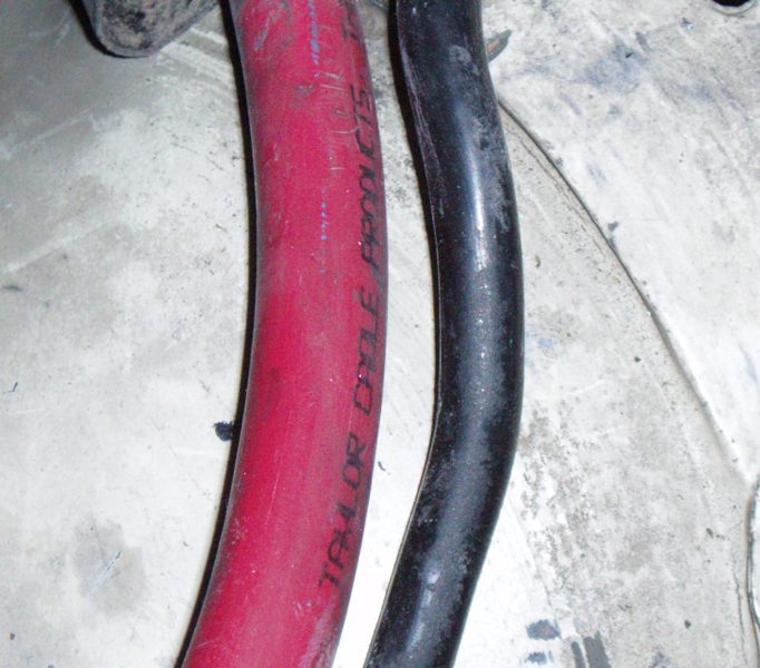

I've had some good 2/0 gauge battery cable taking up space in my toolbox for almost 2 years now. The wiring for the alternator needed to be redone (the wires were loose in their connectors) so I figured what the heck, I might as well do it since I'm there. I also took the time to remove the remnants of my A/C hoses and do some rust prevention for the battery tray and the area under it.
[attachment=1]<!-- ia1 -->LMN 0-2 battery cables compare.jpg<!-- ia1 -->[/attachment]
[attachment=3]<!-- ia3 -->LMN 0-2 battery cables ground.jpg<!-- ia3 -->[/attachment]
[attachment=0]<!-- ia0 -->LMN 0-2 battery cables done.jpg<!-- ia0 -->[/attachment]

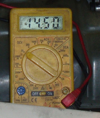

I know its massive overkill and the starter is still limited by the small-ish jumper from the relay to the motor, but $free is hard to beat on a Sunday with nothing better to do. Starting is a little quicker and the voltage at idle stays steady at 14.5v.
[attachment=2]<!-- ia2 -->LMN 0-2 battery cables idle volts.jpg<!-- ia2 -->[/attachment]
