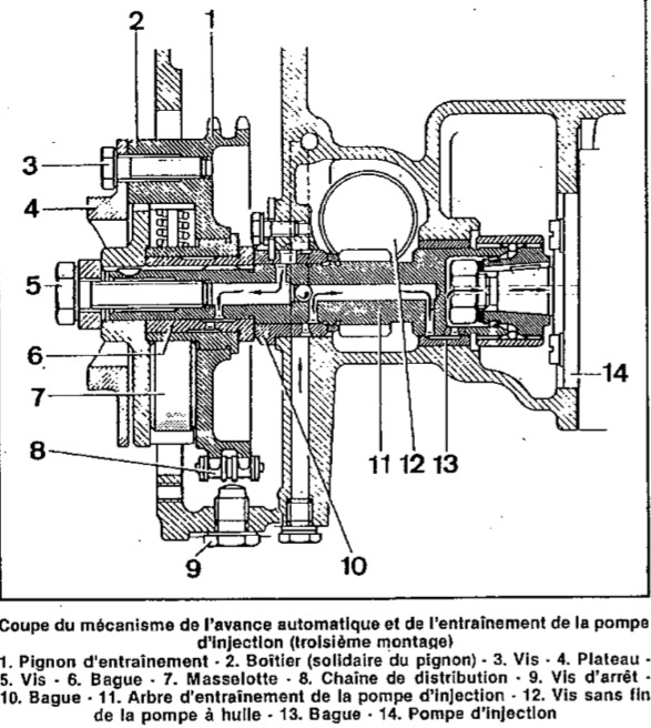

M-pump oil supply - ForcedInduction - 05-11-2009 The MW has the black hose running from the timing sprocket shaft bearing supply to the left side of the pump. Where does the oil go into the M-pump? RE: M-pump oil supply - tomnik - 05-11-2009 (05-11-2009, 12:57 AM)ForcedInduction The MW has the black hose running from the timing sprocket shaft bearing supply to the left side of the pump. Where does the oil go into the M-pump? through the cam shaft. RE: M-pump oil supply - ForcedInduction - 05-11-2009 Ah, I see, the shaft is hollow. So when mounting the M-Pump I only need to block the MW's oil supply port with a normal metric bolt? RE: M-pump oil supply - tomnik - 05-11-2009 (05-11-2009, 06:42 AM)ForcedInduction Ah, I see, the shaft is hollow. Good question. I don't know how it looks like behind the vac pump but as there are M and MW on the 617 block I hope there is no further difference in the IP oil supply. I don't even know how the oil gets into the shaft. Tom RE: M-pump oil supply - ForcedInduction - 06-14-2009 I came across this while browsing a French 409D service manual. RE: M-pump oil supply - winmutt - 06-14-2009 Did they have a l408D manual by any chance? |
