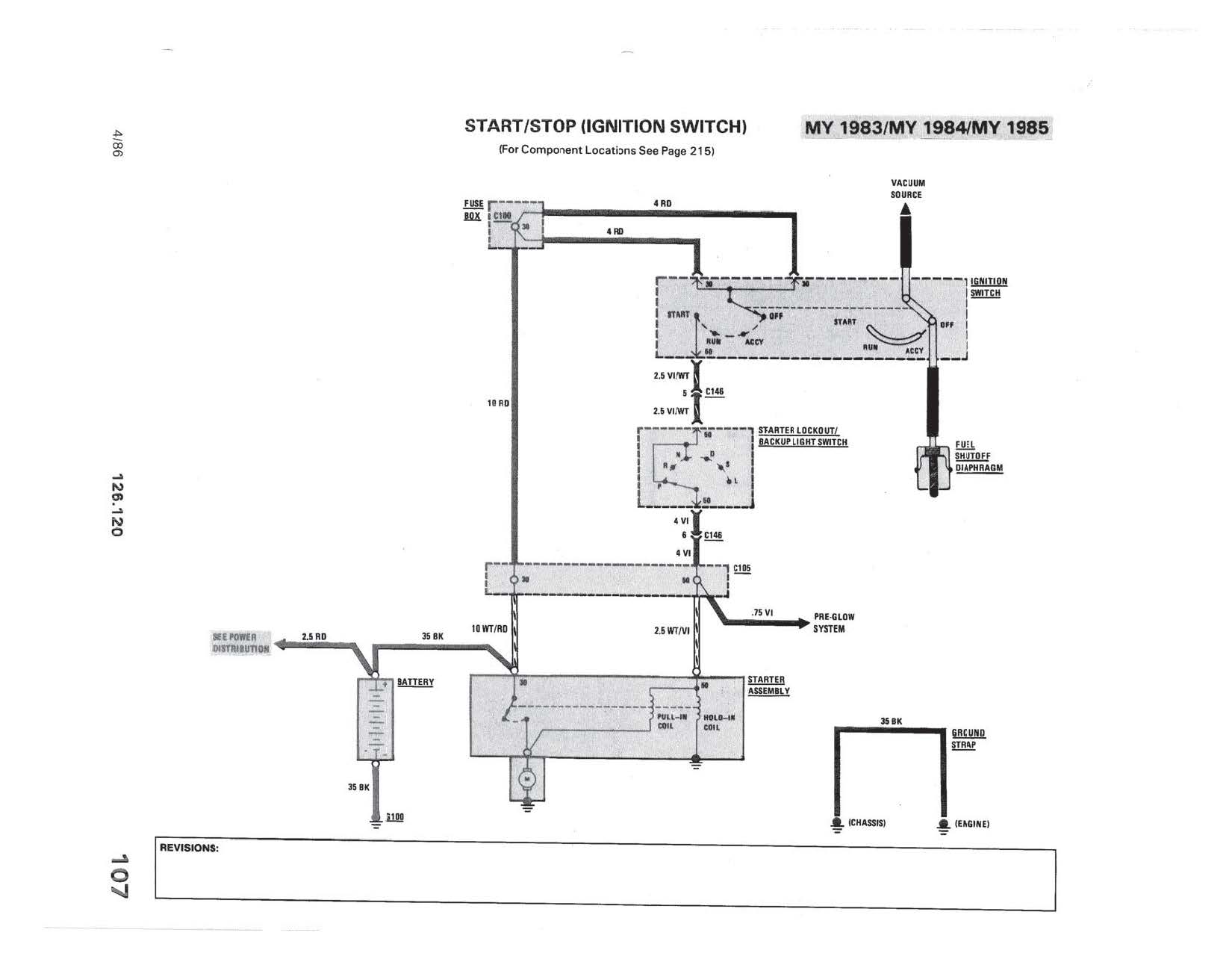

I went to go do some shopping the other day and hopped in and tried starting the car. You can the key to the start position but it feels like nothing is there. The key will not return from the start position as it should as well. I am sure that something inside the actual ignition switch is broken as I have the auxiliary positions working.
The planned solution at this time is to just wire in a starter button or switch to the existing circuit and just bypassing the key switch. I'm just needing help figuring out which wire or group of wires from the ignition switch control the starter.

Once your key is in the go position, you can jump the two wires on teh passenger fender-they're in a small plastic block. That will fire up the starter. I'd get something figures out long term though-it won't trigger the glow plugs this way. When my ignition died I did this:

What it seems like with whats going on with the car is that the actual ignition switch is broken internally. When you turn the key everything works as it should til you reach the start position with the key and it feels like nothing is there. Normally you can feel some sort of resistance when you go to start the car. This is not the case now.
I need to figure out what wire on the back of the ignition switch goes to the starting system so I can wire in a momentary on-off toggle switch in so I am able to start the car. ITs something I need to figured out as I am stuck driving my truck which gets 8-10 mpg vs the 24 that I get with the Benzo.

Let's see if I can figure out how to attach a pic and how clear I can keep it.
I'm guessing this is the '83 300SD in you profile. Right?

Yes its the 83 300sd in my profile. I see the attachment but its blurry.
RE: Turn key to start car but not getting juice to starter - waz - 07-14-2012
If you click on it, it should open a new window or tab and you should be able to zoom in on it.
