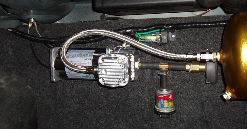

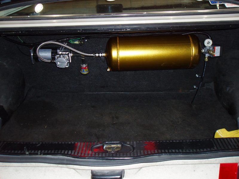

Horn performance - ForcedInduction - 11-02-2008 The tank is already mounted in the trunk and the horns are ready to install. I'm just waiting for the compressor so I can run new 3/8" hose to the tank and wire it up. As a side benefit I'll have 125psi onboard air for air tools and airing up tires (local stations charge 75c for air!) Re: Horn performance - Lapoint - 11-03-2008 What are you using for a compressor? Electric or engine driven? Re: Horn performance - ForcedInduction - 11-03-2008 A Viair 380C, electric. Its rated for 100% duty cycle at 100psi. Re: Horn performance - Lapoint - 11-03-2008 That's going to be a nice set-up. Probably won't be able to run a 1/2 inch air impact for very long but it will be way better than the 'armstrong' method! Re: Horn performance - ForcedInduction - 11-03-2008 I don't need a 1/2" gun for 81lb/ft of lug torque, thats why I'll get a 3/8" gun. ![]() Re: Horn performance - Lapoint - 11-03-2008 My wife's former cruiser was an Oldmobile with self-leveling rear air shocks. I was always tempted to plumb in an air tank, as you did, but I was afraid the scrawny air pump wouldn't last. It did put out adequate pressure though. Re: Horn performance - ForcedInduction - 12-03-2008 Everything is in and it works great! It sounds better in person, audio is not my camera's strong point. http://www.youtube.com/watch?v=eGBRO-xY1cY A light on the cluster tells me when the pump is on and both the pump and horns can be switched off using a DPST switch on the center console. I took the pressure switch off an old 2hp DeWalt compressor and enlarged the air passages between the ports. This switch lets me fine tune the on/off pressures and not cycle the main relay as often. I was hoping to set the pressure higher than 110psi but any more than that and the horn valve won't open! It was a battle, and not one I'd look forward to repeating, but now that its installed I'm happy with the results. RE: Horn performance - Gurkha - 03-16-2009 I use Stebel Nautilusx2, drains my battery but its loud nonetheless, for regular use, I have BOSCH Europas. RE: Horn performance - 300SD81 - 04-03-2009 I got my horns mounted and the air lines run. Just waiting to hit the pullapart tomorrow to get a wiring harness for the horn switch I grabbed last time. I have the switch mounted in the little tray infront of the shifter, looks stock. Pics tomorrow when the suns out. It was super loud unmounted, but it seems a bit weak now that its on the car, but maybe thats because I can only get 75psi at the local gas station. The free air back in Athens went up to 200... RE: Horn performance - ForcedInduction - 06-14-2009 I got the fanfare horns off the euro 380SEL for free! ![]() Does anyone know anything about this burly horn? It was in the engine bay of an 84 300SD. RE: Horn performance - ForcedInduction - 06-14-2009 Ah, the alarm horn. Does anybody have a video/sound clip of it? RE: Horn performance - ForcedInduction - 06-15-2009 The fanfare horns are DOA, both sound like a strangled duck. That 84 300SD may have a good engine, 3 of the 4 glowplugs I pulled from it were dead. |
