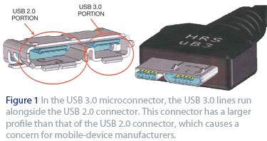

WTF proprietary USB Connection - Simpler=Better - 11-05-2012 Okay, WTF is this and when did it start? I'm looking into a nice portable 1TB drive for my lady, and all of the new WD/Seagate drives use this shitty proprietary shit. ![]() RE: WTF proprietary USB Connection - larsalan - 11-05-2012 Surely it is sata inside that case. Just buy the drive and case separate and you won't need to fuck with whatever stupid cord that is. Or maybe those stupid cords are on fleabay for a reasonable price. That is you best source for all that stuff ![]() direct from china ![]() RE: WTF proprietary USB Connection - Mark_M - 11-05-2012 Thats isnt USB in any form was it supposed to be or is it an ESATA? The other thing that Seagate does is sell a base unit and you add an adapter to whatever you want so it can be ESATA, USB Firewire or whatever. What is the model number. RE: WTF proprietary USB Connection - Purplecomputer - 11-05-2012 Its USB 3.0, not a proprietary connection. (11-05-2012, 06:44 PM)Mark_M Thats isnt USB in any form was it supposed to be or is it an ESATA? The other thing that Seagate does is sell a base unit and you add an adapter to whatever you want so it can be ESATA, USB Firewire or whatever. What is the model number. it is, its 3.0. It has a new form factor. usually the cable they provide is backwards comptatible with 2.0 but only on the computer side. and the drive you are referring to with the switchable docks is the "go flex" series. go to Microcenter/New egg and order a 3.0 PCI or PCI-e card. You will be happy with the speed results, of course your OS and other hardware arent bottlnecking bandwidth EDIT: taking another look, the male side that plugs into the HDD looks to be right, thats a micro USB 3.0 but the other male end that goes into the PC, now thats a little weird. If you get your hands on a standard Micro 3.0 Cable you should be able to use it with the PC no problem. RE: WTF proprietary USB Connection - Simpler=Better - 11-05-2012 Sorry to confuse, I'm talking about the one on the left. That's some guy's blog post comparing a new fangled wide ass USB to a good ol' miniUSB. Inside the drives are straight to USB. I could understand going to micro(the new standard on blackberries and shit) but to make a new fucking plug? goddamit it's supposed to be universal serial bus you fuckers. RE: WTF proprietary USB Connection - Purplecomputer - 11-05-2012 (11-05-2012, 10:07 PM)Simpler=Better Sorry to confuse, I'm talking about the one on the left. That's some guy's blog post comparing a new fangled wide ass USB to a good ol' miniUSB. Now with all the USB 3.0 devices I have used, their typical square PC end where all the same, but the other end that goes into the devide were all new shapes and designs much like USB 2.0 today. All the Seagates that I have used that support 3.0 have that same connection the "micro 3.0" connection. Things change and so do plugs, cant do much about it RE: WTF proprietary USB Connection - Simpler=Better - 11-06-2012 Fuck it then, I'll get an enclosure and make my own. It wouldn't be a problem, except my other 4 externals are all mini and I'd like to maintain a standard. There is no goddamn reason to go to a new connector-mini/micro should be able to support the data transfer and power requirements just fine. ffffffffffffffffffffffffffffffffffffuuuuuuuuuuuuuuuuuuuuuuuuuuuuuuuuuuuuuuuuu /rant thanks for the input. I'll probably switch one day. RE: WTF proprietary USB Connection - Purplecomputer - 11-06-2012 (11-06-2012, 09:26 AM)Simpler=Better Fuck it then, I'll get an enclosure and make my own. It wouldn't be a problem, except my other 4 externals are all mini and I'd like to maintain a standard. I feel ya, no worries. cheaper that way too. RE: WTF proprietary USB Connection - larsalan - 11-06-2012 I thought I had heard a long time ago that 'usb 3.0' protocol was going to be implemented on them rj45 jacks. Like ethernet cords ya know? That would be convenient but I am not in charge of any of it ![]() To me it seems like those ethernet cords could do quite a lot with 8 wires in there. That usb is but 4. They wouldn't want people making their own cords ![]() RE: WTF proprietary USB Connection - RedDiesel - 02-08-2013 USB 2 plugs fit that port and works exactly the same. Nothing proprietary about either of those plugs. RE: WTF proprietary USB Connection - Simpler=Better - 02-15-2013 The guy on the left looks like Micro USB, but it's got a weird extension on the right. WTF is that all about? RE: WTF proprietary USB Connection - RedDiesel - 02-16-2013 USB 3.0 is nothing more than USB 2.0 with extra pins inside the "normal" A size plug and tag-ons to the B, mini and micro plugs because they can't fit extra pins inside. If you plug the other end of the cable into a USB2.0 port it will work exactly the same, just slower than it could with USB3.0 RE: WTF proprietary USB Connection - Simpler=Better - 02-16-2013 Thanks for the breakdown, but I have one more question: If I stick a good ol' microusb cable (labeled as 'usb 2.0 portion' in the pic) will it operate? |
