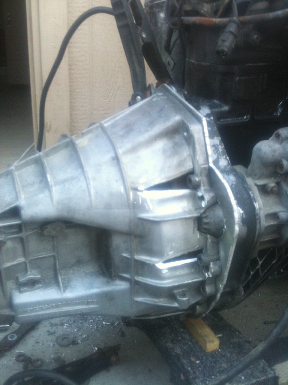

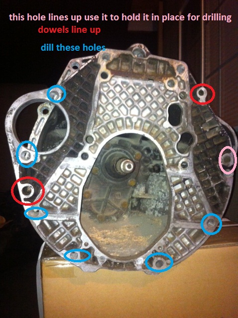

1st step
Is to clamp the stock Mercedes adapter to the trans as you will notice nothing lines up except the alignment pins.
2nd step
Is to drill through the adapter and through the transmission
3rd step
It to take a grinder and create clearance for the new bolts heads, i went and bought alien headed bolts that thread into the engine block.
4th step
You will need to cut the material out so that the starter fits in all the way.
i will post some pictures

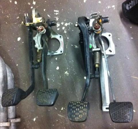

Here is a picture of a w123 pedal set L next to a w126 set R

(01-23-2013, 05:00 PM)willbhere4u Here is a picture of a w123 pedal set L next to a w126 set R
thanks for the pic

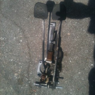

i ended up using the master cylinder and making a clutch peddle the stock assembly has the mounts for the master cylinder

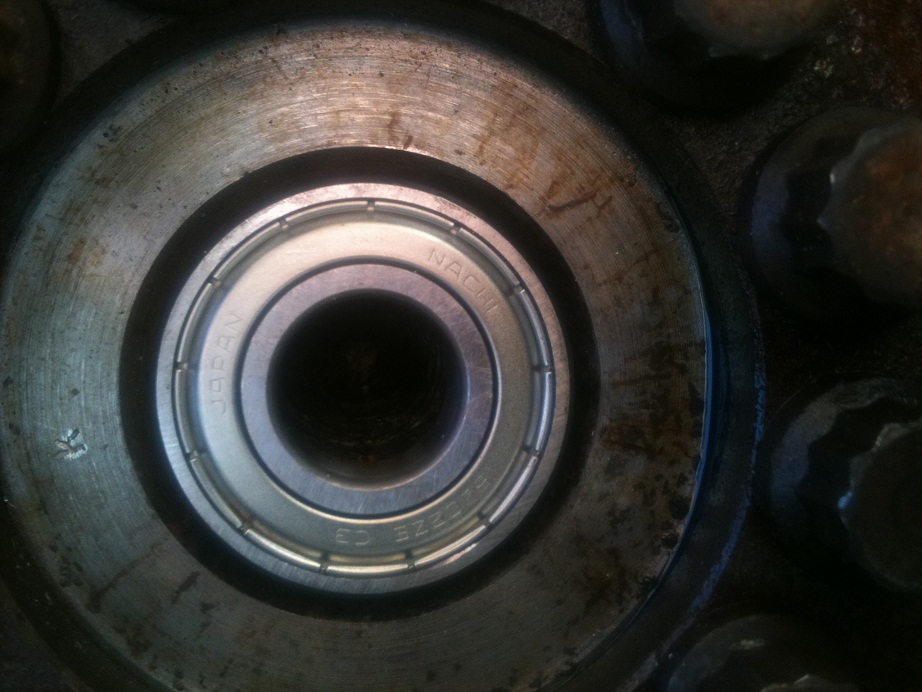

just to clarify a couple of things: the 2nd pic above appears to have a plate sandwiched between the adapter and trans case... looks like maybe 1/4" aluminium...is that the reason for the input shaft not quite reaching the pilot bearing?
also, did you end up getting a bolt in the top hole (just above top starter bolt) or did you leave that out? Edit: NVM, I see in the youtube vid that there is a bolt there...
This is actually quite an elegant solution overall...nice work!

to modify the peddle set i got a second brake peddle and also the i cut off the peace that it pivots on then i bought a bolt that fit inside the pivot (grade 8) and sandwiched it all together and then i welded and cut the peddle to attach to the master and then i lined it up with the break peddle. master cylinder bolts to the 126 set. and the break resvor has a nipple for the clutch master

4) the old starter hole is covered with the 3/16th plate the cutout in the bell housing for new starter is open.

So you used a 240D flywheel with a 717.411 5 speed, a double roller bearing to accommodate the shorter shaft, lengthen the shifting rods, and w201 drive shafts?

RE: 5 speed manual om617 - 5spd617 - 03-26-2014
(02-03-2014, 12:46 PM)MFSuper90 What flywheel? 240D then that double roller bearing?
yes 240 flywheel 240 pressure plate(you can also use pressure plate off transmission) double roller bearing and the clutch disk for the trans. make sure the disk is the same diameter of 240 disk.

Correct me if I'm wrong here, but is it accurate that you had to use the double roller bearing because of your additional adapter plate? Couldn't you instead grind the thickness of the additional adapter plate off of the adapter plate that came with the engine to make that part simpler?
RE: 5 speed manual om617 - sassparilla_kid - 03-28-2014
There was no additional adapter plate, he just drilled a new set of holes in the existing mounting plate

What exactly is a double roller bearing? How long is it compared to the stock Pilot bearing?
Is it longer because the Input Shaft on the trans is a bit shorter on the 5-spd compared to the 240D 4-spd?

Fred do you have a part number for the double roller bearing?
