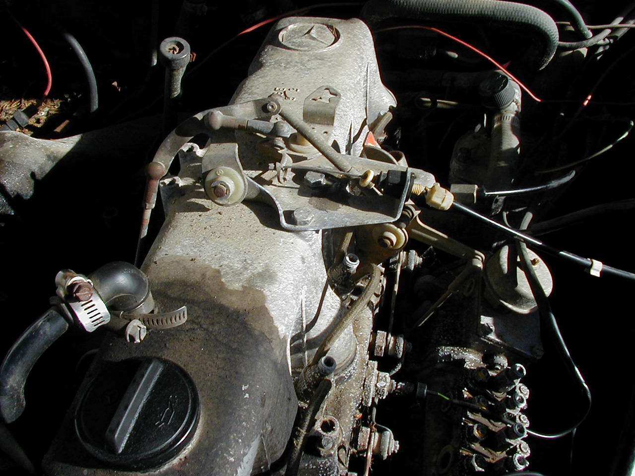

Pictures:

Wow...it appears so...shockingly straightforward...
That rod which extends down the starboard side of the valve cover...is that for transmission kickdown?
Is the linkage shown in the pics, available?

Rod is for the non turbo throttle body, yes it is available. I am parting out the whole car. It does also have a passenger side york A/C pump and bracket. Transmission down shift should be a electric switch under the throttle pedal.

That's an MW linkage.

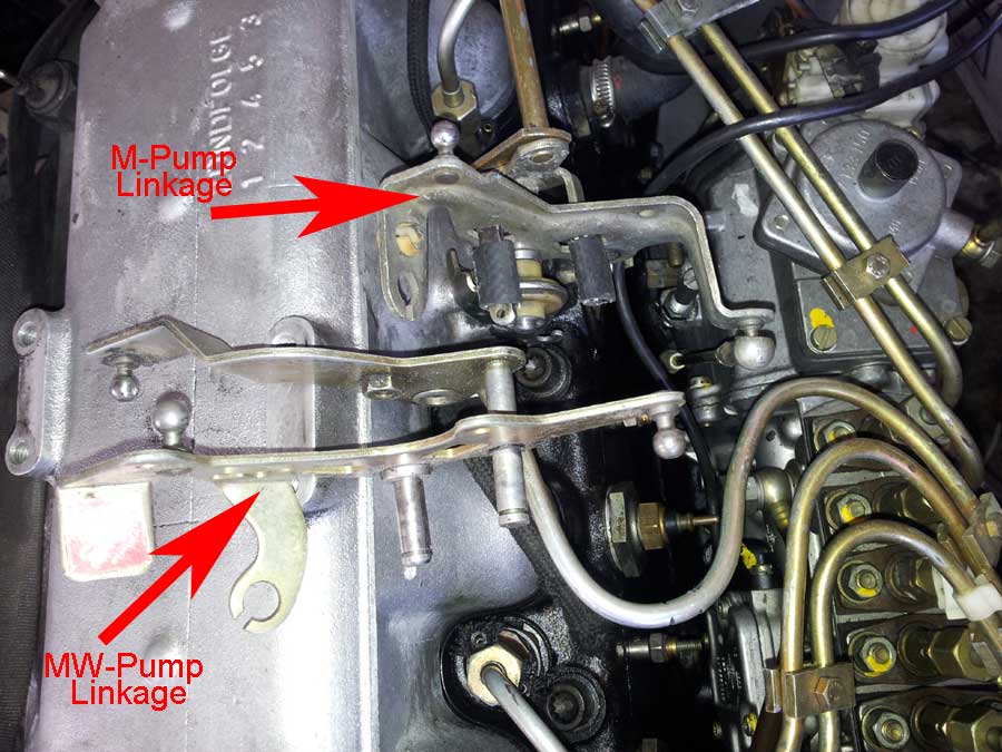

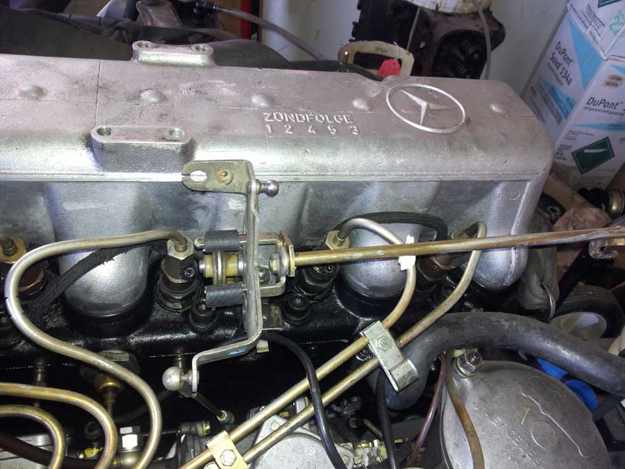

Here is a pic of my M-Pump linkage on an engine with a MW-pump it's missing a couple of bushings where the fork goes through. The setup is very simple for a Manual Trans.
I'd sell you all this, but then I wouldn't have one for my own M-pump.

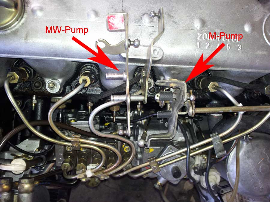

Here is the linkage comparing the MW-Pump pivot linkage. Notice the M-Pump pivot linkage is forward a bit compared to the MW.
Here it is on a car with a Manual Trans, no emissions equipment and with idle control.

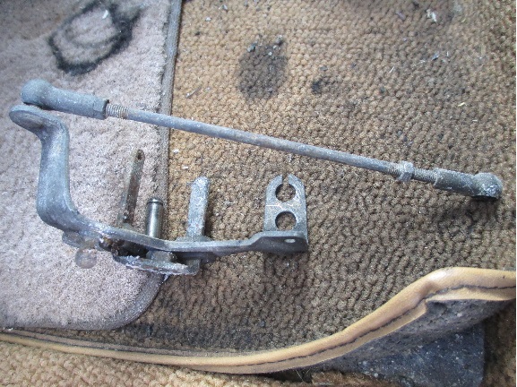

Well I found this. I wish the guy had the shaft too but didn't. He also had 3 of 5 hardlines. I let him keep those and told him to yell at the guy who left only half the stuff. Who takes only 2 fuel lines what the heck.
