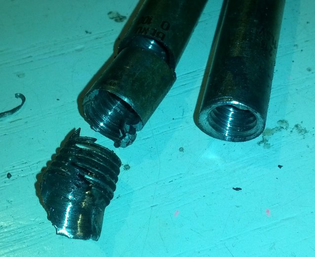

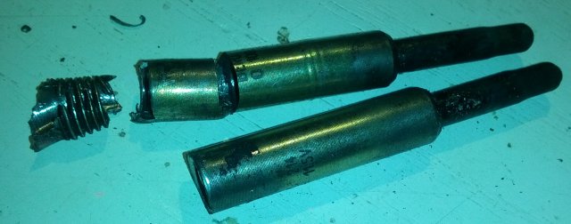

Broken GlowPlug OM606 - olefejer - 03-31-2013 Hi Just removed 2 glowplus from my OM606 There is a great guide here https://sites.google.com/site/alanmcreynolds/howtoremovebrokenglowplugs-mercedesom606 But regarding using Ø4 drill and M5 Tread not worked for me. Meaby it was as i had the BERU in Thats why i used Ø7 drill and made a 30 mm long M8 and then it got out GREAT :-) RE: Broken GlowPlug OM606 - Simpler=Better - 03-31-2013 I'm recommending a chasing tap, Bosch glowplugs, and dielectric grease to my friend with a new 606 Glad to hear you got it out RE: Broken GlowPlug OM606 - Druk - 04-01-2013 I've gotten all my gloplugs out without a problem but wondered if it would be good to put a drill through the glo diameter (ie not the thread) to clear out any build-up of carbon before I put them back. Any thought on this please? 606.962 engine. . RE: Broken GlowPlug OM606 - HaavardPYA - 04-01-2013 I drilled a hole and tapped in an big torx. Worked worked very well ![]() RE: Broken GlowPlug OM606 - TheDon - 04-03-2013 (04-01-2013, 02:39 AM)Druk I've gotten all my gloplugs out without a problem but wondered if it would be good to put a drill through the glo diameter (ie not the thread) to clear out any build-up of carbon before I put them back. use an om606 glow plug reamer RE: Broken GlowPlug OM606 - fcp - 04-06-2013 How did you remove the electrode in the centre of the plug before drilling? I have a head on the bench with the same problem right now, with plug snapped off level and electrode protruding so I can't drill out. On another head I tried leveraging the electrode with vice grips, but just broke the electrode off level ![]() I was planning to use high-speed turbing grinder & 3mm carbide end mill to try to cut back electrode, but perhaps you have a better solution? RE: Broken GlowPlug OM606 - olefejer - 04-07-2013 (04-06-2013, 04:49 PM)fcp How did you remove the electrode in the centre of the plug before drilling? used a tool dont know the word :-) but one like this http://www.globalindustrial.com/g/tools/Pliers-Vise/Vise-Grip/k-tool-locking-pliers-95591 turned it clockwise and anticlockwise until it broke off in the button. Then you are free to make the thread and pull it out RE: Broken GlowPlug OM606 - SurfRodder - 04-24-2013 (04-07-2013, 09:08 AM)olefejer used a tool dont know the word :-)most people here call them "Vice Grips", the name brand of some of the better ones... |
