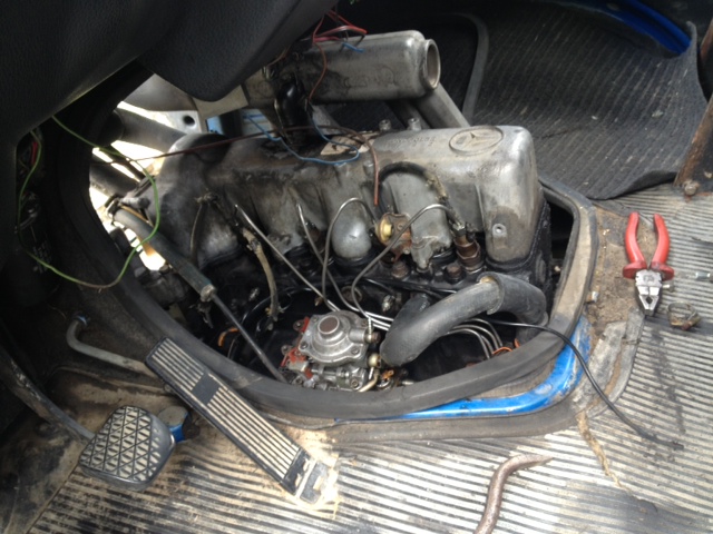

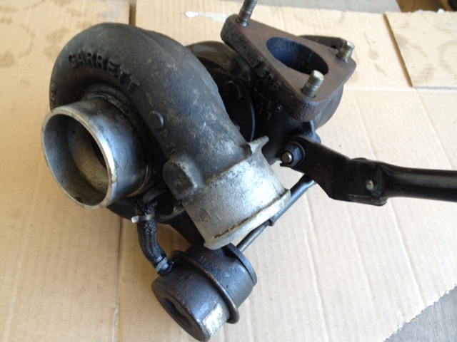

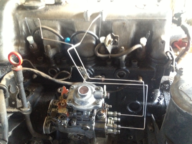

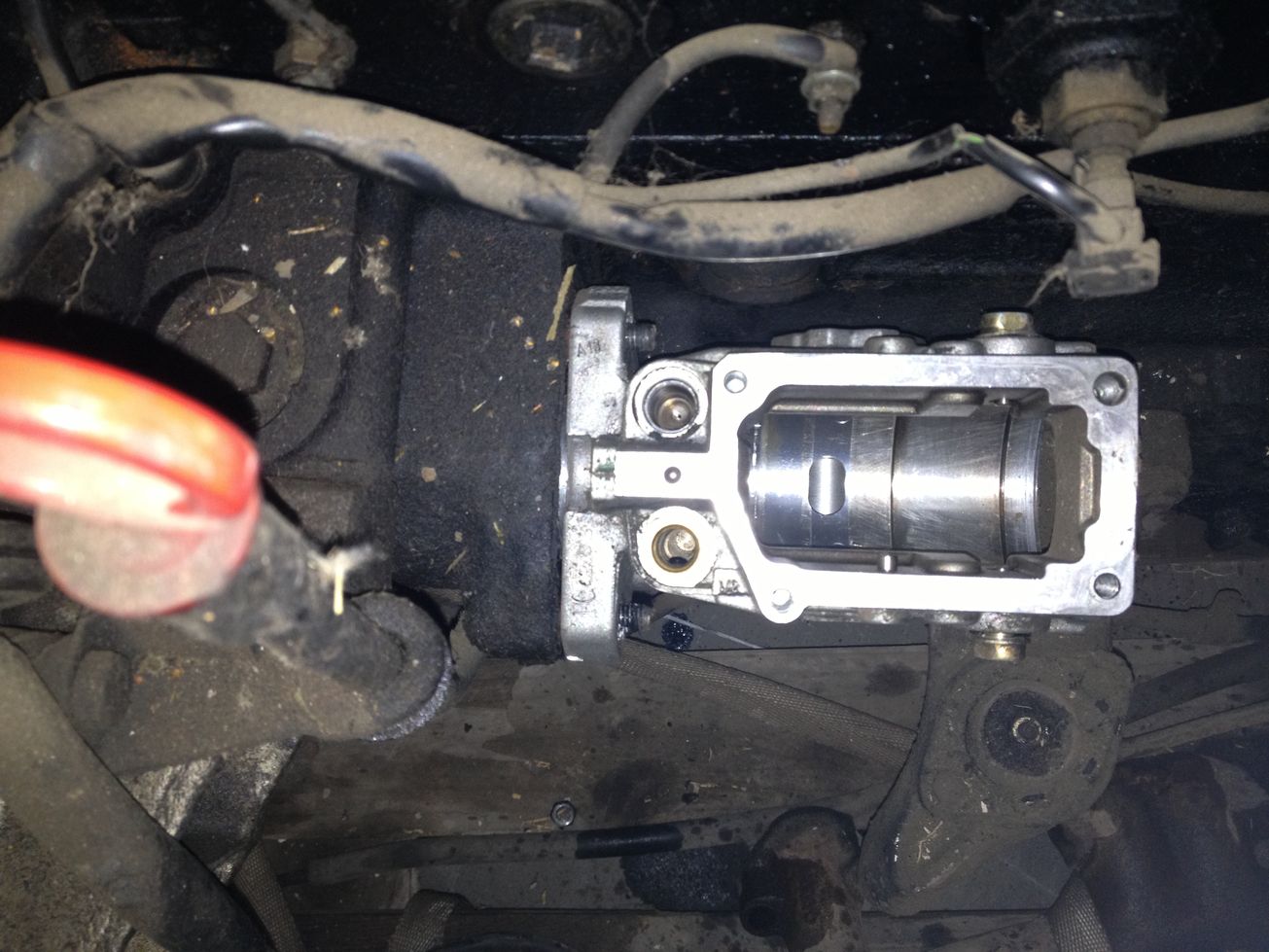

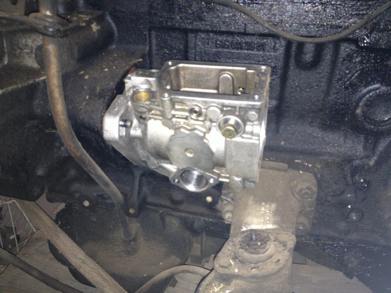

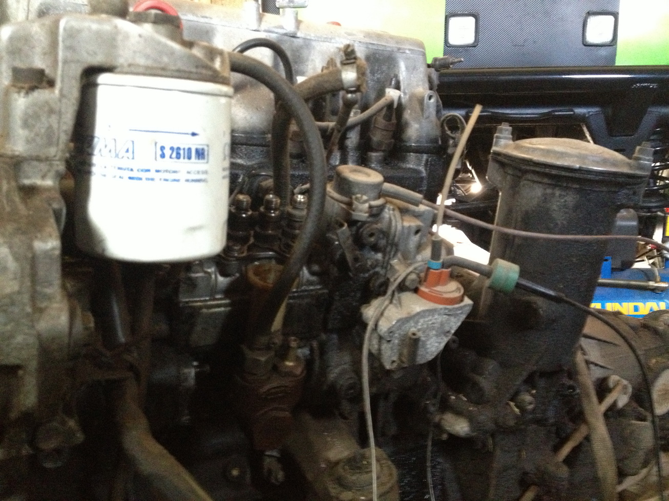

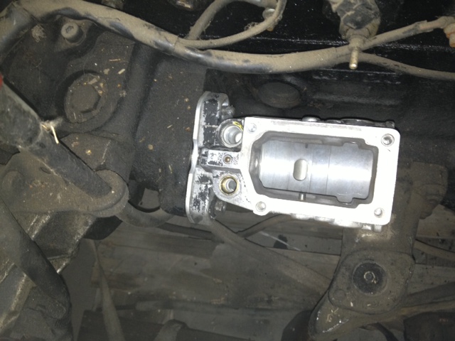

OM616 building with VE pump - offroaddieselhu - 04-28-2013

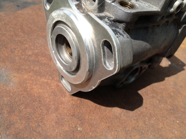

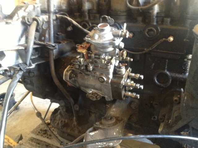

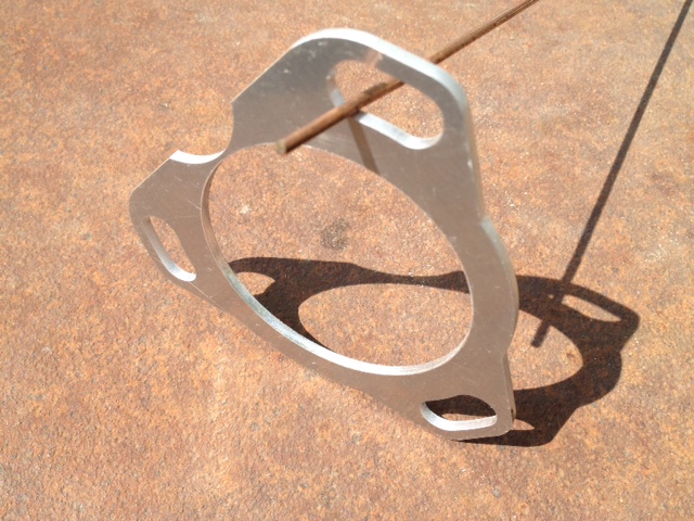

OM616 building with VEpump and turbo of OM602
VE pump

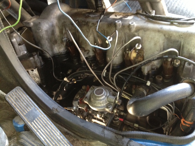

RE: OM616 building with VE pump - offroaddieselhu - 04-30-2013
It will be MB207 bus with sof turbo. Only with max 0.7 bar charge pressure. 10x2.3 pump. It is just to have bit greater torque,and to optimlizate the consumption. I would like to hold the consuption on the same lever, even if the engine is stronger.
MB 207
BOSCH VE

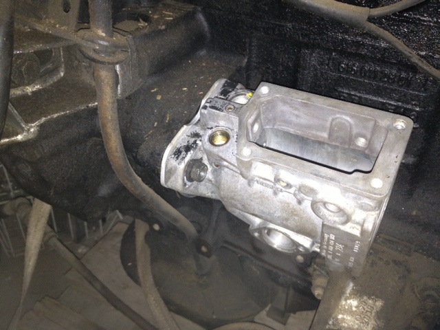

RE: OM616 building with VE pump - offroaddieselhu - 05-01-2013
I shuold pass to here the pump.
RE: OM616 building with VE pump - GeorgeHasmanda - 05-02-2013
From wich car is the VE pump?
RE: OM616 building with VE pump - offroaddieselhu - 05-02-2013
(05-02-2013, 10:49 AM)GeorgeHasmanda From wich car is the VE pump?
This is speceal pump from Bosch part. Builed 10 element. It is just for 100-120 HP.

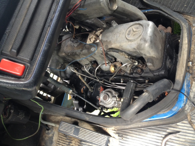

RE: OM616 building with VE pump - offroaddieselhu - 05-24-2013
work on OM616

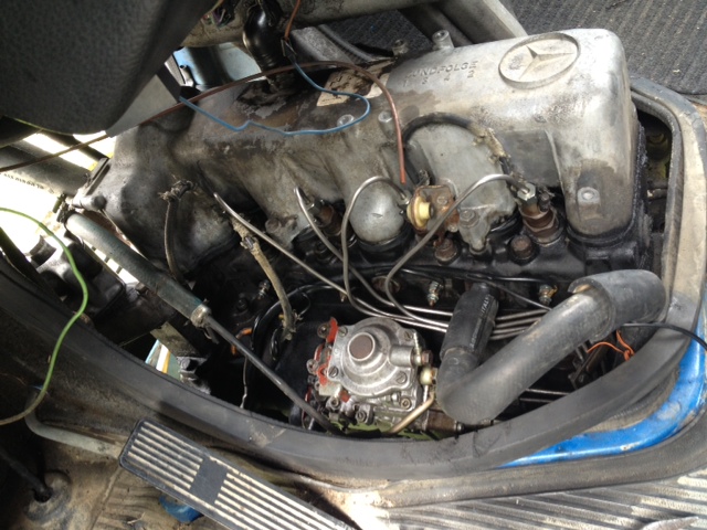

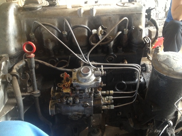

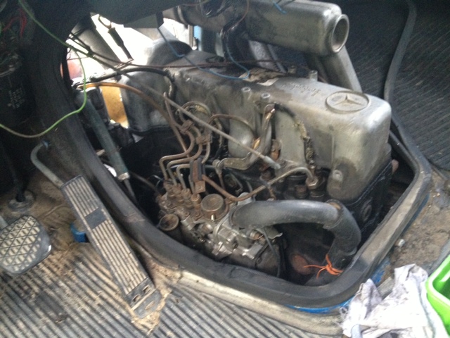

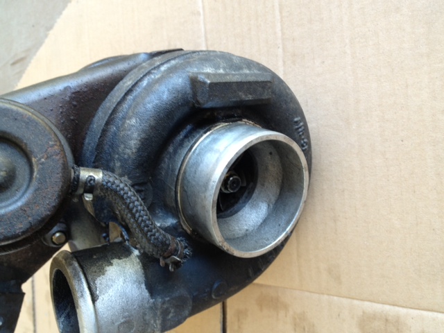

RE: OM616 building with VE pump - offroaddieselhu - 05-29-2013
The changes good in the car.
And now will come the next step: TURBO
RE: OM616 building with VE pump - Simpler=Better - 05-29-2013
The pump looks like it came there from the factory Smile
(05-29-2013, 07:41 AM)Simpler=Better The pump looks like it came there from the factory Smile
Thaks,
From mini factory Big Grin

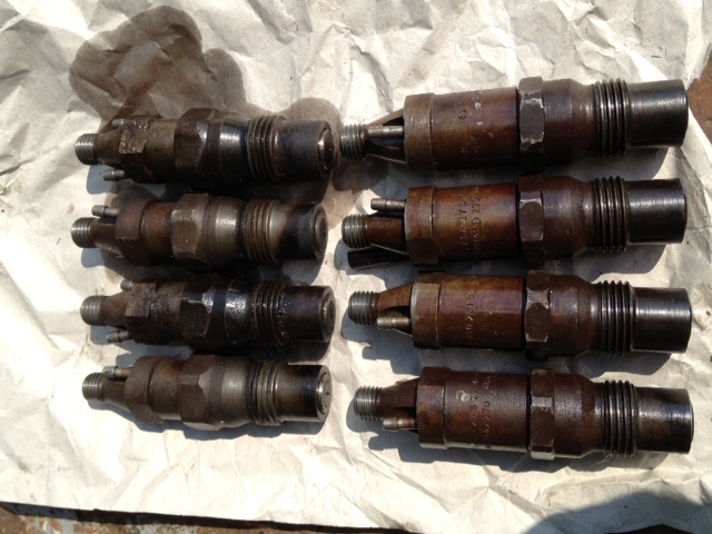

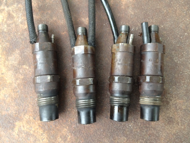

RE: OM616 building with VE pump - offroaddieselhu - 06-05-2013
"new" injektor
RE: OM616 building with VE pump - offroaddieselhu - 06-06-2013
(06-05-2013, 05:35 AM)offroaddieselhu "new" injektor
1.9 td vw
RE: OM616 building with VE pump - MFSuper90 - 06-06-2013
Are you only using the tips?
Or are the hole injector bodies the same?
What are the benefits?
(06-06-2013, 04:34 PM)MFSuper90 Are you only using the tips?
It's works quieter, better injection (spraying)

RE: OM616 building with VE pump - offroaddieselhu - 06-07-2013
(06-06-2013, 09:11 PM)MFSuper90 More power? I am looking to put injectors in my om617, but I am not sure which to choose
I don't know how it's works in inline pump, but it's works on 150 bar. The quantity maybe you can change but the preinjection will be lower. (but it will not be god probably.

RE: OM616 building with VE pump - OM616 - 06-10-2013
(06-07-2013, 05:16 AM)offroaddieselhu
Offroaddieselhu
The VW injectors require very fast delivery times in order operate both stages, the VE pumps have 10/12mm elements that can deliver the fuel fast enough to reach the secondary pop pressures.
With the 5.5mm elements in the inline pumps only the primary stage is being used. With 10mm elements they may be useable, but with 5.5 or 6mm they are not a good match.
RE: OM616 building with VE pump - offroaddieselhu - 06-10-2013
[/quote]
The VW basically this injector gos with 9mm element.

RE: OM616 building with VE pump - offroaddieselhu - 06-22-2013
Now we can strat to build the turbo project!
RE: OM616 building with VE pump - Kozuka - 06-23-2013
What collar are you using to put the VE pump to the chain drive sprocket (the om602 sprinter one?) and what VE pump are you using?
RE: OM616 building with VE pump - offroaddieselhu - 06-24-2013
(06-23-2013, 06:43 PM)Kozuka What collar are you using to put the VE pump to the chain drive sprocket (the om602 sprinter one?) and what VE pump are you using?
Hi,
I don't understand your problem. Please writte me exactly!
You can see on the photho my solution.
Offroaddieselhu
RE: OM616 building with VE pump - Kozuka - 06-24-2013
You know, the spline adapter that fits inside the engine and drives the pump. Which one did you use, where did you source it? Trying to figure out what's involved in a VE pump conversion.
Did you have to change the drive sprocket (that is driven by the engine timing chain) because of the automatic advance?
Why did you need a spacer for the pump to the block? Was your spline adapter too long?
Devils in the details, if someone wants to replicate this. Maybe me, the 5,000rpm limit doesn't bother me in my wagon. Possibly a cheaper way to sub-300hp. 12mm head, 3.3mm cam plate, VW rabbit governer spring, big injectors, & boost. Could be a fun project.
Pic of the adapter spline collar on an om602 VE pump 310-312D sprinter van.
[Image: k32v.jpg]
(06-24-2013, 10:51 AM)Kozuka You know, the spline adapter that fits inside the engine and drives the pump. Which one did you use, where did you source it? Trying to figure out what's involved in a VE pump conversion.
[Image: k32v.jpg]
I welded the automatic advance.
The thin-axis goes up to the old VE Pump Parts feeder wheel drive
Did you use the om602 sprinter spline adapter on the input shaft or do you have another source for them? That's the main hurdle to making this work state side is that rinky-dink spline adapter that they didn't sell here but they did in Europe. Almost willing to spend the $400 to get a whole pump for that little piece.
