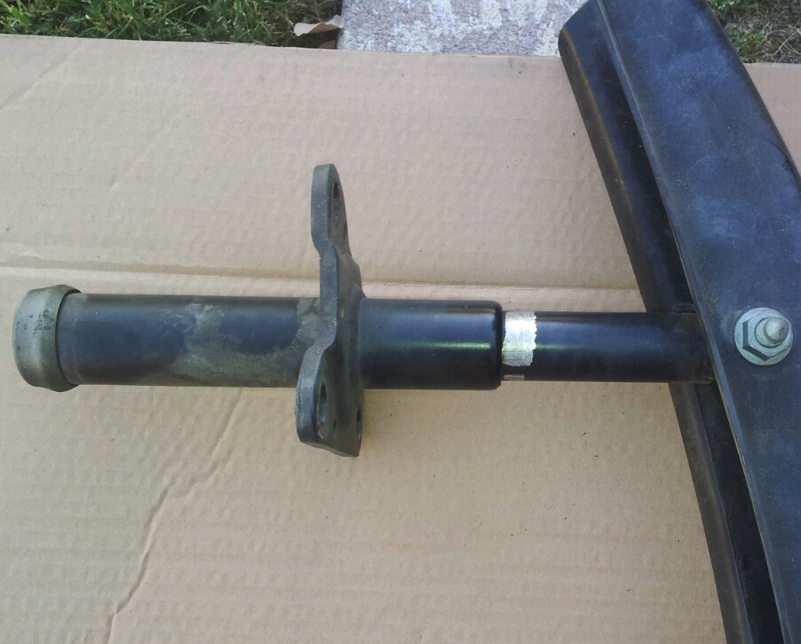

so ended up attaching the rear bumper. After thinking about it, since this is a 240, id like to retain those shocks I think.
Here is what I did to mount up after that tab was missing-
welded 3/16ths U's to the shocks, and bolted top and bottom
[Image: 0014_zps152c9da4.jpg]
[Image: 007_zpsb5ffddb6.jpg]
[Image: 008_zps9d57d1ad.jpg]
