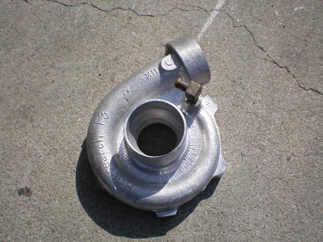

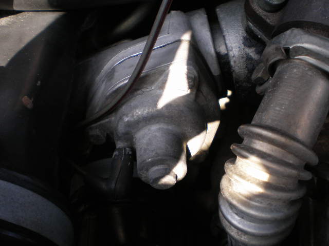

OK what is this device on the turbo of my '84 CD, I know one thing for sure is that I'm going to change it with the compressor housing from the '82 spare turbo.
RE: Turbo? - ForcedInduction - 07-09-2009
Air recirculation valve. It lowers boost pressure to force more exhaust into the intake.
Replace the air filter housing as well, the 84 has a more narrow airflow path to clear the ARV.
