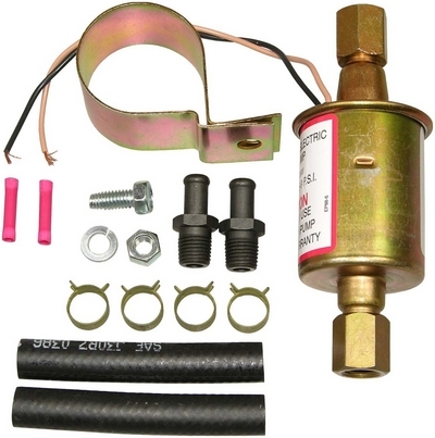

I was thinking, I have one of those "universal" fuel pumps. can i use this?
She needs the car probably by monday and the local auto part stores have the pump for about $80 while on the interwebz its around $30 and with the whole shipping aspect, the weekend, monday being a holiday. It probably wont leave the warehouse until tuesday and get here by the end of the week.

id order the right pump and give her a lift until you have it in hand. Gas application fuel pressure is gonna be a lot higher than old diesels. like 60-150psi even for older cars, let alone your gfs subaru.
That pump you show a pic of looks like a 6.5 diesel primer pump, pressure output is low, like 14-20psi max, plus those are not gas application fittings, gonna be restrictive and dangerous to boot. Save that sucker for your 240
However, first id verify the situation is in fact the fuel pump. Most every gasser has a fuel pressure test port in the engine bay, follow the fuel lines and look for the port that looks like a bike inner tube cap. Get a fuel pressure tester (maybe rentable at auto parts stores), and find out what the pump output is.
