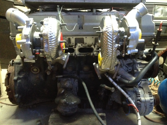

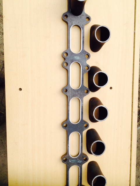

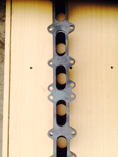

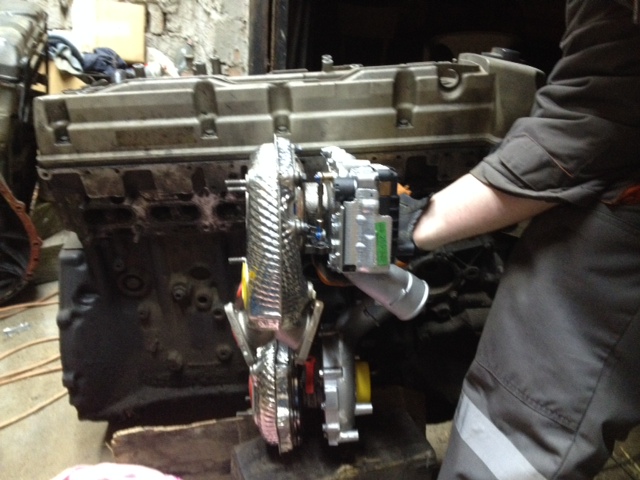

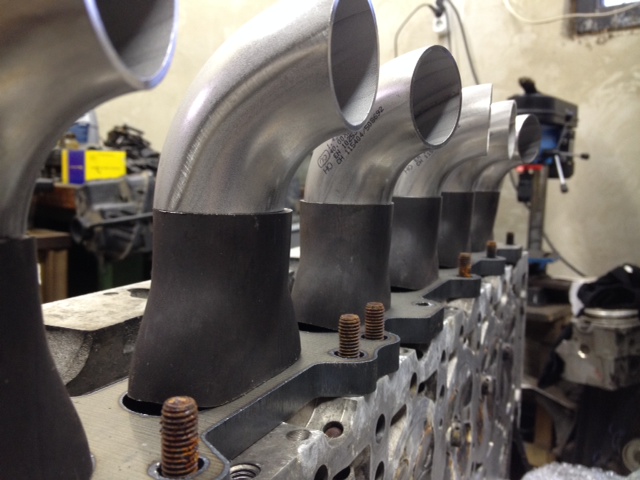

OM 606 building 4x4 bugy - offroaddieselhu - 01-21-2014 OM 606 building 4x4 bugy offroaddieselhu RE: OM 606 building 4x4 bugy - CRD4x4 - 01-21-2014 (01-21-2014, 03:14 PM)offroaddieselhu OM 606 building 4x4 bugy YES! Rock on!! Is it going to be a tube chassis? What's the end goal? Looking forward to pics when you have them! RE: OM 606 building 4x4 bugy - offroaddieselhu - 01-23-2014 Hi, It'll be tube chassis. I'll make only the engine for it. THe final goal 400+ Hp. Offroaddieselhu YES! Rock on!! Is it going to be a tube chassis? What's the end goal? Looking forward to pics when you have them! [/quote] RE: OM 606 building 4x4 bugy - pryantcc - 01-23-2014 Sounds very good! What's the plan for transmission? RE: OM 606 building 4x4 bugy - offroaddieselhu - 01-23-2014 (01-23-2014, 04:48 AM)pryantcc Sounds very good! What's the plan for transmission? Hi, 772.6 gearbox Offroaddieselhu RE: OM 606 building 4x4 bugy - offroaddieselhu - 03-03-2014 hi bi-turbó RE: OM 606 building 4x4 bugy - CRD4x4 - 03-04-2014 What turbos are you compounding? Is that larger one a variable geometry? Looking good! RE: OM 606 building 4x4 bugy - MFSuper90 - 03-04-2014 (03-04-2014, 08:04 AM)CRD4x4 What turbos are you compounding? It's offroaddieselhu, you ought to know better than to ask if it's variable or not ![]() I pretty sure everything he builds has a variable on it! ![]() RE: OM 606 building 4x4 bugy - offroaddieselhu - 03-04-2014 (03-04-2014, 09:55 AM)MFSuper90(03-04-2014, 08:04 AM)CRD4x4 What turbos are you compounding? ![]() offroaddieselhu 2 pcs gtb 2260 turbó offroaddieselhu RE: OM 606 building 4x4 bugy - offroaddieselhu - 03-22-2014 this is the basic http://www.youtube.com/watch?v=9HV-sd5nL2k&list=UUybiLRDnKgtuoh8itXs2hZQ offroaddieselhu RE: OM 606 building 4x4 bugy - offroaddieselhu - 03-26-2014 https://scontent-b-fra.xx.fbcdn.net/hphotos-ash4/t1.0-9/1477368_268922536617663_600849999_n.jpg offroaddieselhu RE: OM 606 building 4x4 bugy - CRD4x4 - 03-26-2014 Nice pipes! Did you make them yourself? Heat + BFH? What wall thickness? (03-26-2014, 07:01 AM)offroaddieselhu https://scontent-b-fra.xx.fbcdn.net/hphotos-ash4/t1.0-9/1477368_268922536617663_600849999_n.jpg RE: OM 606 building 4x4 bugy - GeorgeHasmanda - 03-26-2014 (03-22-2014, 03:43 PM)offroaddieselhu this is the basic http://www.youtube.com/watch?v=9HV-sd5nL2k&list=UUybiLRDnKgtuoh8itXs2hZQWhat timing do you use for VE pump? 15 ATDC? RE: OM 606 building 4x4 bugy - offroaddieselhu - 03-27-2014 (03-26-2014, 10:22 AM)CRD4x4 Nice pipes! Did you make them yourself? Heat + BFH? What wall thickness? These pipes are not the best but I will take better and I will send you more photos about the best version too. offroaddieselhu (03-26-2014, 05:51 PM)GeorgeHasmanda(03-22-2014, 03:43 PM)offroaddieselhu this is the basic http://www.youtube.com/watch?v=9HV-sd5nL2k&list=UUybiLRDnKgtuoh8itXs2hZQWhat timing do you use for VE pump? 15 ATDC? Hi, I've made this engine about 6 years ago. This is a socalled basic engine, that has 0.9-1 mm ATDC. If I'll make the new I'll messure the new setting and I'll writte you. Offroaddieselhu RE: OM 606 building 4x4 bugy - offroaddieselhu - 03-28-2014 Hi offroaddieselhu RE: OM 606 building 4x4 bugy - offroaddieselhu - 04-03-2014 hi exhaust RE: OM 606 building 4x4 bugy - offroaddieselhu - 04-13-2014 test http://www.youtube.com/watch?v=i7hwXNnAY2U offroaddieselhu RE: OM 606 building 4x4 bugy - offroaddieselhu - 04-15-2014 (04-13-2014, 03:51 PM)offroaddieselhu test 1000/ 90+ccm RE: OM 606 building 4x4 bugy - offroaddieselhu - 04-19-2014 i have cut offroaddieselhu RE: OM 606 building 4x4 bugy - sorin_cel - 04-21-2014 how have you shapped the oval pipes for the exhaust manifold? RE: OM 606 building 4x4 bugy - offroaddieselhu - 04-21-2014 (04-21-2014, 07:53 AM)sorin_cel how have you shapped the oval pipes for the exhaust manifold? hi, somebody made for me offroaddieselhu RE: OM 606 building 4x4 bugy - offroaddieselhu - 04-29-2014 hi new oval pipes offroaddieselhu RE: OM 606 building 4x4 bugy - offroaddieselhu - 04-17-2015 Hi offroaddieselhu RE: OM 606 building 4x4 bugy - offroaddieselhu - 04-17-2015 (04-17-2015, 03:39 PM)offroaddieselhu Hi RE: OM 606 building 4x4 bugy - mytmousemalibu - 04-18-2015 Where could I get those oval pieces in 304 stainless steel? Are there some bigger than the stock port size? I have fully ported my cylinder head and the exhaust ports are a fair bit larger than stock size. These transition pieces would save me a lot of added welding work. RE: OM 606 building 4x4 bugy - hents99 - 04-18-2015 We buy those cones from local hardware shop, it`s central heating pipe. It`s for connecting pipes with different diameter. I suggest to use 60,3-33,7mm cone. Cut smaller end to correct size and you get short cone. |
