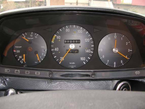

The OM615 is dimensionally the same as a 616 so the swap process would be the same, except a 200D should have a "Gorilla Knob" on the dash (Partially seen in the lower left of the first picture) to control the glowplugs and starter.

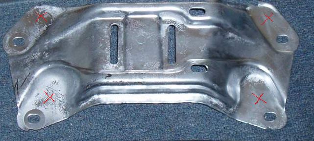

RE: W123 Engine Swap Questions - ForcedInduction - 07-21-2009
(07-21-2009, 04:37 AM)winmutt the 240d auto xmember is the right one, no holes required.
Not quite. The holes for the 240D auto and 300D manual are not in the same location.
This is a genuine 300D 4M crossmember, the 240D auto hole locations are marked in red.
RE: W123 Engine Swap Questions - winmutt - 07-21-2009
I'm pretty sure thats why the slots in the middle are so long....
