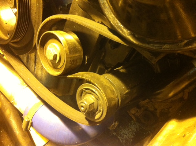

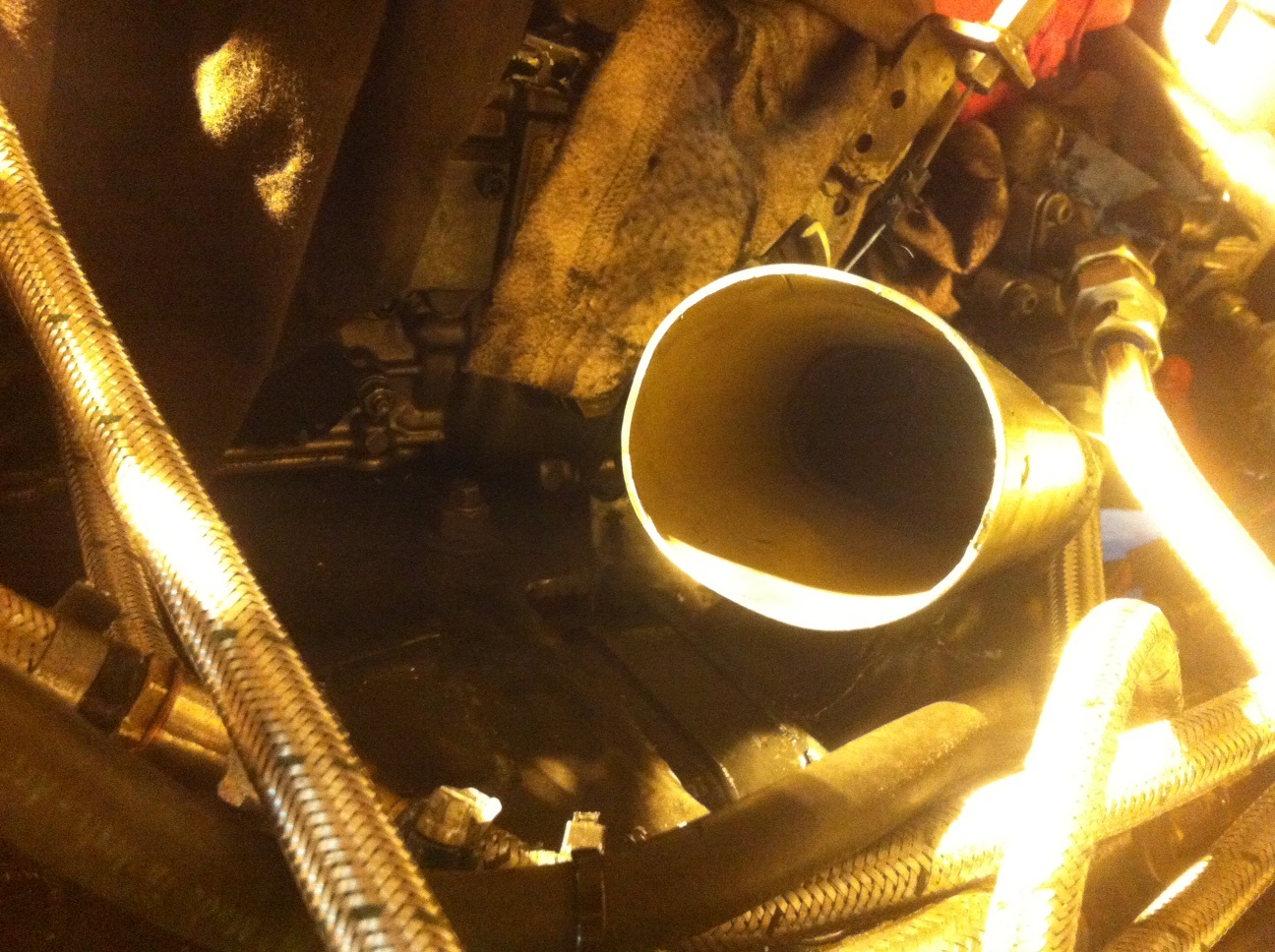

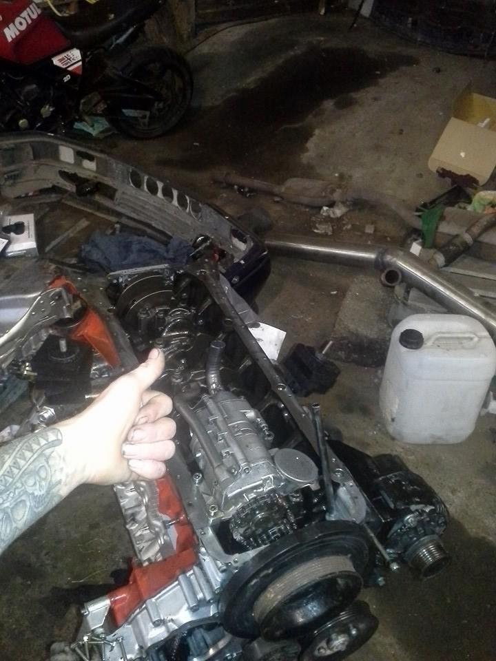

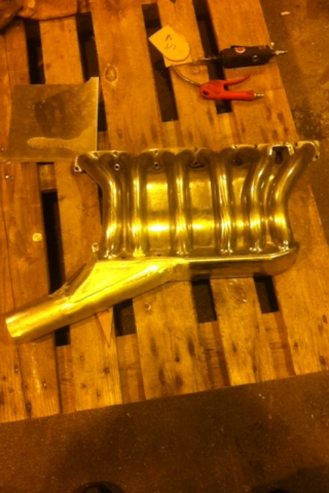

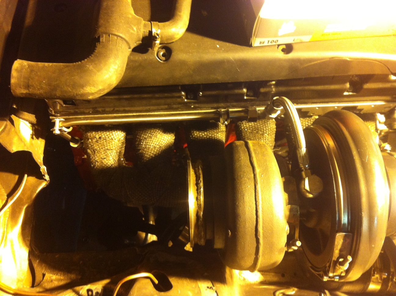

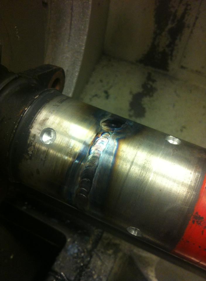

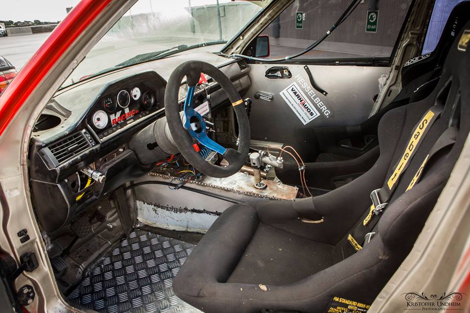

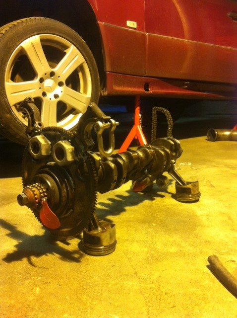

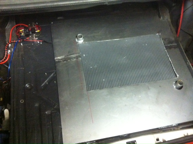

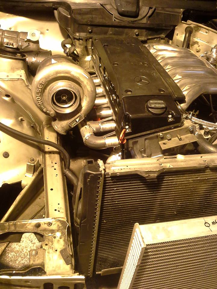

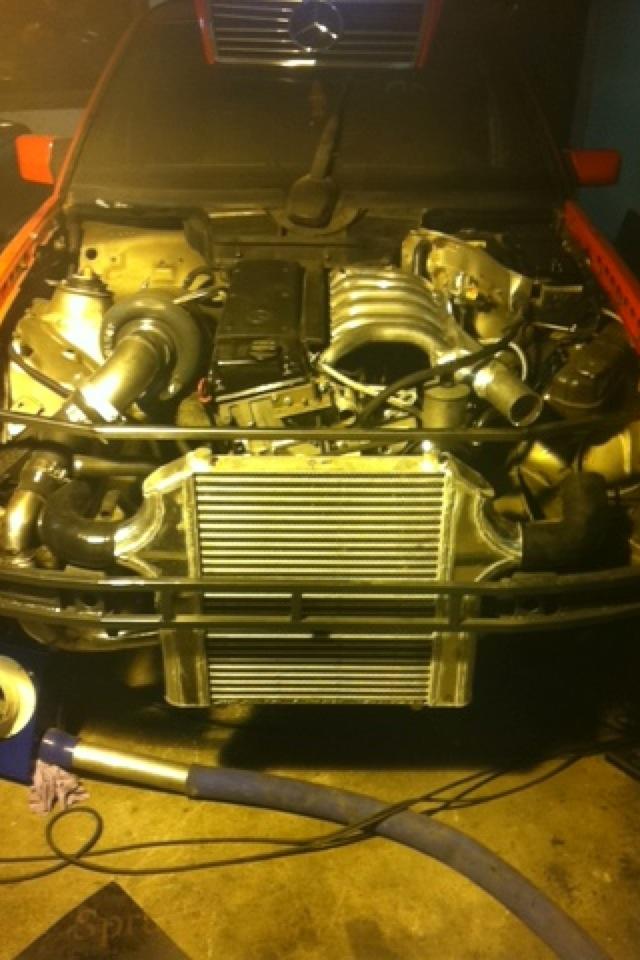

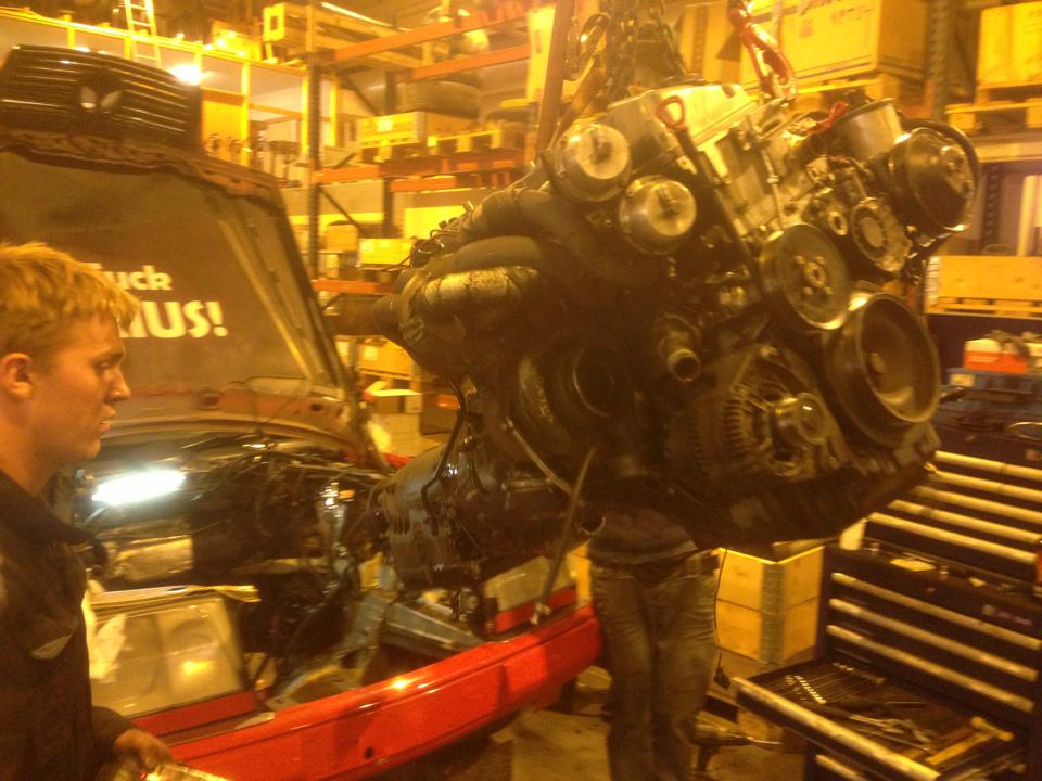

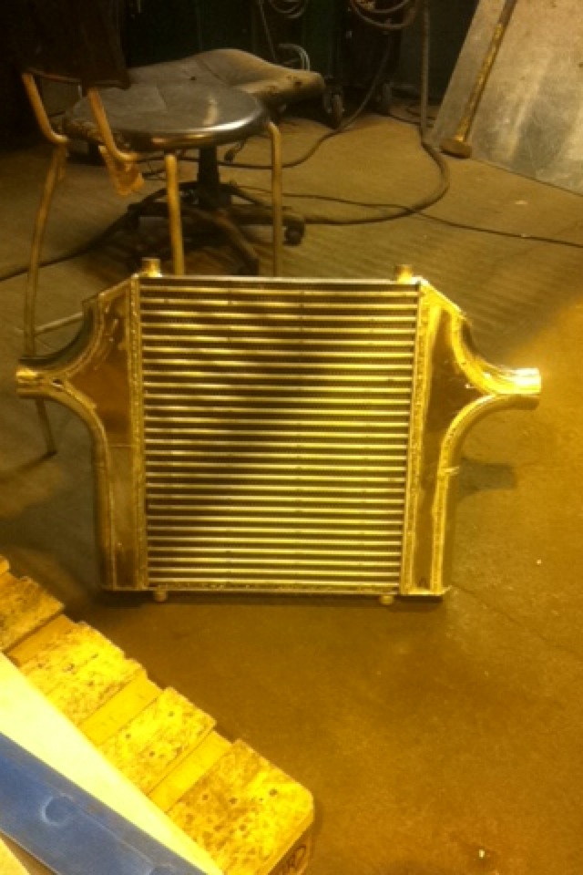

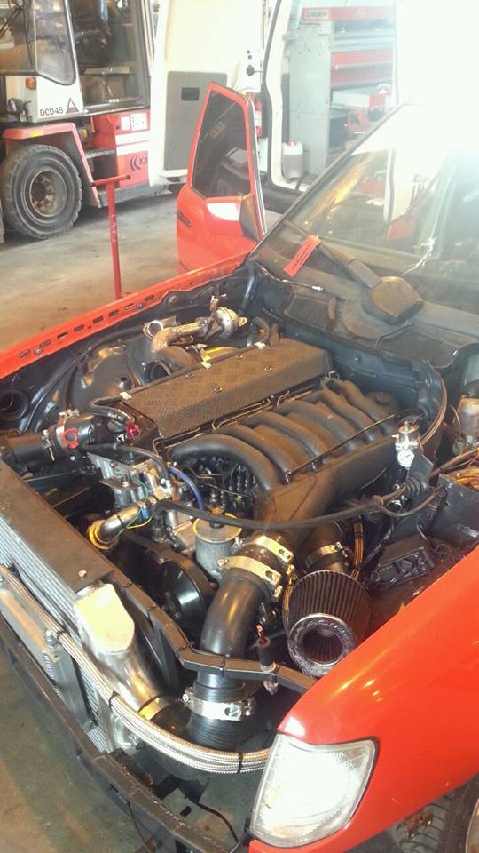

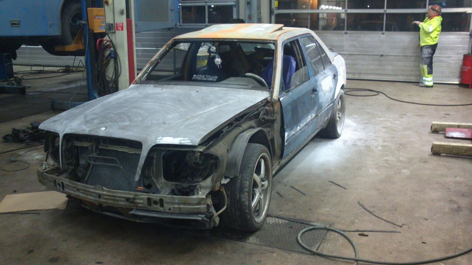

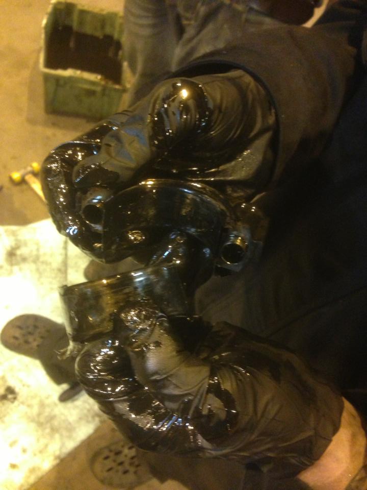

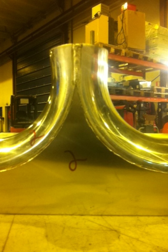

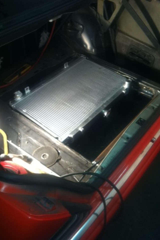

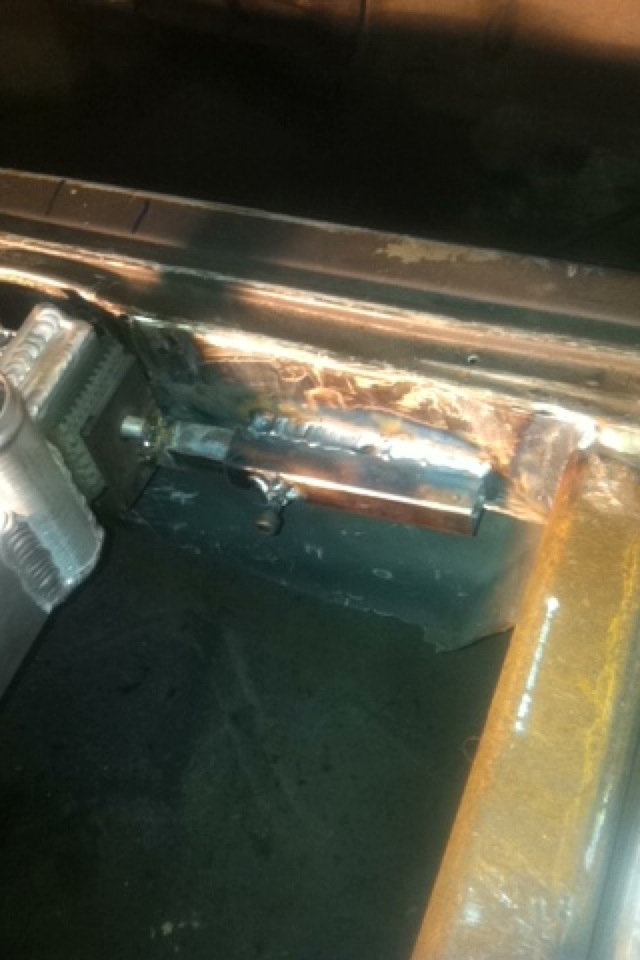

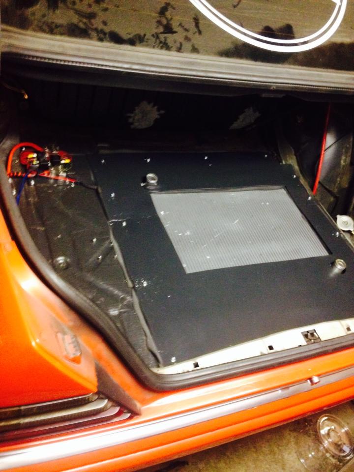

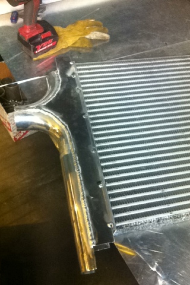

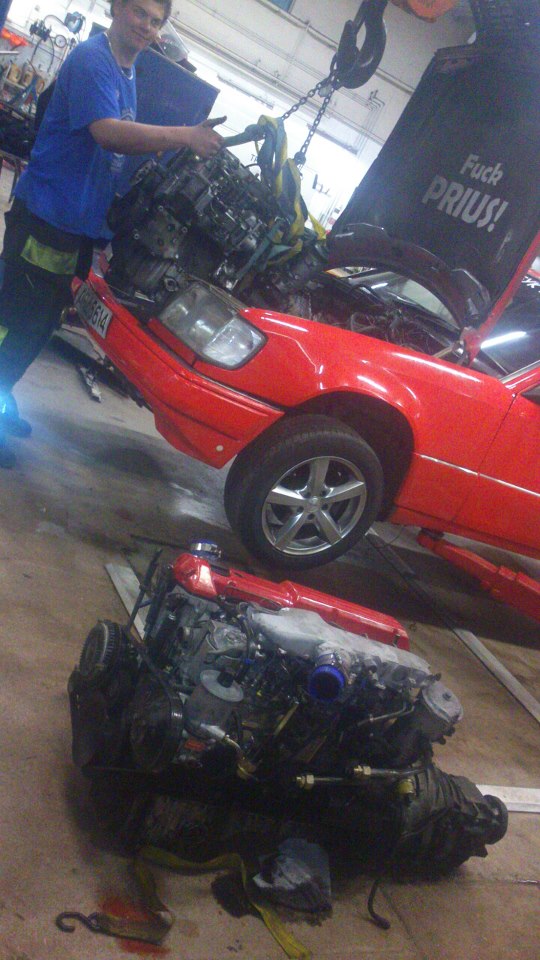

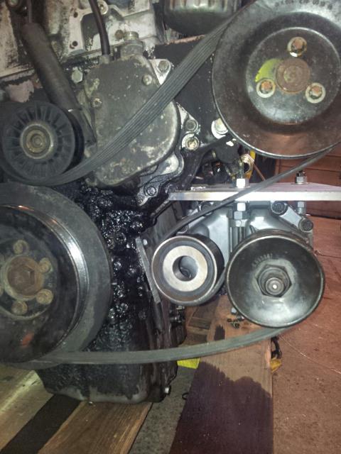

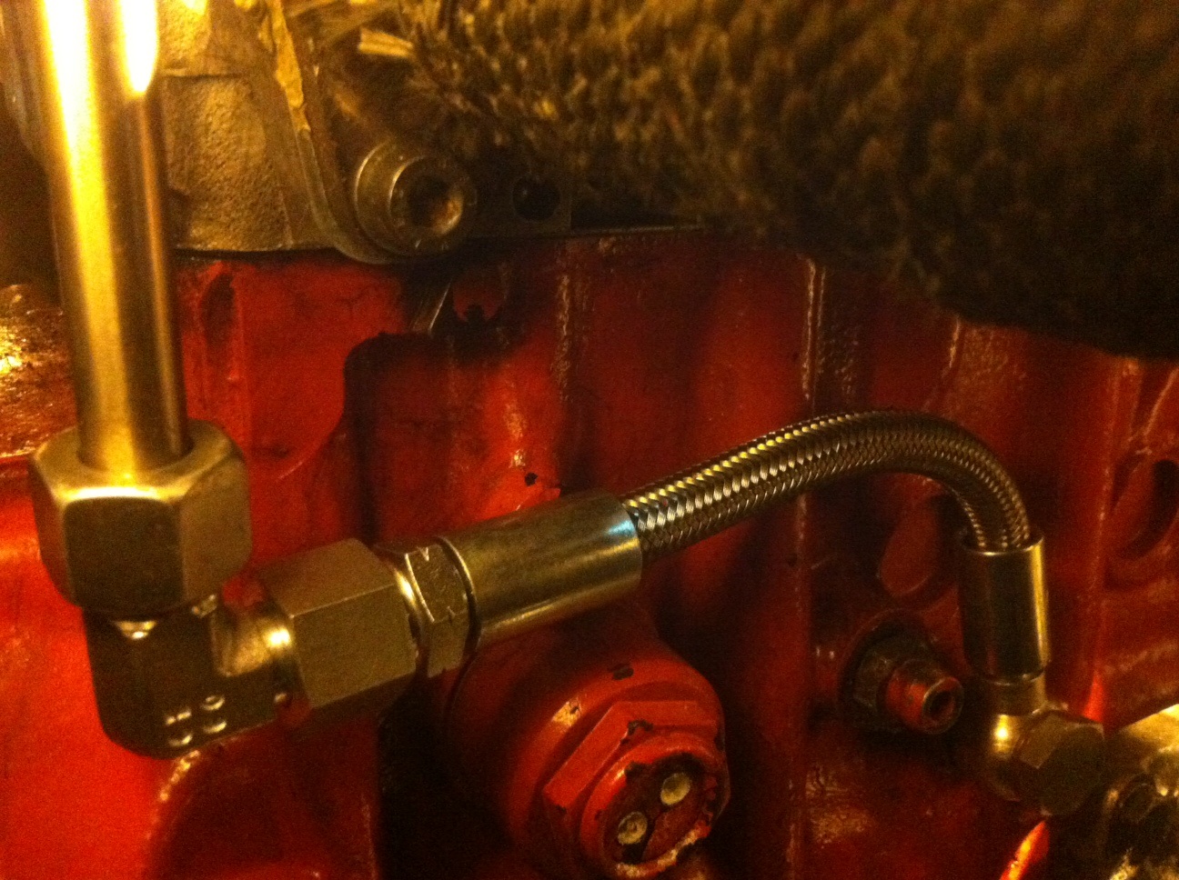

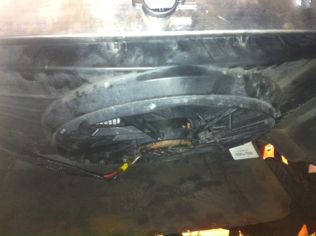

Coal smoke performance. - Paoli93 - 03-07-2014 124w drift car with om606, hx52 and eton m90. ![]() ![]() RE: Coal smoke performance. - CRD4x4 - 03-07-2014 Looking good. I like your intake manifold and intercooler set up. Got any more pics of the exhaust manifold? What are the IP specs? RE: Coal smoke performance. - EDH_Performance - 03-07-2014 (03-07-2014, 08:56 AM)CRD4x4 Looking good. I like your intake manifold and intercooler set up. The first manifold was my old long runner manifold, secound manifold for the hx52 is also made by me ![]() He is running my old 210cc 7.5mm pump ![]() RE: Coal smoke performance. - Sotvisp - 03-08-2014 Always fun with new projects Keep on Rocking!! RE: Coal smoke performance. - Alcaid - 03-08-2014 Looking forward to seeing this mean machine in the dyno soon ![]() Petter RE: Coal smoke performance. - winmutt - 03-10-2014 I like what you did with the intercooler as well. Can we have more pics of the weld job there? RE: Coal smoke performance. - MFSuper90 - 03-10-2014 Pretty sweet work! Good job, keep the progress going! RE: Coal smoke performance. - Paoli93 - 03-10-2014 (03-10-2014, 07:46 AM)winmutt I like what you did with the intercooler as well. Can we have more pics of the weld job there? Thanks ![]() After a few hours of work I've come a bit further. Tihi ![]() Here I have some pictures: D but Where is my radiator? yep, in the wheel well ![]() One question, anyone have try this pump ? http://www.ebay.com/itm/DAVIES-CRAIG-ELECTRIC-WATER-PUMP-ALLOY-EWP-DIGITAL-CONTROLLER-EWP115-DC-8050-/200661743473?pt=AU_Car_Parts_Accessories&hash=item2eb85f3771 RE: Coal smoke performance. - Paoli93 - 03-13-2014 One question, anyone have try this pump ? http://www.ebay.com/itm/DAVIES-CRAIG-ELE...2eb85f3771 RE: Coal smoke performance. - Hario' - 03-14-2014 Yes Davies Craig are high quality (US?) electric water pumps. RE: Coal smoke performance. - Paoli93 - 03-18-2014 Air intake to eton m 90, home made pulleys and the oil pipes to turbo. ![]() ![]() ![]() ![]() ![]() ![]() ![]() ![]() ![]() ![]() ![]() ![]() ![]() ![]() ![]() ![]() ![]() ![]() ![]() ![]() ![]() ![]() RE: Coal smoke performance. - Paoli93 - 03-20-2014 I have upgraded to Volvo v70 fan on the radiator, connected to wires and relays at 80Amp and 30amp to the water pump ![]() ![]() ![]() RE: Coal smoke performance. - erling66 - 03-20-2014 Thank you for sharing your project ![]() ![]() RE: Coal smoke performance. - Paoli93 - 07-03-2014 Hi, im back.. the car has been tested, looks good now. ![]() Hi, im back.. the car has been tested, looks good now. ![]() So, what did you think? ![]() LOL my girbox is empty 5. Exchange 3,67 now is 3,27 RE: Coal smoke performance. - sorin_cel - 07-03-2014 nice job! monster build! what size is your exhaust housing on the that turbo? RE: Coal smoke performance. - Paoli93 - 07-05-2014 Thanks, I have 16 exhaust house. ![]() ![]() ![]() RE: Coal smoke performance. - Alcaid - 07-06-2014 (07-05-2014, 03:17 PM)Paoli93 Thanks, I have 16 exhaust house. 250cc is enough fuel to keep up with a HX60 on an OM606 so no lack of fuel yet ![]() RE: Coal smoke performance. - Paoli93 - 07-06-2014 tihi. I talked to dieselmeken he said Max 220 cc of standartds om606 because the chamber is too small. 180cc and 3,2bar =598hk so petter, do you think hx52 is to small ? and have you comp map on eton m90? maybe i can change to holset 221 turbo? ![]() RE: Coal smoke performance. - Alcaid - 07-06-2014 (07-06-2014, 10:12 AM)Paoli93 tihi. I talked to dieselmeken he said Max 220 cc of standartds om606 because the chamber is too small. 180cc and 3,2bar =598hk HX52 on OM606 should be capable of 550+bhp so depending on how much you want out of it ![]() RE: Coal smoke performance. - Paoli93 - 09-12-2014 ![]() I found out that the car was very soft behind ![]() ![]() ![]() ![]() ![]() ![]() RE: Coal smoke performance. - raysorenson - 09-13-2014 Whoa. That's a great rear suspension mod. RE: Coal smoke performance. - S.Engen - 09-21-2014 (09-12-2014, 04:55 PM)Paoli93 I don't think coilvers will fix the problem.. Upgrade your swaybars, your car have some realy bad bodyroll. Stock w124 swaybar are sloppy ![]() Check : lakeside race parts) on ebay they have some nice/cheap parts to slam your rearend to the ground. Btw nice car ![]() |
