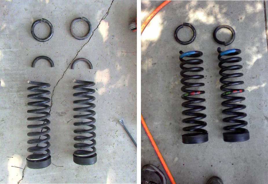

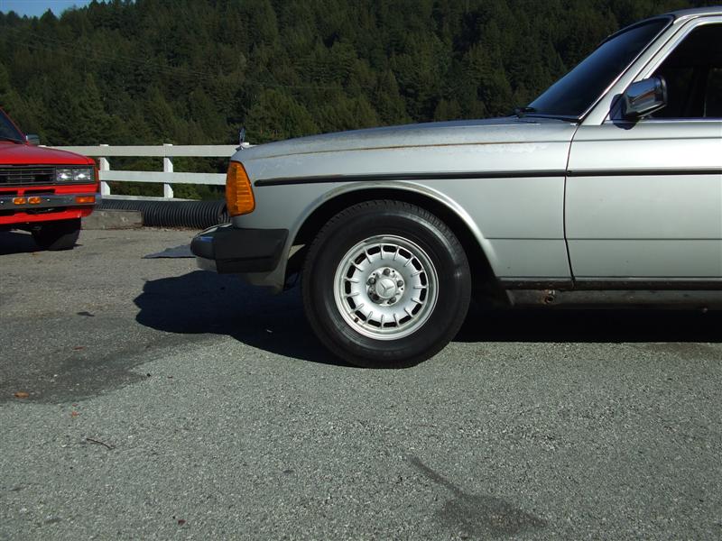

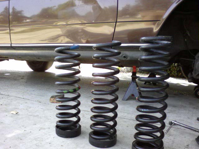

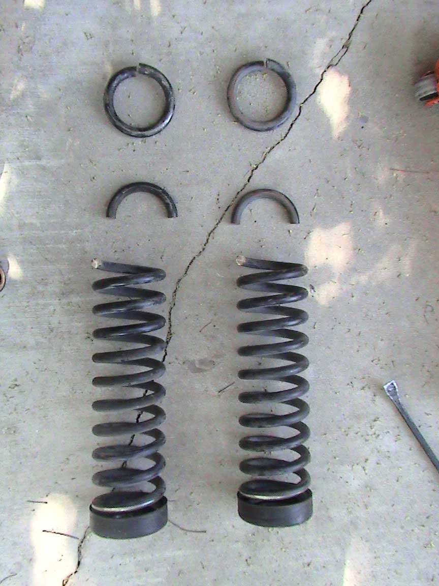

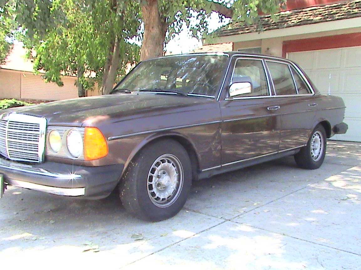

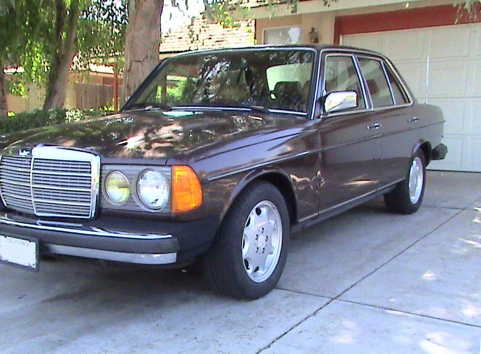

Request for pictures of your lowered w123 - DeliveryValve - 07-31-2009 Couple days ago I decided to cut my front springs. The rear of the car is kind of low already so I decided to kind of even things up. But I think I took too much off. I chopped out 1.5 coils. With 205 70 R14 tires, the top of the tire is about a "visual" 1/2 inch below the fender opening/lip. I think it is kind of low for me... But before I get another set of springs to cut or possibly use the 240D/280E springs, who else has lowered their cars and do you have pictures of it along with the specs of the springs you used? Thanks.. But I probably will end up keeping it the way it is.... . RE: Request for pictures of your lowered w123 - winmutt - 07-31-2009 Your tires are to small thats all. RE: Request for pictures of your lowered w123 - holmz88 - 07-31-2009 What size tires do you recommend?? What's the largest tire that will fit?? RE: Request for pictures of your lowered w123 - DeliveryValve - 07-31-2009 (07-31-2009, 05:22 PM)winmutt Your tires are to small thats all.... What? It's bigger then the stock size. 24.7 inch circumference for the stock 195 70 R14 vs 25.3 for the 205 70 R14. These are balloon tires! Anyways I am looking to get some 15s or 16s a bit later. What size are you running? RE: Request for pictures of your lowered w123 - SurfRodder - 08-01-2009 I run 225/50 16" on mine, the front looks pretty much like yours... I was worried about clearance at first, but after turning it lock to lock, there was plenty of clearance all the way around, so I am not too worried about it. I know plenty of others have had good luck running 215/55 16" though, so if you're worried about clearance at all, that might be the better way to go. on second look at your pic, I really like the way that thing is sitting, mine is still way too low in the rear and I will be following Greasy's SLS removal thread w/great interest...If I can get it to ride that much higher, I could leave my heavy ass toolbox in the trunk and have no issues. RE: Request for pictures of your lowered w123 - GileadGarage - 08-24-2009 My TD after 1 coil from front, 215/50/16's, 5 MM spacers o I could use my stock lugs. Next time I'd prbably go w/55's or the 225/50's since there is plenty of room around the 215/60's I have no nubs on my front shims, I guess these are the lowest avail. Car rides nice, but not as squishy as the 240 on the rough stuff ![]() <a href="http://s156.photobucket.com/albums/t13/markp-svoimages/?action=view¤t=010.jpg" target="_blank"><img src="http://i156.photobucket.com/albums/t13/markp-svoimages/010.jpg" border="0" alt="Photobucket"></a> RE: Request for pictures of your lowered w123 - DeliveryValve - 10-02-2009 Here is an update. I decided of going with 1 coil lopped off. 1 1/2 coil cut makes the car a bit too low for my taste. I tried to keep it there, but in the end it bothered me too much. The first pic is the car in stock configuration - Notice fender to wheel gap. Second pic is with 1 1/2 coils cut from the front springs - Thought it was too low. Third pic is 1 coil cut from the front spring in addition with different wheels. (I didn't take a good pic with the original bunts) Fourth pic are the spring cuts. First round 1 1/2 coils cut, Second round 1 coil cut. (I gave 1 1/2 coil cut springs to 606Power. Hopefully he'll post up pics of his ride with them.) Fifth pic are the two cut springs compared to the stock. I have the 1 nub stock pads on my springs (see pics 6-8) RE: Request for pictures of your lowered w123 - SurfRodder - 10-04-2009 looks good man! RE: Request for pictures of your lowered w123 - charmalu - 10-16-2009 I hope this attachment works. Ok I installed 240D front springs with the one nub pads the 300D had. since I did the 4-speed swap the nose was riding way too high. made the front end wander at higher speeds, especially with 4 people. with the front end high it threw out the geometry of the syspention. Charlie think I have theis picture posting worked out. Here are the rest. The 240 springs dropped the front down 1 1/2 inches from where it was. the ride is a little softer now, and in a tight left turn, (50 mph) on a mountain road, the right corner drops more than it use to, and vice versa. over all it handles ok. I just pulled a TD front sway bar that is going in next. Charlie RE: Request for pictures of your lowered w123 - charmalu - 10-17-2009 The one nub is the 300D, 3 nub 240D. The longer spring on the right is the 240. Charlie RE: Request for pictures of your lowered w123 - DeliveryValve - 10-17-2009 Looks good Charlie, the 240 springs did the trick. What size tires are you running? . RE: Request for pictures of your lowered w123 - charmalu - 10-17-2009 (10-17-2009, 03:42 AM)DeliveryValve Looks good Charlie, the 240 springs did the trick. What size tires are you running? There 205-70-14 Legacy from Big-O. this is the second set of them. last set I replaced 2 @ 73,xxx miles and one @ 75,xxx miles. Had one replaced from a piece of metal I ran over. Charlie RE: Request for pictures of your lowered w123 - charmalu - 10-20-2009 This thread is "Verdict Cutting Springs" and a few mor pictures of the car and what he did to the radical drop. www.peachparts.com/shopforum/showthread.php?t=222645 Charlie RE: Request for pictures of your lowered w123 - winmutt - 03-17-2011 Just remember, too much drop == not enough travel == shitty DD. RE: Request for pictures of your lowered w123 - Captain America - 03-17-2011 I would disagree, Especially when you look at a trophy truck! ![]() RE: Request for pictures of your lowered w123 - dieselboy - 03-17-2011 I think he's saying by going to low you will loose your uptravel and it will ride like crap because it will hit the bumpstops all the time. I really like how my setup is. I'll make it up your way one day and take you for a ride. RE: Request for pictures of your lowered w123 - DeliveryValve - 03-17-2011 (03-17-2011, 03:50 PM)dieselboy I think he's saying by going to low you will loose your uptravel and it will ride like crap because it will hit the bumpstops all the time. db where's your pictures. w116s and others are allowed! ![]() . RE: Request for pictures of your lowered w123 - winmutt - 03-17-2011 (03-17-2011, 03:50 PM)dieselboy I think he's saying by going to low you will loose your uptravel and it will ride like crap because it will hit the bumpstops all the time. This. RE: Request for pictures of your lowered w123 - dieselboy - 03-17-2011 ill take some more tomorrow. Im driving 350miles to San Louis Obispo so ill clean it all up and take some. old pics ![]() ![]() ![]() to low at first lol ![]() RE: Request for pictures of your lowered w123 - Captain America - 03-17-2011 Air bump or progressive bumpstops! Not the best shot, But I cut 2 coils and it rides/handles fantastic RE: Request for pictures of your lowered w123 - garage - 03-24-2011 (03-17-2011, 09:50 PM)Captain America Air bump or progressive bumpstops! Thats what im talkin bout, air bumps on these cars would make the ride AMAZING RE: Request for pictures of your lowered w123 - tantank79 - 03-30-2011 RE: Request for pictures of your lowered w123 - winmutt - 03-30-2011 Speaking of riding on bumps ^^^^^ RE: Request for pictures of your lowered w123 - garage - 03-30-2011 (03-30-2011, 08:38 AM)tantank79 That picture kicks ass ![]() Can we have more??? Do you autocross often? RE: Request for pictures of your lowered w123 - tantank79 - 03-30-2011 (03-30-2011, 11:04 AM)winmutt Speaking of riding on bumps ^^^^^ It's veeerry close but not continously on the bumps there. More? Certainly! The whole set can be found here: https://picasaweb.google.com/dennis.wittekind/Autox3s11# I've autocrossed this car about 10 times over the past two years. It can perform suprisingly well. RE: Request for pictures of your lowered w123 - Lowdown89 - 05-04-2011 Diesel boy, in that bottom picture how many coils are cut? I'm looking to get my 300d as low as possible with just cutting the springs, and I really like the way yours looks.... RE: Request for pictures of your lowered w123 - Joe Reitman - 06-04-2011 1.5 coils cut in front, photo in signature RE: Request for pictures of your lowered w123 - RonB - 06-11-2011 ![]() ![]() RE: Request for pictures of your lowered w123 - Captain America - 06-15-2011 WOW. That wagon is BEAUTIFUL! RE: Request for pictures of your lowered w123 - DeliveryValve - 06-15-2011 (06-15-2011, 12:38 AM)Captain America WOW. That wagon is BEAUTIFUL! ^^^ Indeed a Beautiful car! . RE: Request for pictures of your lowered w123 - dieselboy - 06-16-2011 Where did they get the smooth grill? RE: Request for pictures of your lowered w123 - RonB - 06-16-2011 [quote='dieselboy Where did they get the smooth grill? [/quote] I have seen a few of these In germany,they weld up the star mount hole and rechrome the shell. here is a Brabus W123 ![]() RE: Request for pictures of your lowered w123 - randomdude - 08-02-2011 RonB, where did you get the body kit on the first 4dr? not the brabus, the one in your first post. RE: Request for pictures of your lowered w123 - Oil Burner - 08-02-2011 (08-02-2011, 02:02 PM)randomdude RonB, where did you get the body kit on the first 4dr? not the brabus, the one in your first post. I want to know also... Do they make it for the CD RE: Request for pictures of your lowered w123 - winmutt - 08-02-2011 I doubt thats his. RE: Request for pictures of your lowered w123 - randomdude - 08-03-2011 does anyone know where to get a mild kit close to that? RE: Request for pictures of your lowered w123 - winmutt - 08-08-2011 There is a guy in the Philippines who sells AMG copies. No matter what your talking ~$400-600 shipped. |
