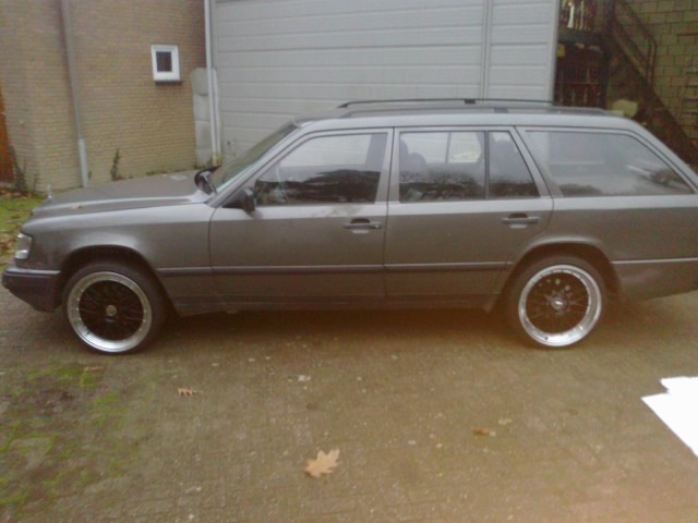

RE: w124 om606 new project in holland - Sjevsspeed.nl - 11-18-2014
Testfitting some 19" wheels. no problem. going on

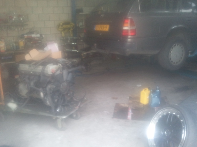

RE: w124 om606 new project in holland - Sjevsspeed.nl - 11-19-2014
Today stripped half of the w210. had to help some clients in between. tomorow gonna pull engine and trans out and start stripping the w124 gonna get new gaskets and oil and.waterpump for the om606 before i put it in the w124
RE: w124 om606 new project in holland - Sjevsspeed.nl - 11-22-2014
Done stripping the w210. monday gonna put new pumps on. maybe switch sumps and see what can be used from the om603. gonna try to keep ac compressor of om603 and see wich steering pump wil work best

RE: w124 om606 new project in holland - Tito - 11-26-2014
I like those wheels! Car needs some serious lowering though. Big Grin
RE: w124 om606 new project in holland - Sjevsspeed.nl - 11-26-2014
Yup.it wil get some serious lowering and cool paintjob

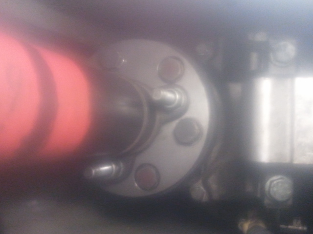

RE: w124 om606 new project in holland - Sjevsspeed.nl - 12-13-2014

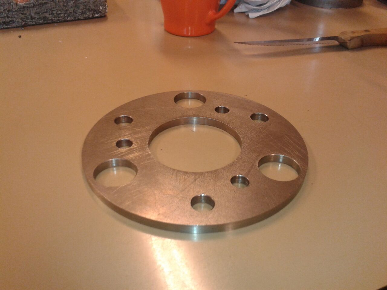

Got new timing chain and waterpump. had adapter plate made for the hardydisc from 6mm thick steel to use the old driveshaft for now. i can suply more if anyone needs one
RE: w124 om606 new project in holland - Sjevsspeed.nl - 12-15-2014
Perfect fit

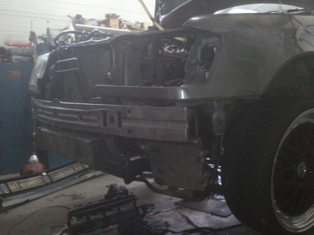

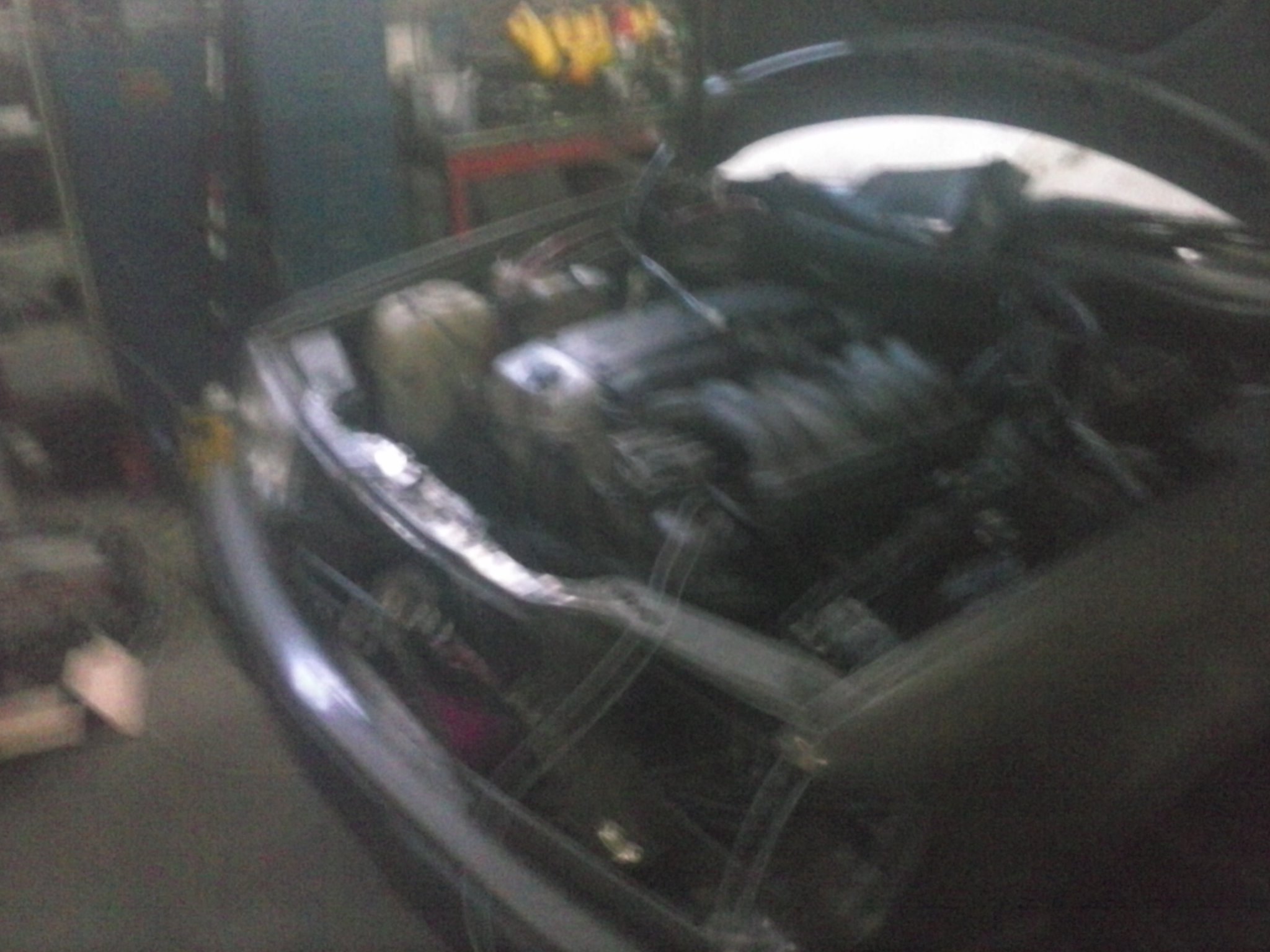

RE: w124 om606 new project in holland - Sjevsspeed.nl - 01-01-2015
almost done. making room for al the coolers .

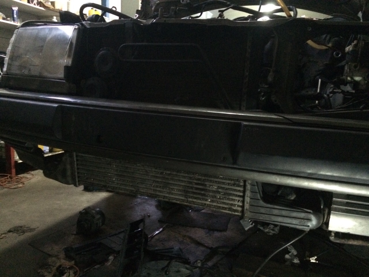

RE: w124 om606 new project in holland - Sjevsspeed.nl - 01-02-2015
Intercooler.placement
RE: w124 om606 new project in holland - Sjevsspeed.nl - 02-04-2015
done , some pics

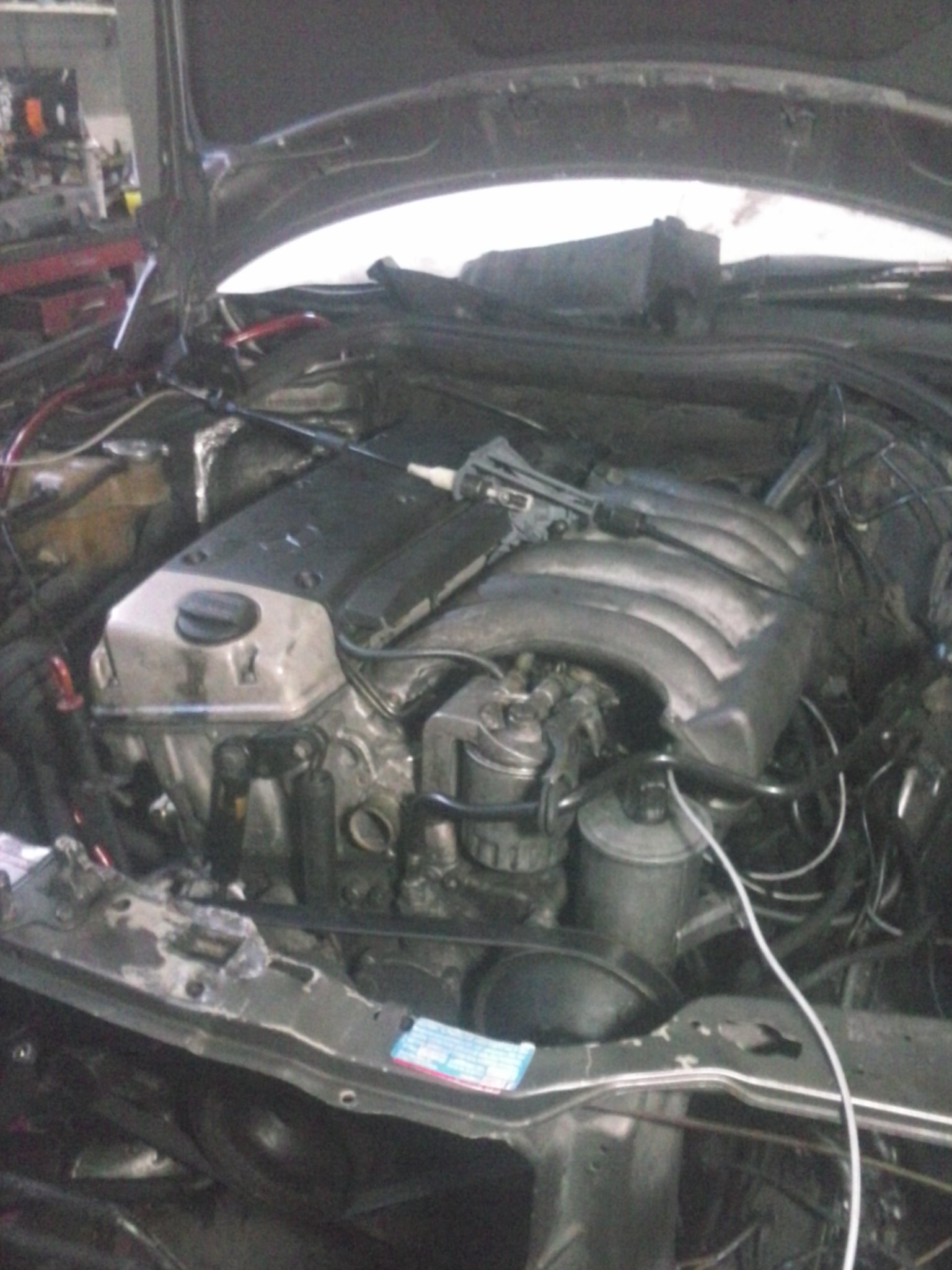

RE: w124 om606 new project in holland - Sjevsspeed.nl - 02-18-2015
Bad news . bit of a delay on the project. it was a running car. but engine seized whyle idling. need to pull engine out and appart. probably not too much damage but a big delay in time and have to research. the cause of the seize
i pulled the engine from a running e300 w210 put new timing chain on. and it startes on om603 pump
it had a knock wich seemed too be comming from the head. sounded like a stuck lifter a bit.
I had the pump set at 16 deg atdc .
ive set the pump to around 12 atdc and then adjusted idle. first 15 seconds the knok was gone but then returned. i let the enginevidle a bit but qhitin a minute it shut ofvand crank was stuck.
im going to do a lot of headflow and valvespring work. so i need to research why this happaned so it wont happen again with the rebuild engine

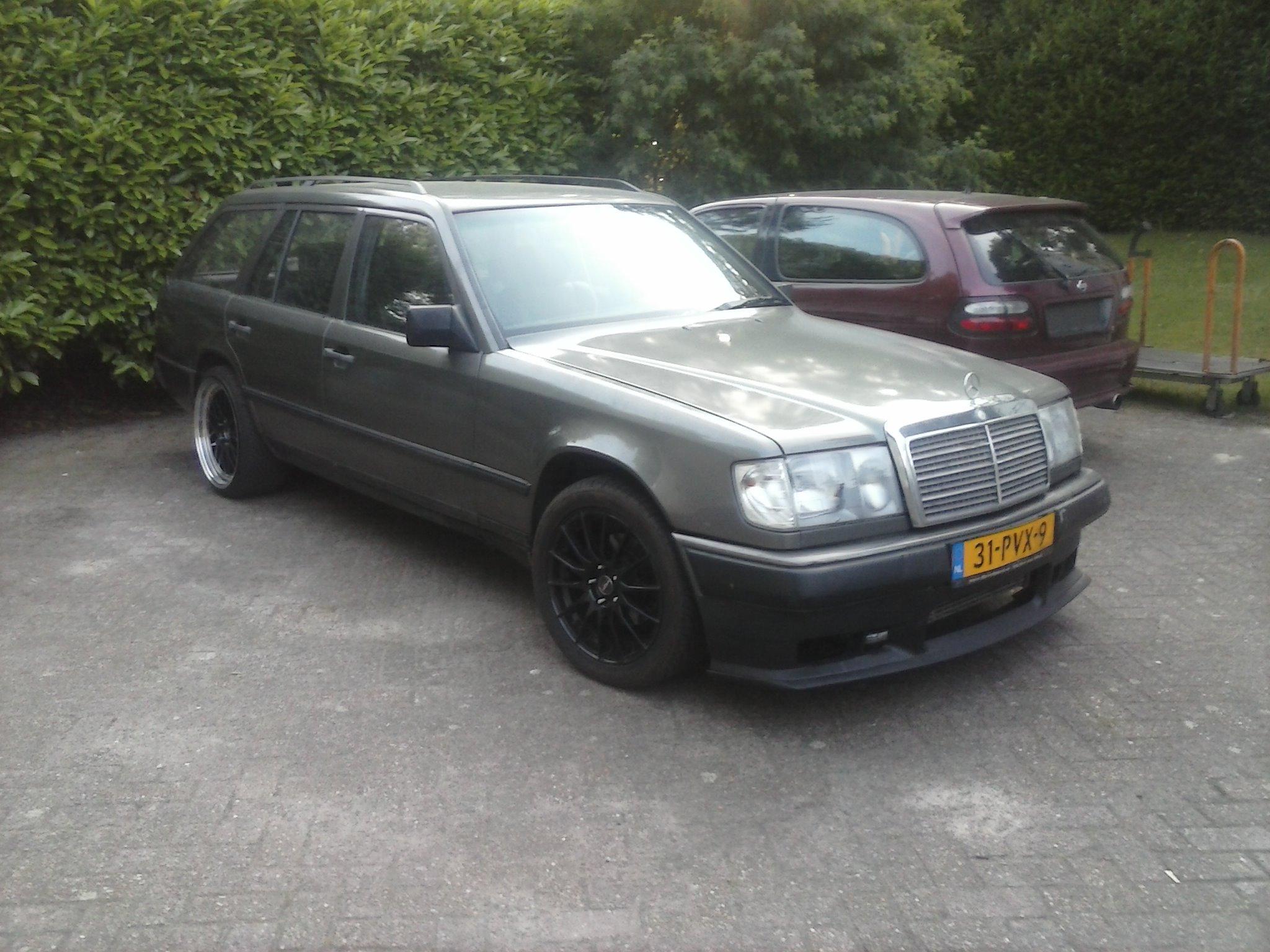

RE: w124 om606 new project in holland - Sjevsspeed.nl - 09-28-2015
finaly some progres, had some bad luck with donor engines and authoraties but everything is fine now and registered, time for dieselmeken ip, and k31 turbo
