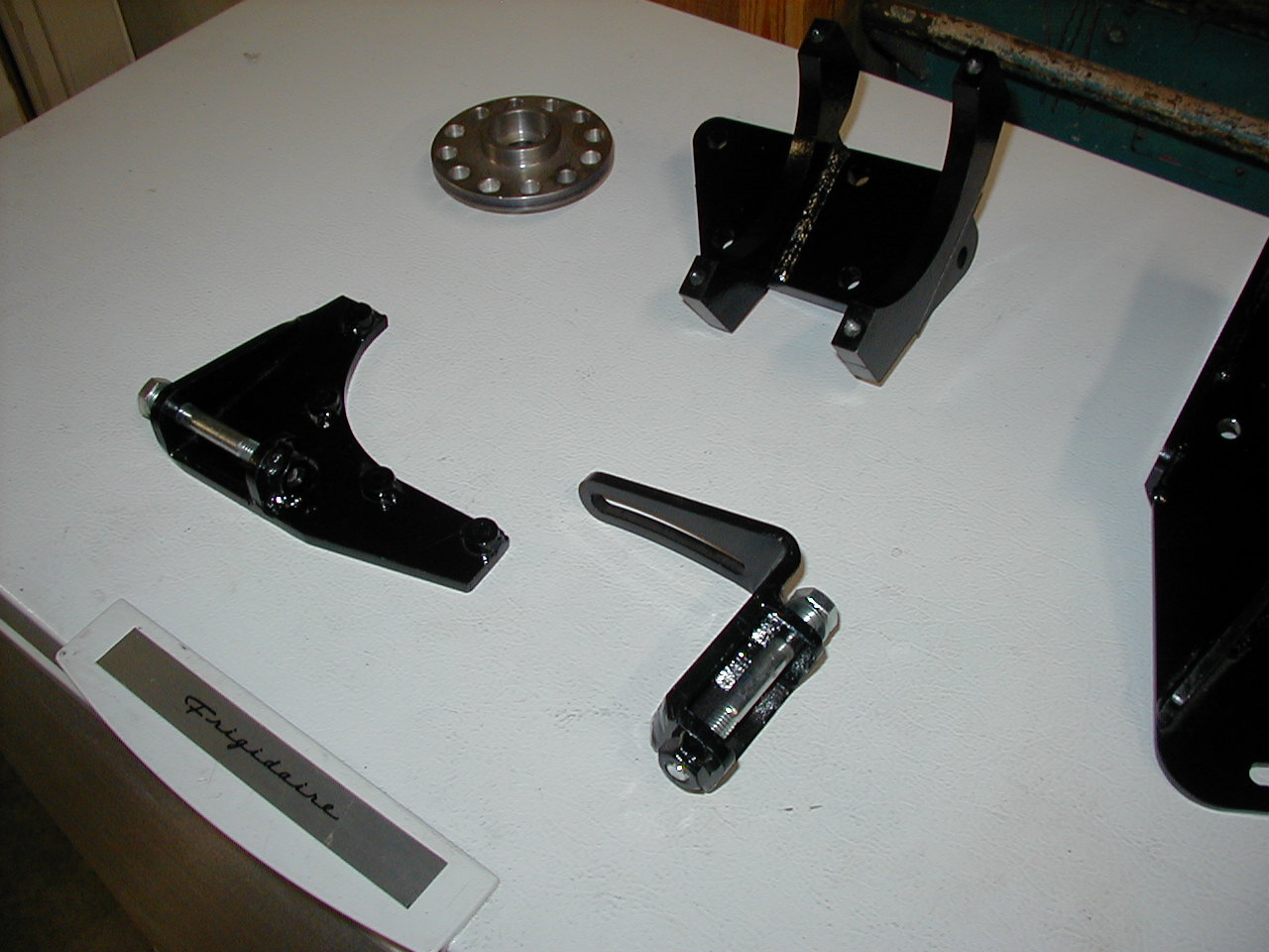

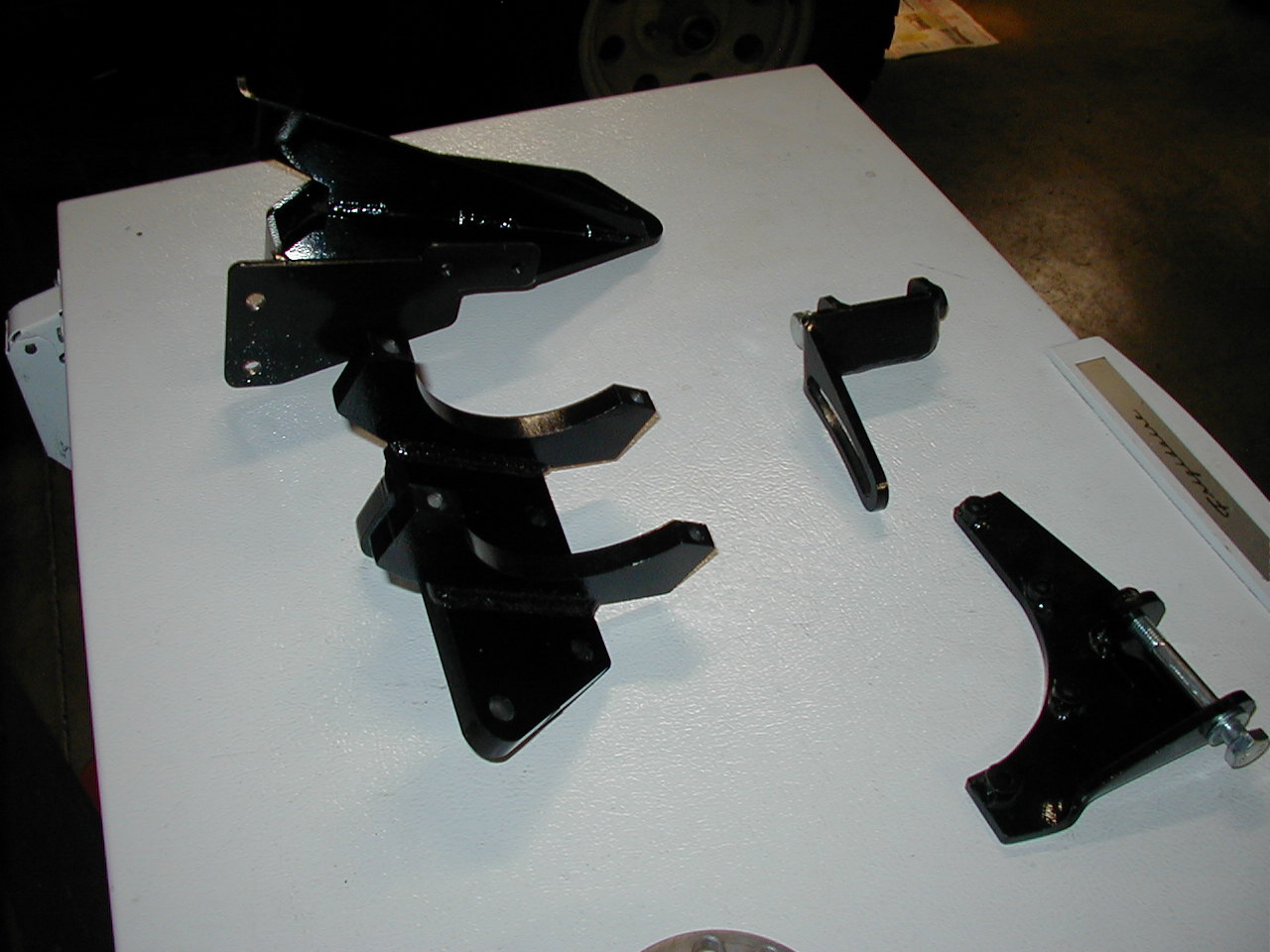

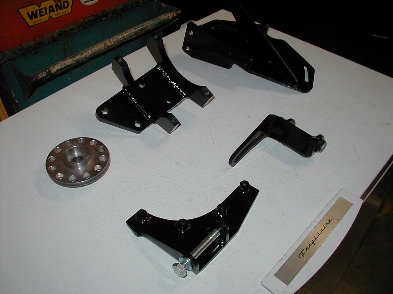

TD Swaps Toyota truck Om 617 conversion brackets and flywheel adapter.
Power steering pump mount that moves the pump back and inch for radiator clearance. A matching bracket that moves a GM alternator to the drivers side and a A/C bracket for the passenger side that uses the Toyota A/C compressor.

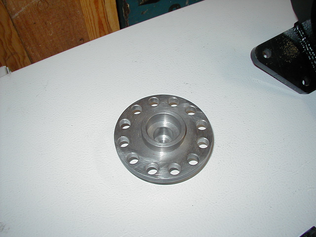

Also a flywheel adapter to adapter to adapt the Toyota flywheel to the Om 617 crankshaft.
$150.00 for all plus shipping. PM me or call or text 208-683-0465 Ask for Ron.

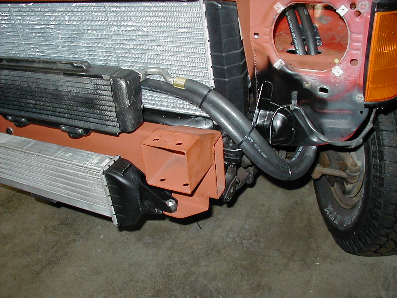

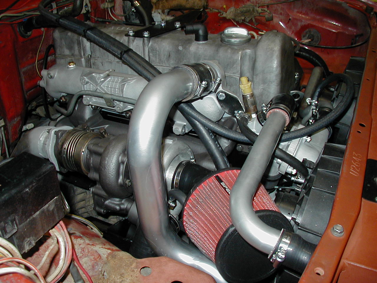

The adapter plate is 1/2" thick, it uses the Toyota flywheel and starter in the stock location. I used a 2kw Tacoma cold weather starter which I adapted for the added torque for the diesel and a turbo 22r flywheel for a bigger clutch which I got from Marvin Crawler.
I ended up using a different radiator so I didn't use the brackets I had purchased and just used the adapter plate. I had an extra flywheel adapter made for a pattern.
All this was bought from TD Swaps in Portland Oregon. Enclosed are some pics of the Toyota truck I am finishing with an added intercooler.
