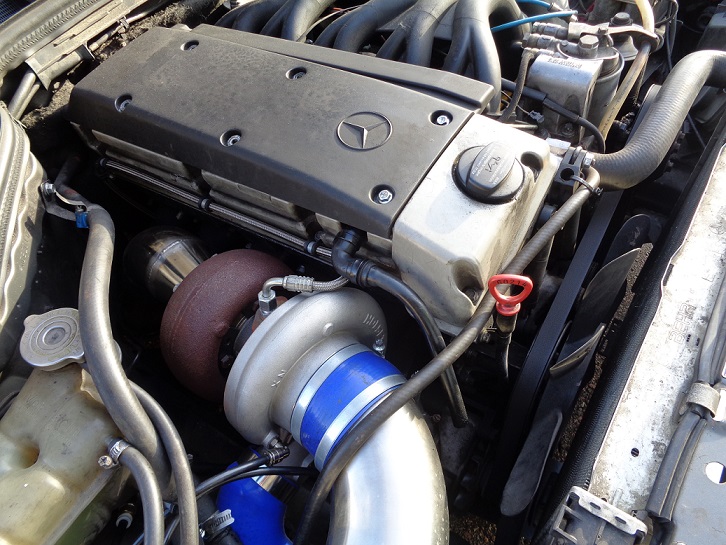

W201 Om605 Build - Kuisma - 02-08-2015 Hello everyone! My name is Joonas and im from Finland. Heres my w201 190D Sportline ST project. The car was originally with n/a om602+5v manual+open diff. Nowdays it has Om605 Tbo engine and Bmw 5v ZF gearbox+ 2.87 ASD diff from w124 4matic. Heres some pics off the car, ill add more pics/info on next post. ![]() ![]() ![]() RE: W201 Om605 Build - Kuisma - 02-08-2015 New 8mm mynä IP ![]() ![]() 5v bwm ZF welding done and ready to go ![]() New turbo: Holset hx40 super with billet comp wheel. ![]() ![]() Awesome tic welded exhaust manifold, made by Pt_Racing (Pyry Takkunen from Finland) ![]() VHT black Flame Proof coating ![]() ![]() ![]() Old pics from last summer, i will update better pics later. Engine specs: Stock om605 turbo, new bearings, piston rings, gaskets etc. Stock intake manifold atm, i will make new from Om606 manifold with AMW wrc plenum. Heres my old om606 with same kind of manifold: ![]() Brake update. New discs: ![]() ![]() Calibers sand blowed+coated with VHT brake caliber paint. Time to bake: ![]() Ready ![]() Dyno session from last week. Original lift pump stopped to flow on higher rpms so the power didnt grow up from 4800rpm. Next time i will make new 10mm fuel lines and install Holley 150gph eletric pump. ![]() https://www.facebook.com/video.php?v=10202338936274552&l=7213345651663594892 460hp 670nm pull. RE: W201 Om605 Build - bmartins - 02-08-2015 How....nice W201.....keep the job.... RE: W201 Om605 Build - Max - 02-08-2015 Great Build !!! And impressive Dyno Results ![]() Greets Max RE: W201 Om605 Build - Kuisma - 02-08-2015 Thanks! ![]() RE: W201 Om605 Build - USMCRAIDER - 10-17-2017 Very nice! How did you get rpm, and spedometer to work with bmw zf? |
