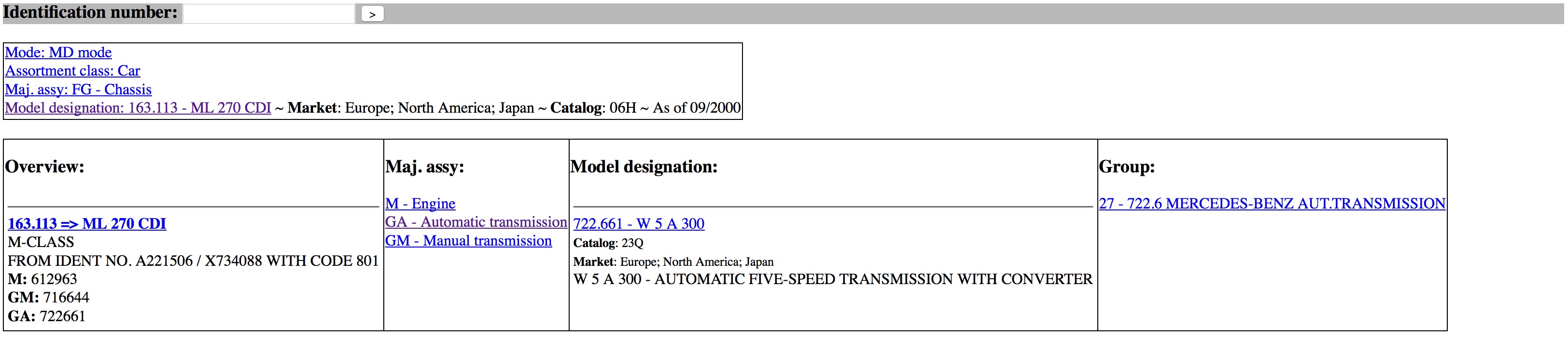

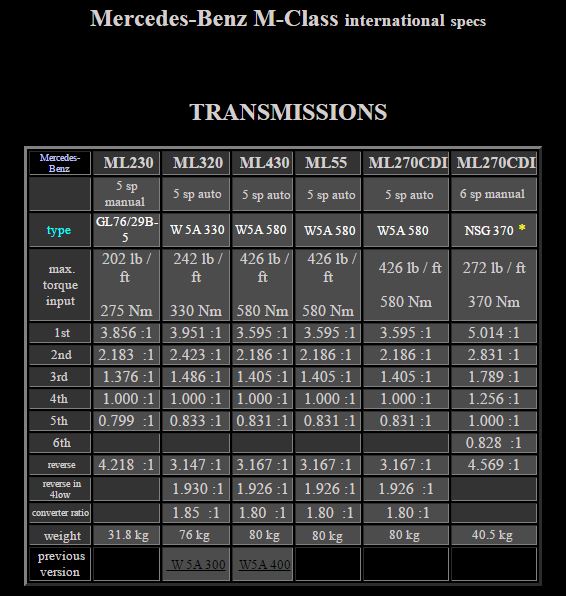

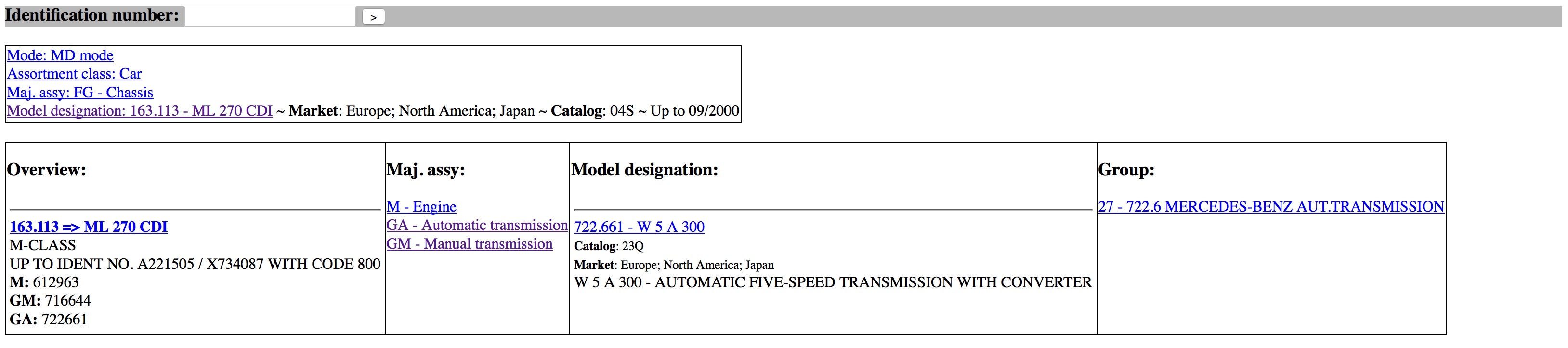

ML 722.6 - fire-host - 07-28-2015 Hi Guys. I have a few questions in regards to 722's, mainly from the ML series. I dont as of yet have the Merc EPC yet, so can't check things out. 1) Does the ML270CDI run the same bolt pattern as the OM606? Ole has said that it should do, but just wondered if anyone can confirm. Not questioning Ole, but whilst he was fairly certain, he wasn't 100%. So thought it worth the question ![]() 2) There's a few places that list the ML270CDI Auto using the W5A580. Is this the case? There's also a few forums where people say it's the 300. So I'm not 100% sure. Can anyone help here to? Many Thanks! RE: ML 722.6 - erx - 07-28-2015 If the engine makes 400nm then gearbox can't be rated under that, w5a580 should be right. E270CDI also has w5a580 box. Bolt pattern is the same as om606 but 320cdi has different pattern. RE: ML 722.6 - fire-host - 07-29-2015 Yeah, as you said, the engine does sit somewhere around the 400NM mark. However, some still insist it runs a 300 box according to the EPC. But to me, that doesn't seem very Mercedes ... to under spec a gearbox! I have however just found this which is contradictory too: Just cant seem to find a definitive answer. RE: ML 722.6 - fire-host - 07-29-2015 Hmm ... apologies ... There doesn't seem to be any scaling! RE: ML 722.6 - dcm - 08-22-2015 Just to keep everything in one thread; whats the rest of the tranmission, diff, transfer in a ML270 like for taking more power? RE: ML 722.6 - ross - 08-28-2015 I'd also be interested in knowing the version of the ML box. I've just bought an ML270 box with the intention of swapping in the W5A580 internals, but it sounds like I might not need to? RE: ML 722.6 - ross - 08-28-2015 One reason for the lower rating could be down to the reduction of the transferbox gearing in the ML, less resistance means the main box can be lower rated. RE: ML 722.6 - whipplem104 - 08-28-2015 Honestly the torque ratings are pretty mute. THe maximum difference in these transmissions from the weakest to the most powerful cars is 2 maybe 3 clutches in a couple of clutch packs. Which can be changed at will. Buy the best core you can and build to suit. RE: ML 722.6 - ross - 08-28-2015 (08-28-2015, 07:53 AM)whipplem104 Honestly the torque ratings are pretty mute. THe maximum difference in these transmissions from the weakest to the most powerful cars is 2 maybe 3 clutches in a couple of clutch packs. Which can be changed at will. Buy the best core you can and build to suit. The differing ratios will probably also pay a role in the strength change. The slightly taller ratios in 1/2 of the 580 will mean it has less teeth but bigger ones on the gear so they're able to take more abuse. RE: ML 722.6 - whipplem104 - 08-28-2015 It is true that the small nag will have an inherent weakness to a large nag. But honestly I do not think anyone here is going to find the limit of the gear sets. I have run a small nag1 stock transmission that had glycol contamination from a c230 behind 400bl/ft of torque with drag tires and daily driving for years in the past. It was still working fine when I removed it and k3 clutch pack was getting near the end. We run in excess of 900lb/ft of torque to the wheels in large nag versions, so say 1100+ at the motor. With peak flash torque at higher numbers than that. So I would comfortably say that you could run in the neighborhood of at least half that and really probably 2/3 to 3/4 of that through a small nag. Since the input shaft is normally what breaks from peak torque. This is also in 4000+ lb vehicles. RE: ML 722.6 - Turbo - 08-28-2015 in the bigger one it is the luck up that burs up at high torque, but at that time your are running quite fast, even my orginal 320 cdi has great problem not to slip on the lock up mode, some suggestions to come away from slip, I really hate it!!! RE: ML 722.6 - whipplem104 - 08-28-2015 Are you asking about the lock up converter slipping? If so the main determining factor is how much pressure you are running and when you try and lock it up. If you try to lock it up while it is still in stall under high power you will burn it up. Lock it up at high rpms and keep it locked as you shift. RE: ML 722.6 - ross - 08-31-2015 I'm more worried about slip in the box as the TC can be far more easily changed. Strength in my Land Rover is more of a worry with the tyres gaining and loosing traction causing issues. Big tyres eat drivetrain components! |
