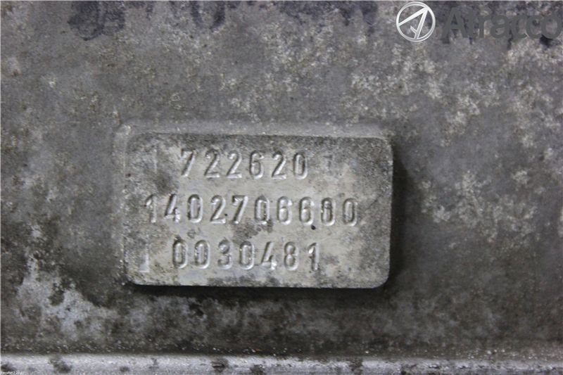

722.620 - Hearns - 09-07-2015 Will this gearbox mate up to my om603 and will it fit into my w124? RE: 722.620 - Tito - 09-07-2015 No. It looks like it's from a petrol engine. RE: 722.620 - erx - 09-07-2015 722.620 is from V8 and it has different bellhousing, if you swap the bellhousing then it will fit. And all .6 boxes are fully electronic so it needs standalone controller to work. |
