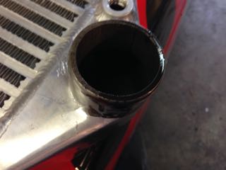

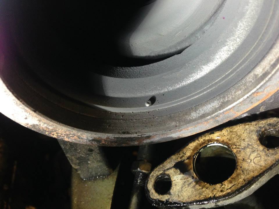

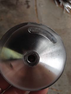

High EGTs kill - Torkey - 09-14-2015 Had a race this weekend and in the process blew a boost hose. The driver noticed on the front straight that the EGT gauge was pegged at 1600 degrees. Took out the turbo. Here are some pictures for those that like looking at failure porn. My space os limited here but there are more pictures on our Facebook page if you want to see all the gory details. RE: High EGTs kill - MFSuper90 - 09-14-2015 On the bright side, you didn't melt a piston ![]() In tractor pulling and many other diesel sports as well (I guess anything boosted) we weld tabs to each pipe and bolt them so they can't escape one another. Most times the boots don't blow, but rather the tubes seperate from the force and cause the boot to blow off. Just my past experience ![]() RE: High EGTs kill - Torkey - 09-14-2015 Fortunately, it was a cheap Ebay turbo. Could have been so much worse if we had a proper name brand turbo. :-) I would hurt to only get 9 hours out of that. RE: High EGTs kill - m1tch - 09-15-2015 Which Ebay turbo was it btw? Just curious due to the other thread about them. RE: High EGTs kill - Torkey - 09-15-2015 It was an F-Diesel brand. I really don't think it was the turbos fault though. Something like this would kill any turbo. RE: High EGTs kill - raysorenson - 09-15-2015 Do you use a worked pump yet? RE: High EGTs kill - Torkey - 09-15-2015 I'm using a stock MW pump that I have turned up. We weren't running that much boost, only 25 lbs. The coupler blew because it had another clamp rubbing against it. RE: High EGTs kill - Torkey - 09-15-2015 Pulled out the turbo cartridge and found an artifact from the meltdown. A small ball of metal the used to be the turbine wheel. RE: High EGTs kill - atypicalguy - 09-16-2015 The solution to high egts is usually more booist afaik. Where were they running before the blowout? |
